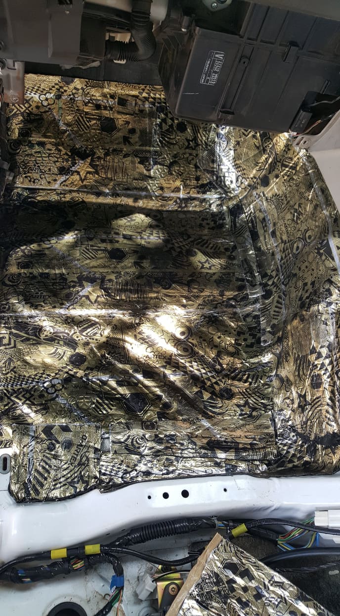

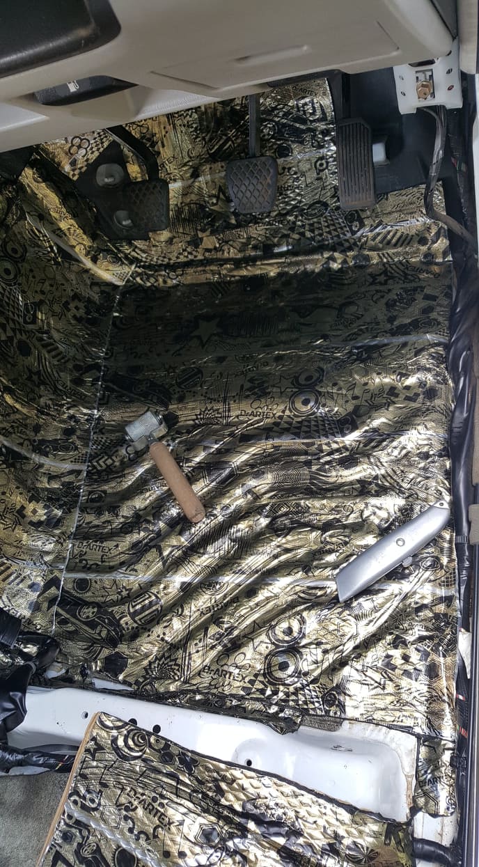

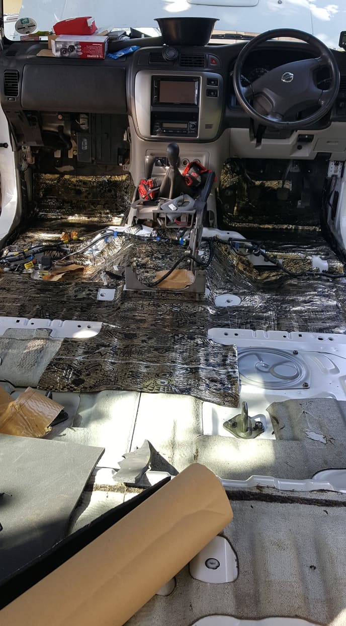

So i've done the front and rear footwells, as well as the rear wheel arches. The vehicle has quite a lot of factory fitted deadening already, much more than previous vehicles i've owned. I have used 14 sheets of the CLD thus far, and still need to do the doors, so I've left a bit of a boot area without CLD. The factory stuff should be fine here, as i'll be adding the 8mm closed cell foam anyway.
