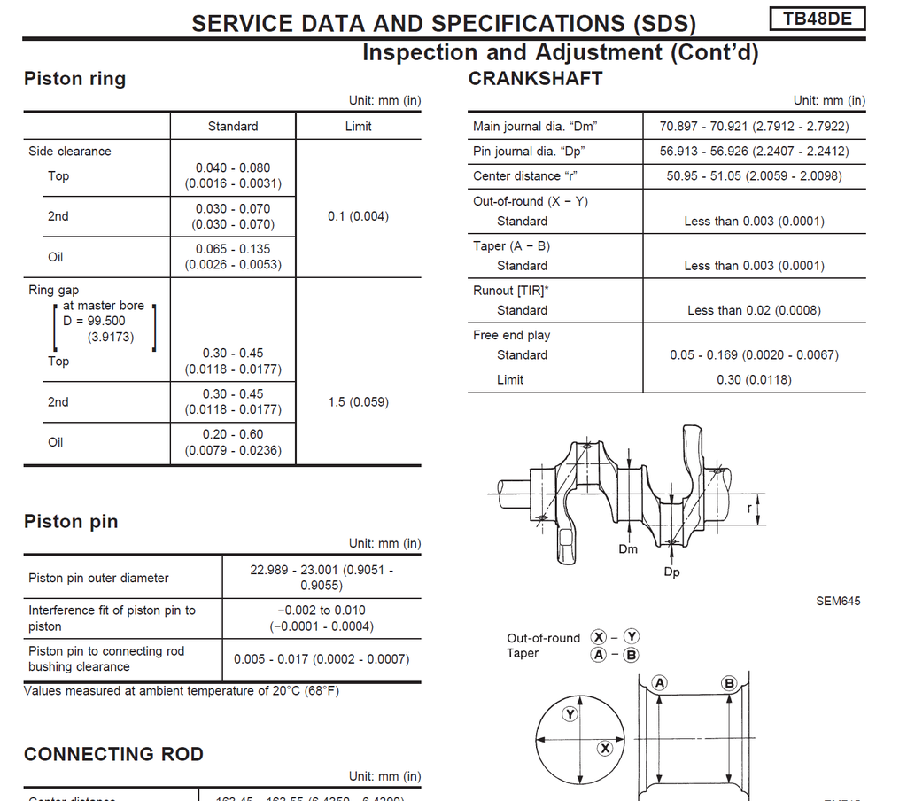

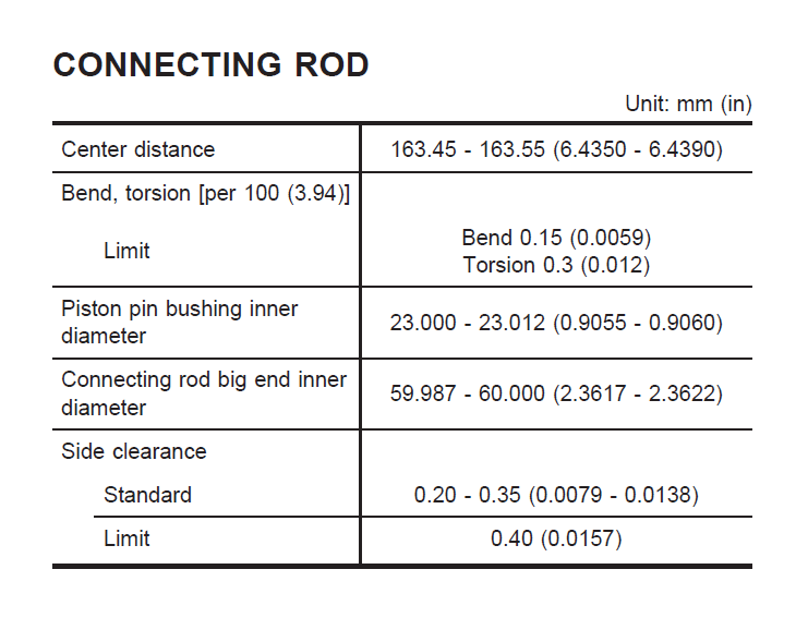

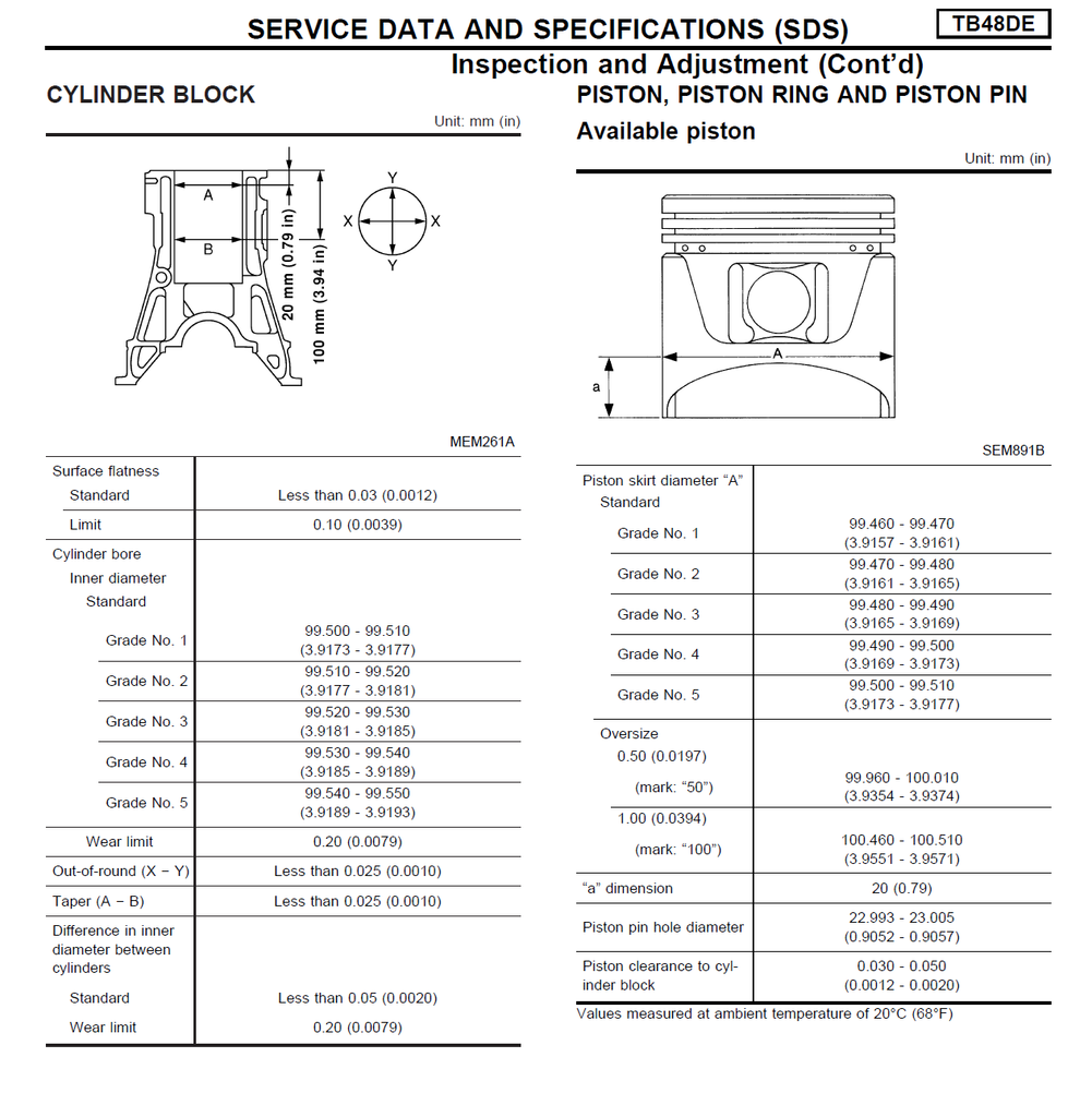

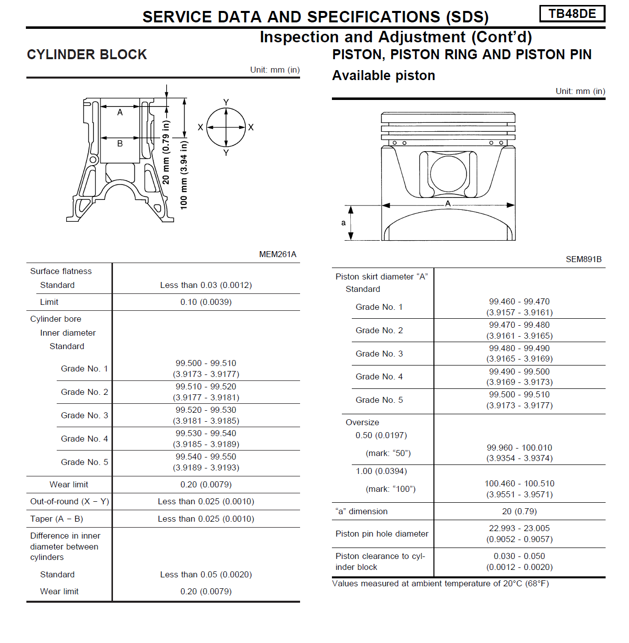

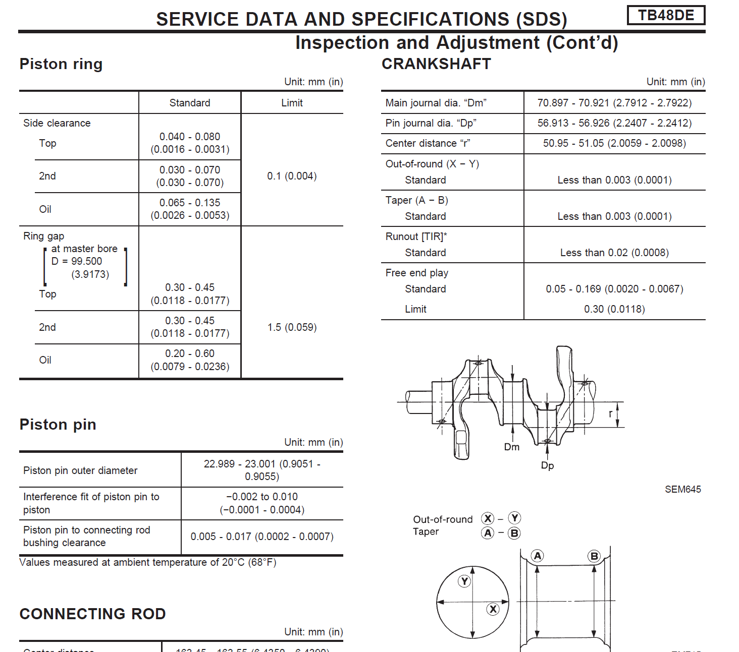

This is for the Euro-spec TB48DE from the Y61 ESM:
