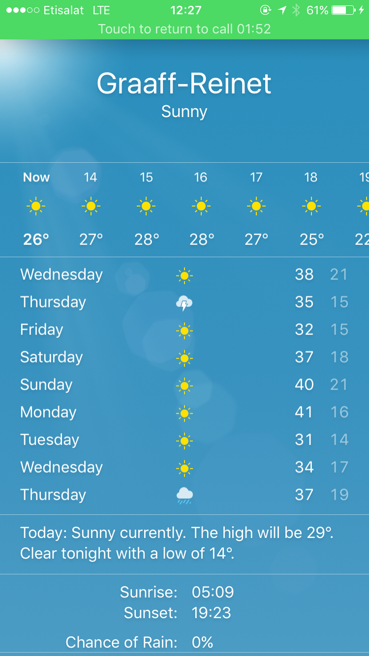

Too earlier to tell how the water and oil temps are, but radiator system in flushed, and (probably most importantly), my IPF spots are off. With bulbar, winch, bashplate, front mounted intercooler, think the biggest culprit was lack of airflow to the aluminium radiator. Anyhow, I plan to be Graaf Reinet next week Monday .... think the temp system will get a good test!!
image1 (1).PNG (773.1 KiB) Viewed 2718 times
