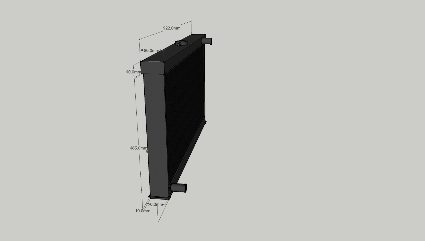

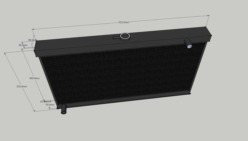

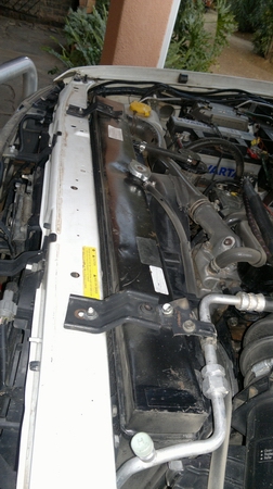

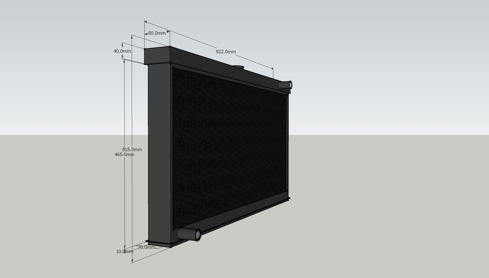

I have some info on my radiator. Here are the sizes and pics
rad 1.jpg (85.77 KiB) Viewed 3352 times
