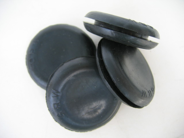

Dominic something like this picture should do the job , o and i never said earlier welcome to the forum
- grommet.jpg (49.04 KiB) Viewed 2477 times
