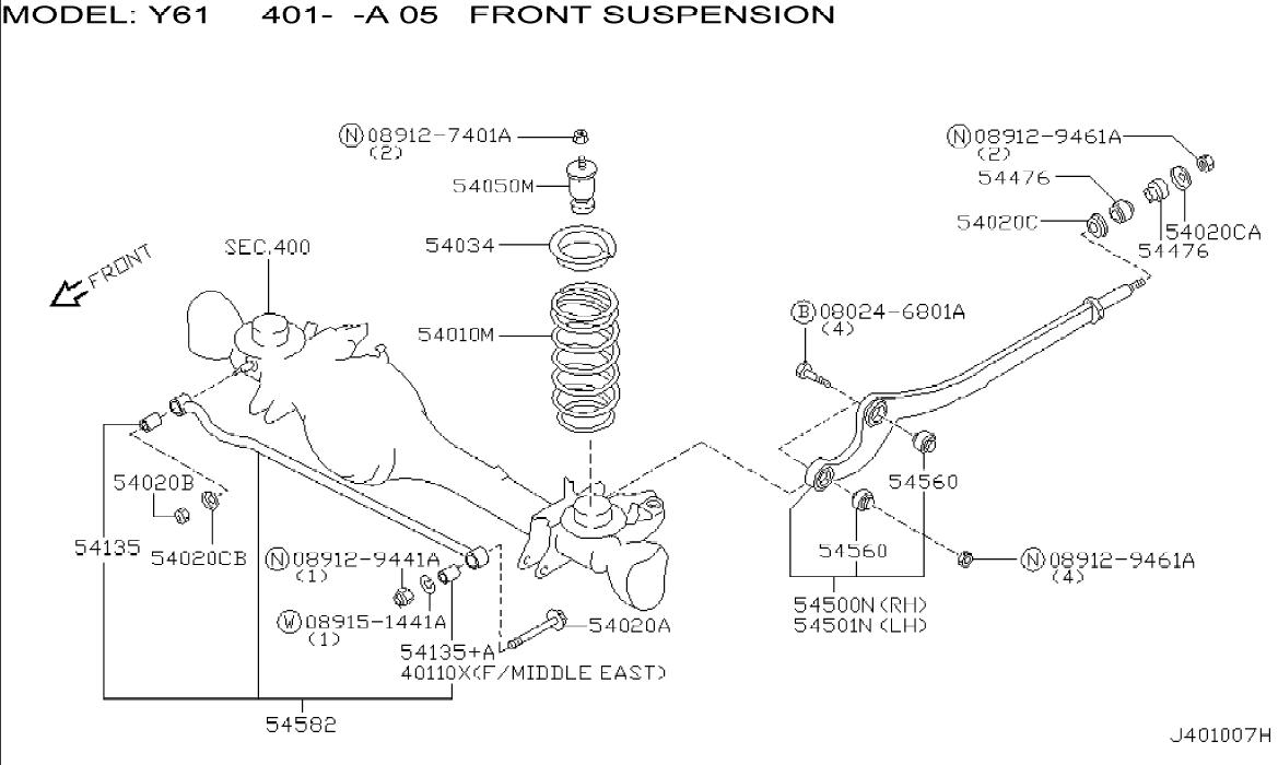

I assume you are referring to the bushes that are pressed into the radius arms at the front where they are pinned to the axle housing? As far as I know, the part numbers for those bushes (BUSH,LOWER LINK) are:
54560-01J00 (For most Y61s)
54560-VB011 or 54560-VB012 for some of the older ones.
The part is treated as a being available separately in the Nissan Japan parts system, but Nissan SA might have decided to regard the radius arm as an inseperable assembly, i.e. to only support the level of the complete radius arm with both bushes pressed in.

That is interesting, Frans.tour de frans wrote:The Toyota L/C bushes will fit to and they are cheaper from the agents.
By the way, the Toyota part number for those bushes is 48702-60050. The same part is used on the 80 Series and also on the 100 Series GX (that vehicle's model code is actually 105).
