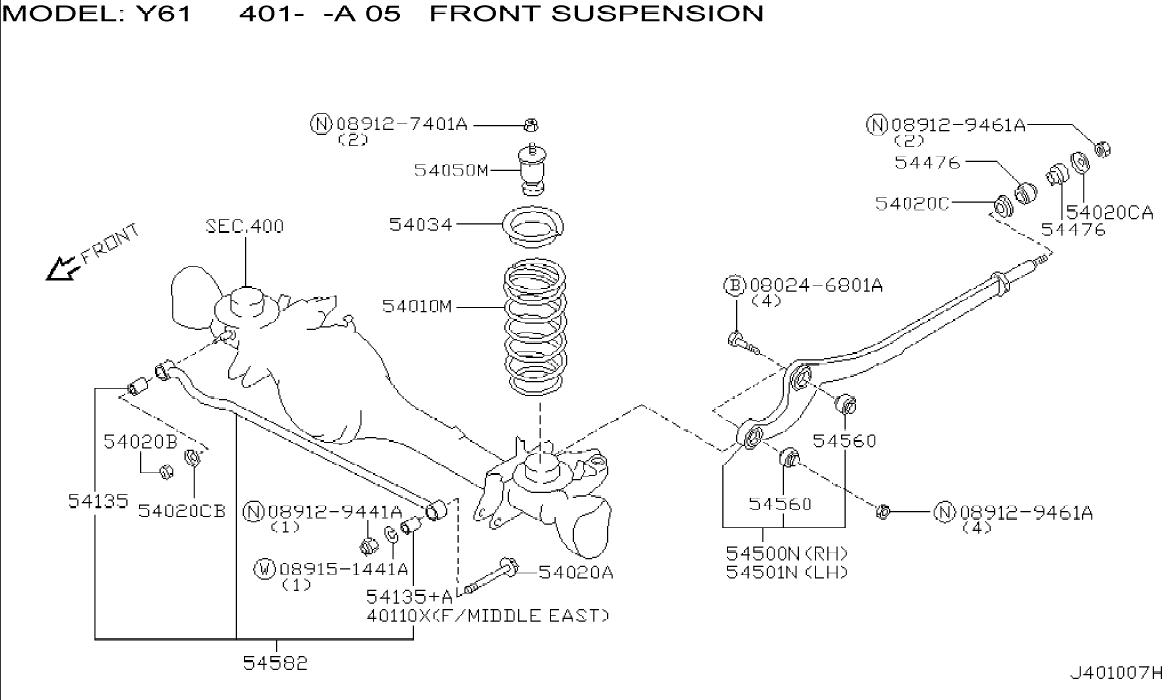

I assume you are referring to the bushes that are pressed into the radius arms at the front where they are pinned to the axle housing? As far as I know, the part numbers for those bushes (BUSH,LOWER LINK) are:
54560-01J00 (For most Y61s)
54560-VB011 or 54560-VB012 for some of the older ones.
The part is treated as a being available separately in the Nissan Japan parts system, but Nissan SA might have decided to regard the radius arm as an inseperable assembly, i.e. to only support the level of the complete radius arm with both bushes pressed in.
