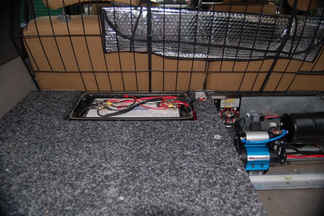

Hi, My 2nd battery is fitted at the back, in my drawer system. Shortern the drawer and it works perfectly.
This is of course if you have a drawer system.
Wilfred
Battery Installation.JPG (74.29 KiB) Viewed 2442 times
