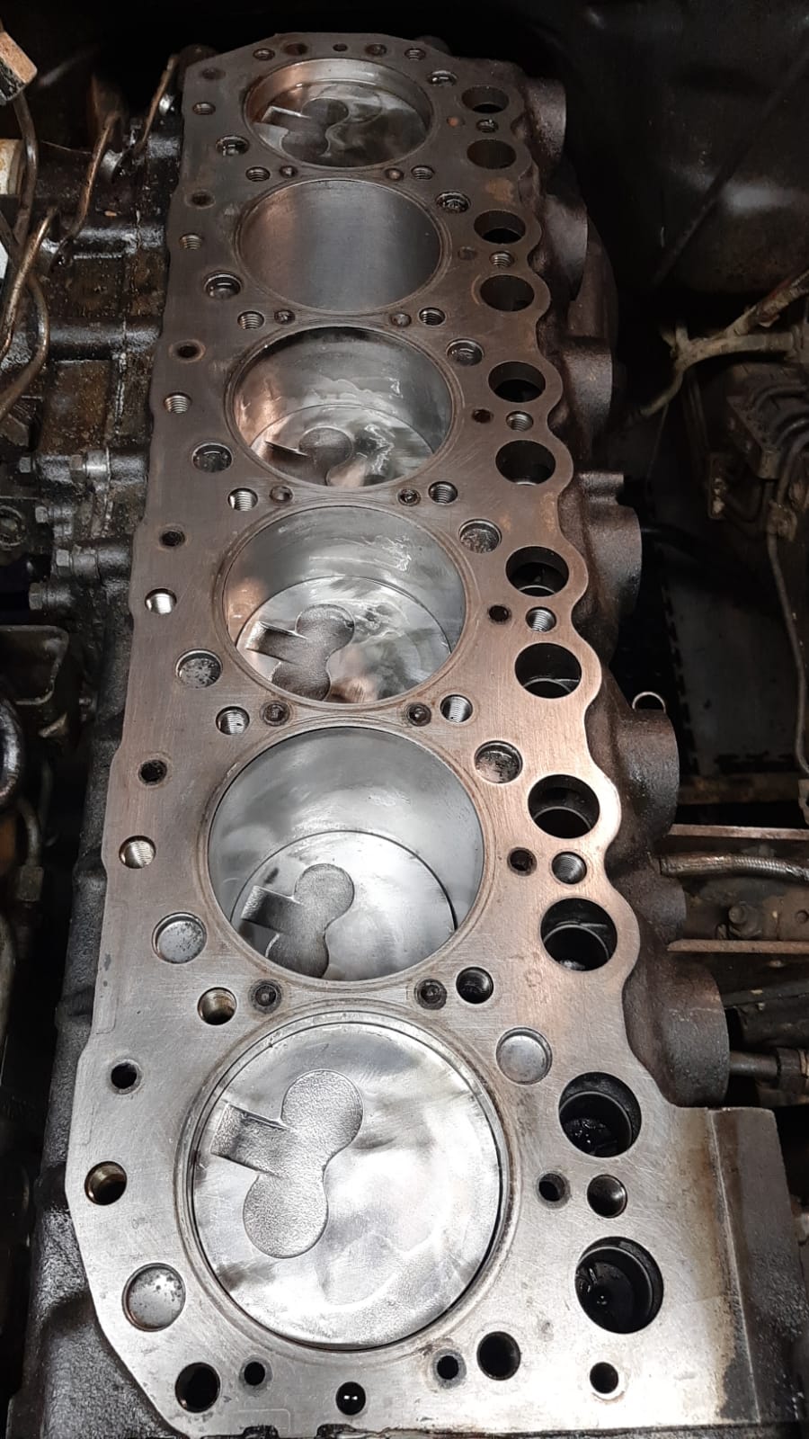

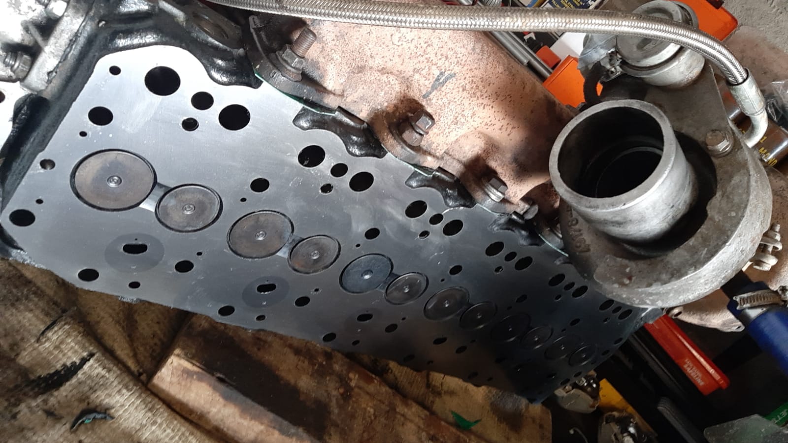

Some pics of the TD42 I'm looking at when its head was replaced:

Looking at the cross-hatching on those bores, that engine is barely run in.
As for timing chain and gears: I've never heard of them failing. I ran my TD27 to 400,000kms and it died due to a mistake rather than any mechanical failure.
Those Nissan IDI engines are VERY robust as long as you don't go high EGT.
The only failures are the combustion chambers. Since the head has been done on this one, I'd say it would do 500,000kms easily.
OH YES: not more than 10,000kms between oil changes, and use Delo Gold or a similar oil with high amounts of zinc.
