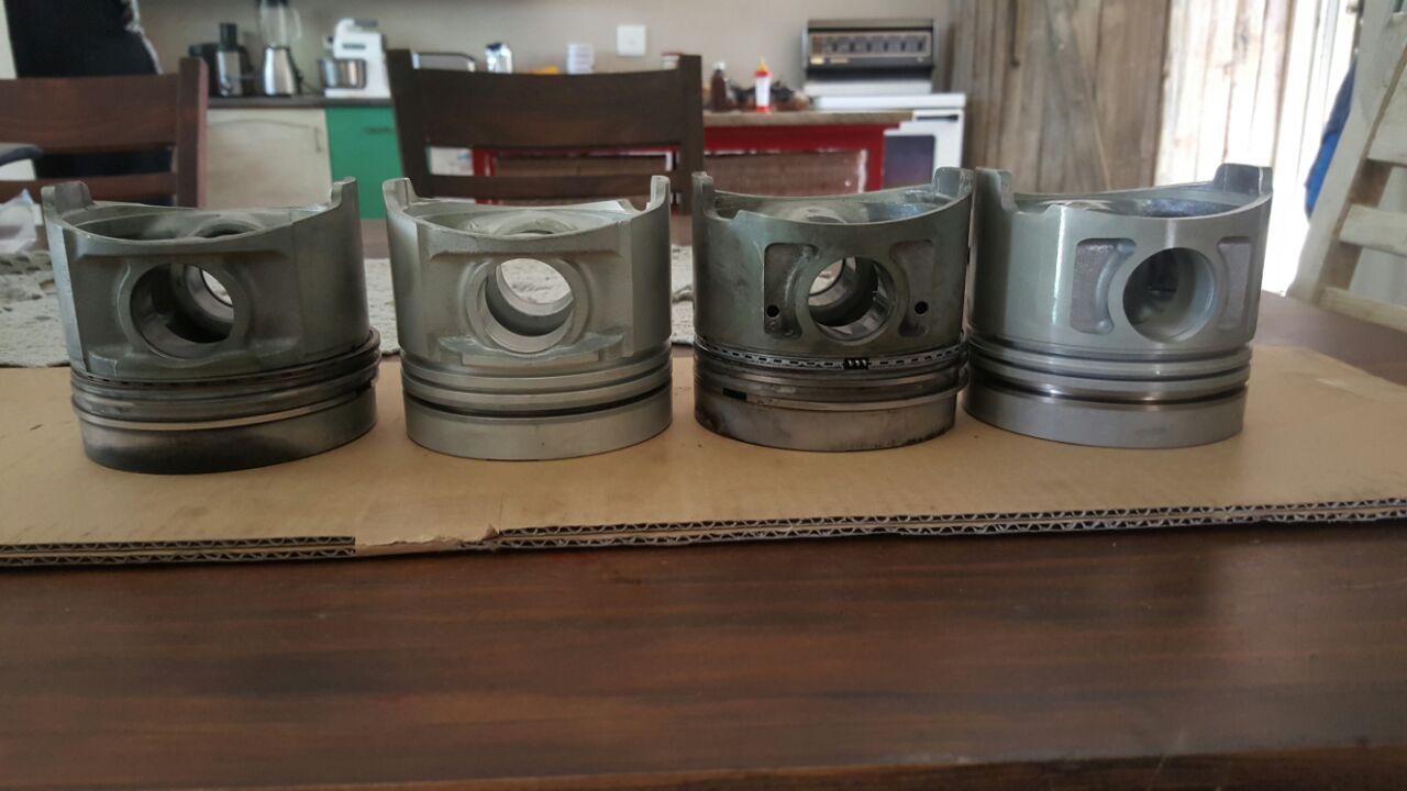

Below are some pics of the pistons
From left to right, NA black top 28mm and 30mm piston, TD27 30mm turbo spec piston, 28mm silver top piston, 30mm TD42TI pickup/ud40 piston

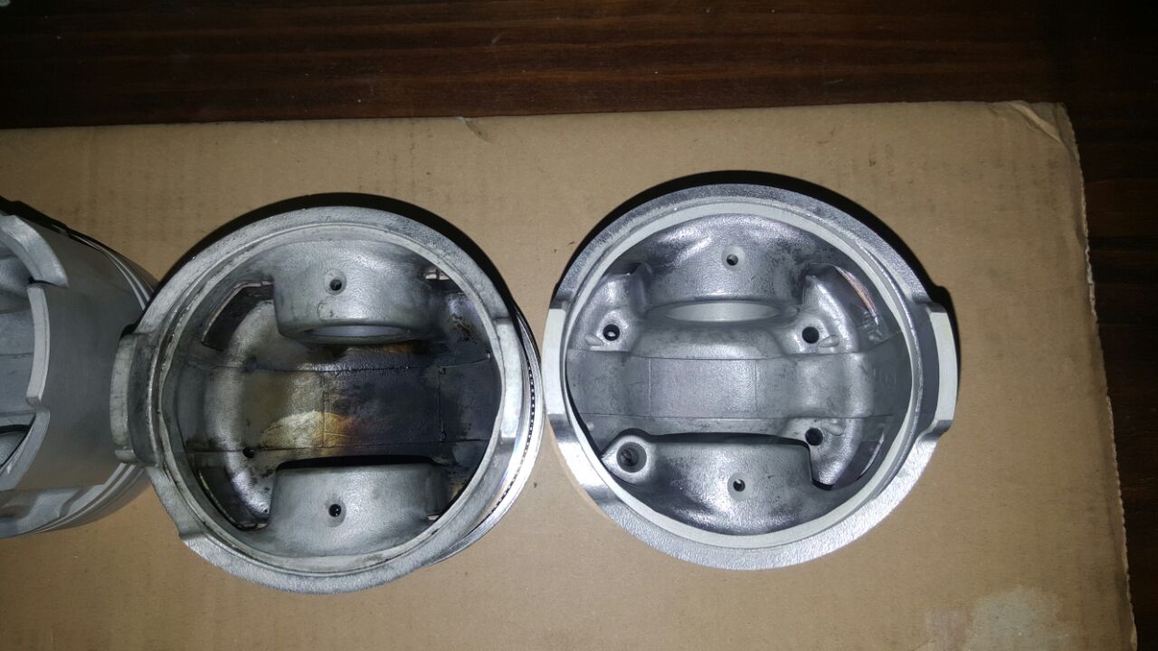

Top view of the silver top on the left and the TD42TI piston on the right

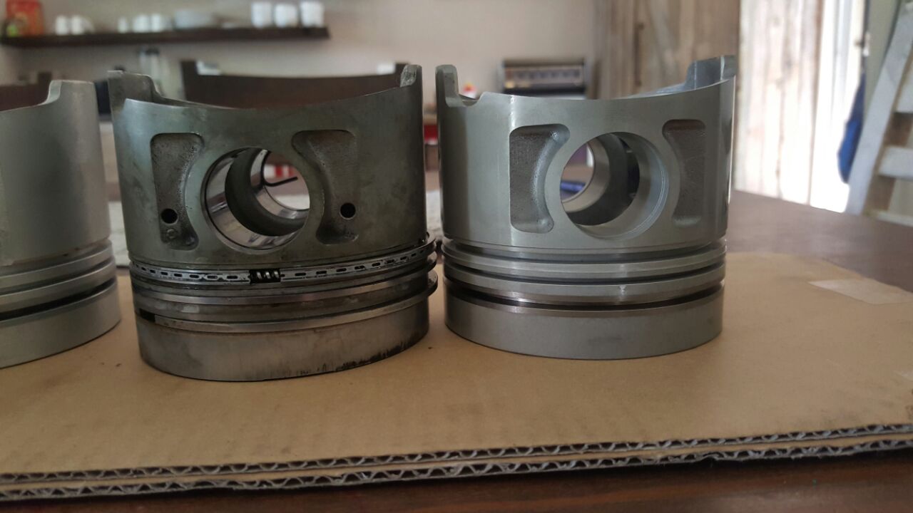

Side view of the silver top left and TI on the right

So if you look carefully, the silvertop and the TD42TI piston looks identical except for the 28mm pin and the cooling ports in the piston head of the TI

So the only reason I think the silvertop is so popular is because from all the NA engines this ons has the strongest pistons and will take the most punishment when a turbo is bolted on.
Its unknown if the piston has the alfin incerts in, but I suspect they do.
They will obviously not be able to take nearly as much punishment as the TD42TI pickup engines, but is the secons best standard engine out there :thumbup:
