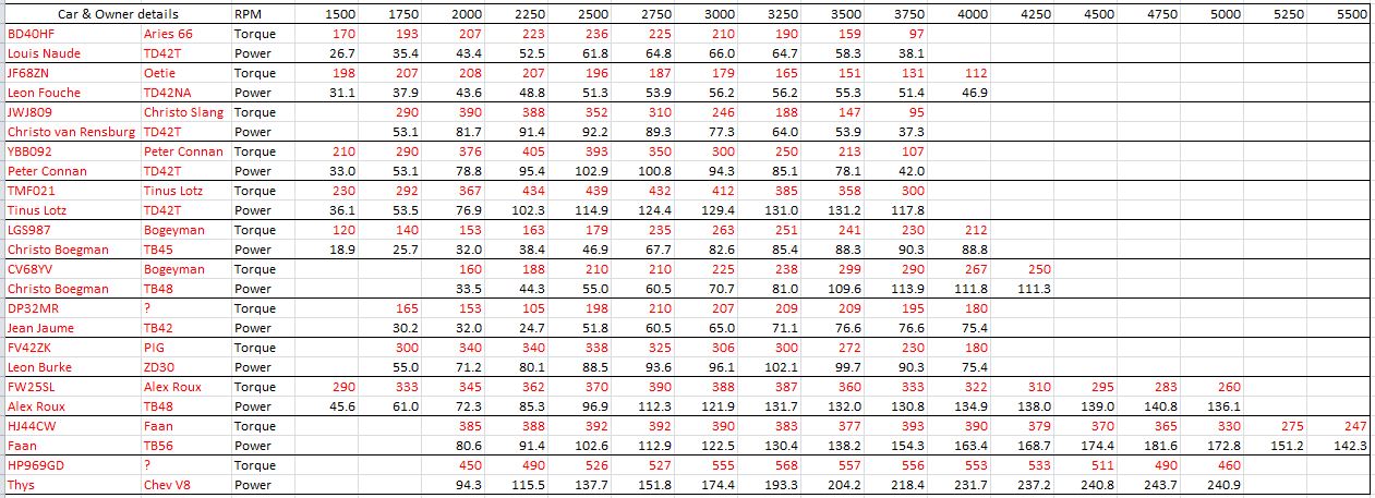

Here are the results of all the Patrols in tabular form:
Note that I tried to take the average of two runs on each car.
I wanted to do a graph of all the cars, but couldn't get it to work. My Excell skills are rather lacking, and it gets way too confusing anyway.

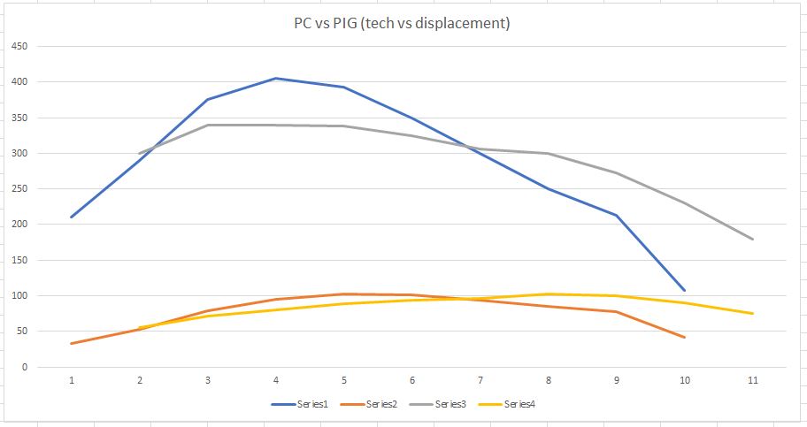

So I did a couple of comparison graphs for discussion.

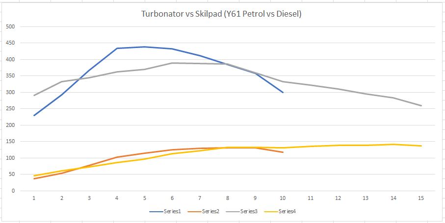

Firstly, two Y61's. Sort of. Well, Y61 petrol (TB48) versus a TD42T. Specefically, the Turbonator's wheels: Notice how the petrol has a far wider, flatter torque and power spread. But the TD42 has a considerably higher peak torque, and that peak happens to be at almost exactly at120km/h in top gear.

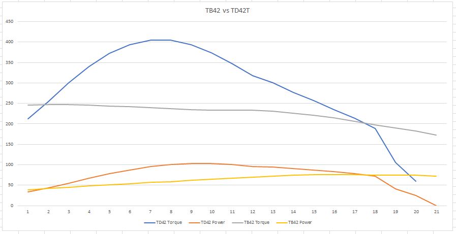

Here is something similar, but a bit of a cheat: this is my car, nine years ago with the original TB42, vs the weekend's result with the TD42. Not the same dino, not the same weather, so not really comparable, but still: Here is a comparison between my TD42 and the ZD30: Similarly to the petrol engines, the newer tech engine has a flatter, broader spread, specifically at higher revs.

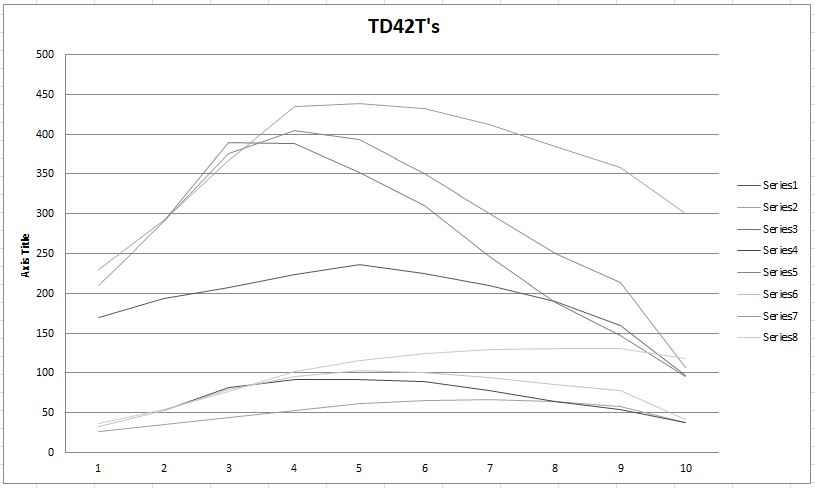

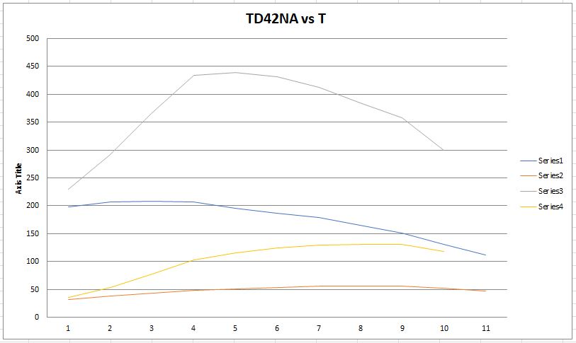

And here are two TD42's. NA vs Turbonator: And lastly, all the TD42 Turbos. Hopefully Michael can explain the cause of the differences:
