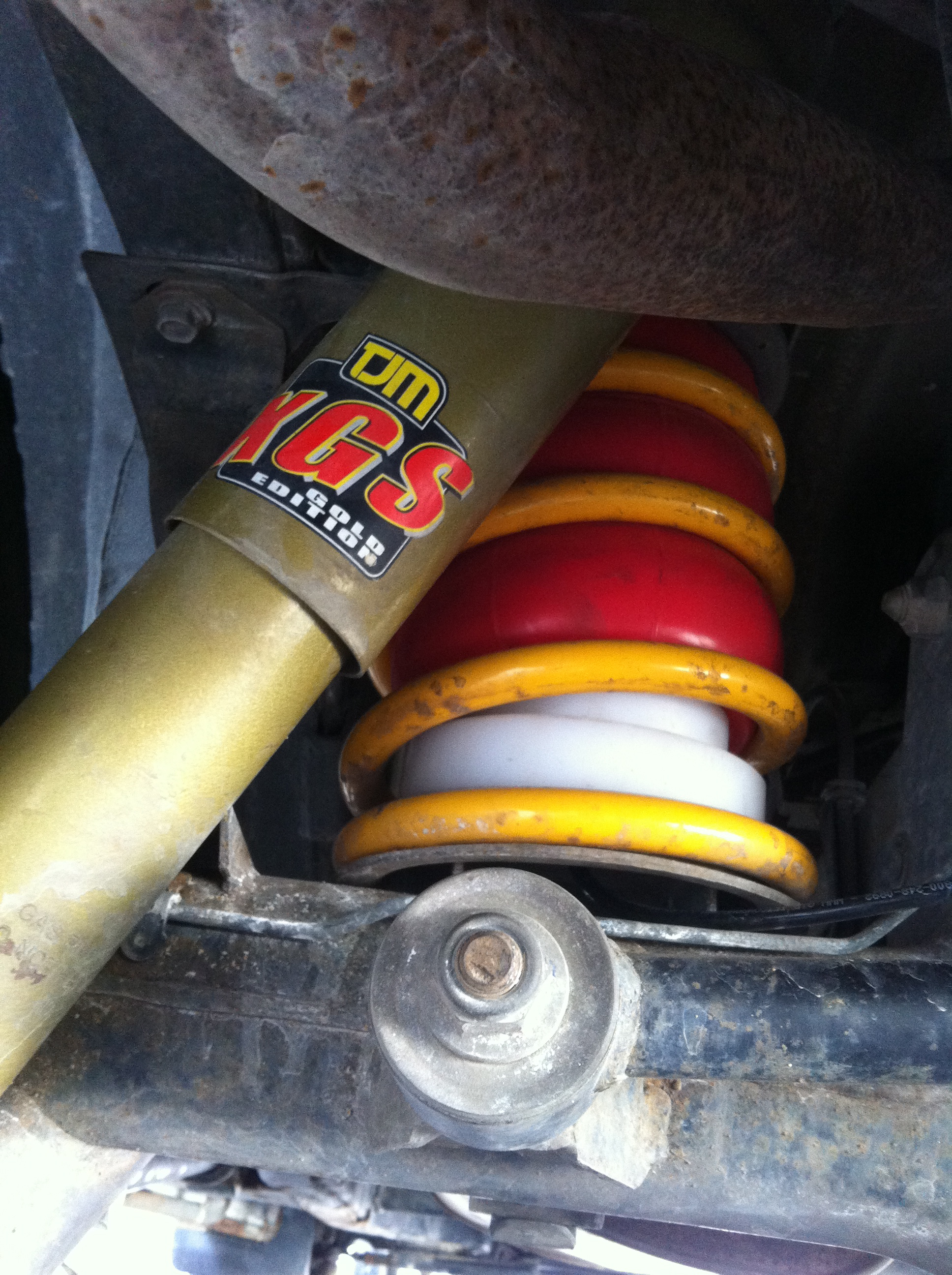

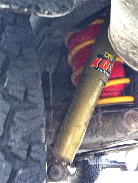

With my application, I've added the Gremel Tech Air Springs, in addition to the already fitted TJM Gold series upgraded suspension.... so I think the shocks are already the heavier duty type...
Now I'm just waiting till next month, for the first medium off-road trials, as we're off to the Breede River area, accessed via gravel roads, as I'm led to believe.... I'll post my experience to this links thereafter... :salute:
this is the set up as fitted. I've checked the air-feed pipes, and they seemed well placed

Nino62 wrote:Hi Clem,
Okay - good luck... In the end I fitted twin shocks. BTW, are those spring seats the right way around?

Hi Clem,
I've just had some feed-back from Gremel Tech, after sending them photos of the finsihed installation..... :think: ... AND yes, they say the white stepped spacer was supposed to locate in the upper spring opening, with the wider flat side up against the red bellow, and the shallower (not shown) spacer (that the fitment centre has fitted on top, is supposed to go below .... :redface: :surprised:
All must now be dismantled, and re-arranged. Thanks for the query, that prompted me to ask further questions ... :clap:
At least I hadn't done more than the mileage back home, after fitment.....

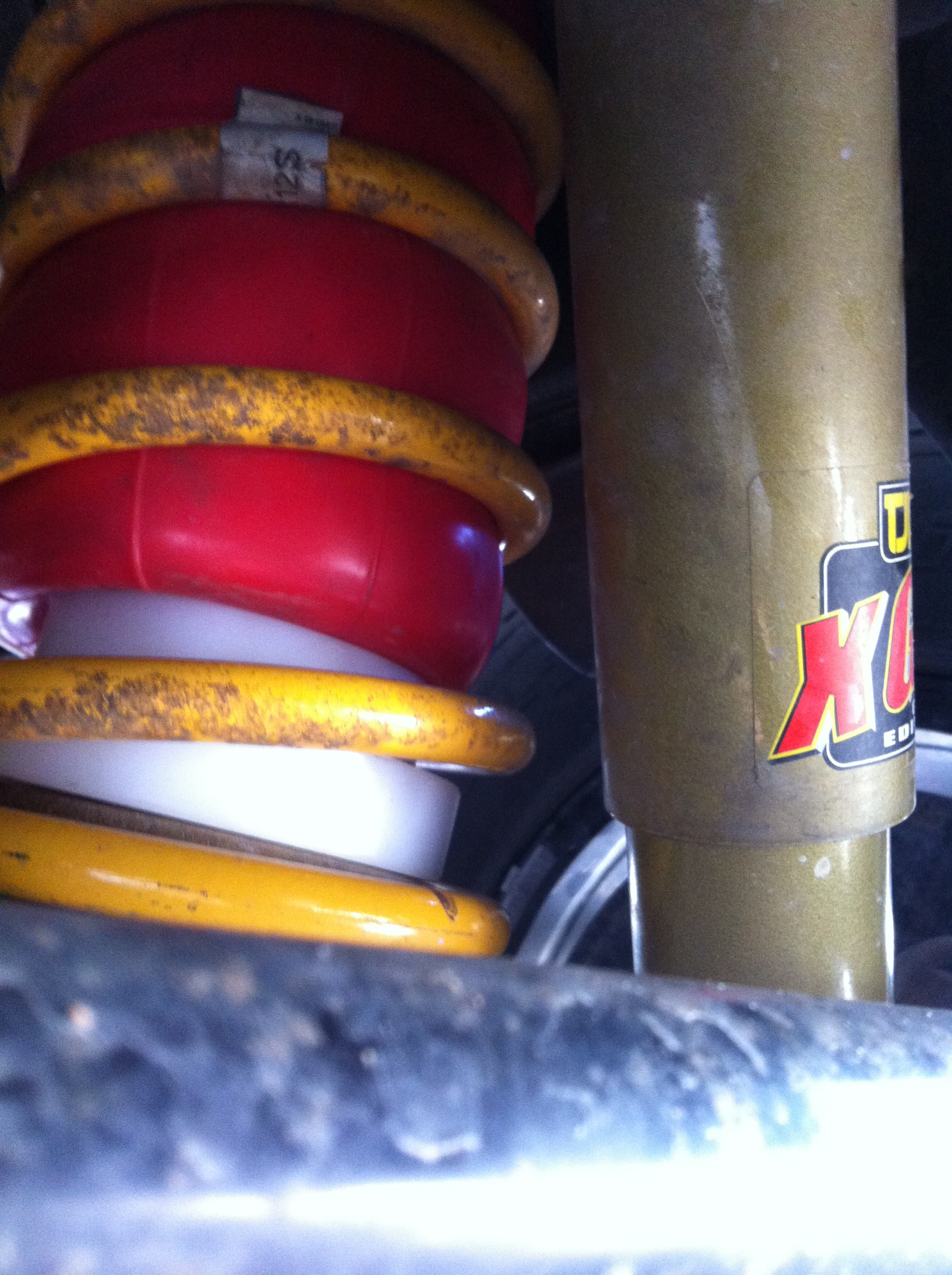

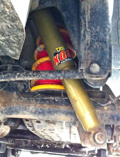

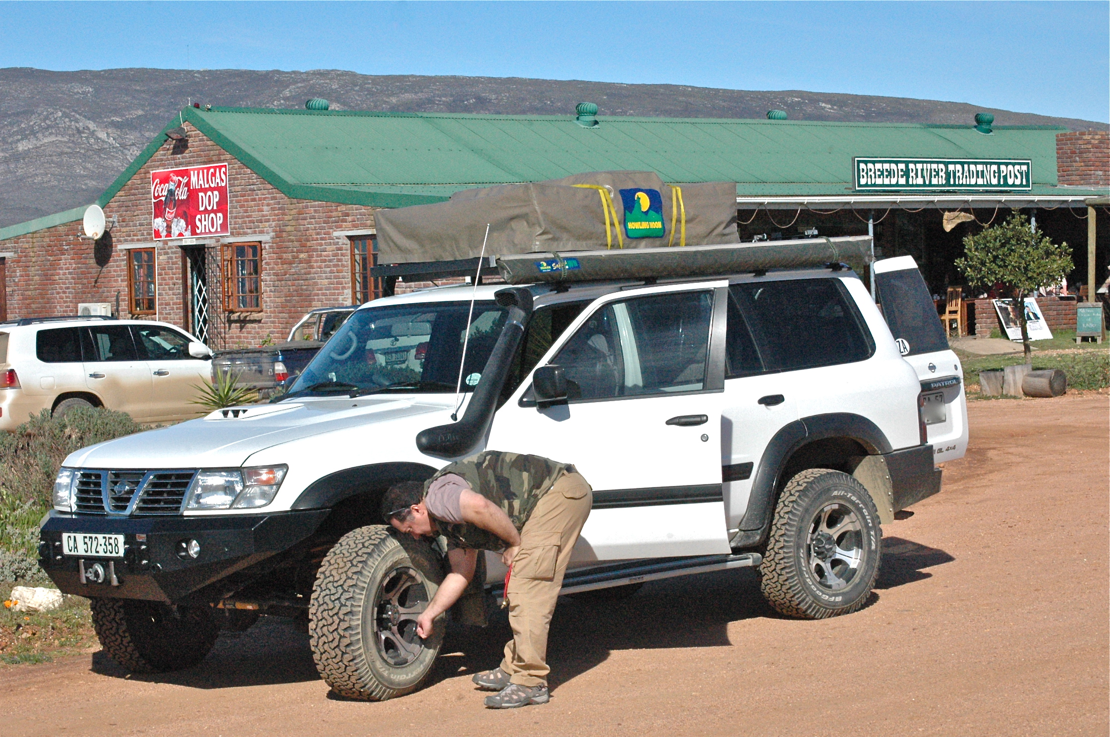

I finally had the air spring helpers fitted the correct way around, and tested the Troll on the N2 (Swellendam to Breede River / Infanta gravel road route.... done a total of +-200km on the gravel, including the De Hoop whale outlook (spotted at least 15-20 whales from vantage point), then off to Bredasdorp (from 40-100km/hr, pumped to 1.0 bar pressure)
RESULT = WHAT A BEAUTY -- :thumbup: :woo: excellent stability, with four people and baggage loaded, and a VERY comfortable ride. Tyre pressure was 1.8 bar (could have gone down to 1.6 on the slightly rougher patches, but 1.8 was great on the majority of the reasonable gravel stretches)
the corrected setup
the corrected setup
adjusting the tyre pressure
