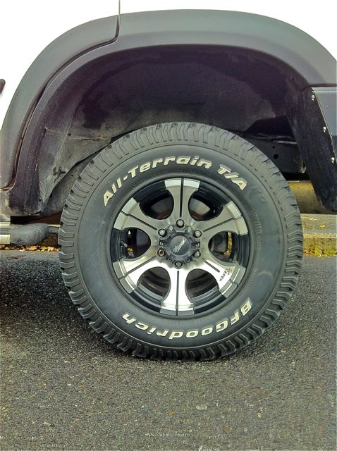

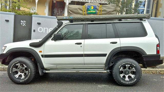

BEFORE - fitment of Air Springs - granted with a slight load (jerrycans empty though)

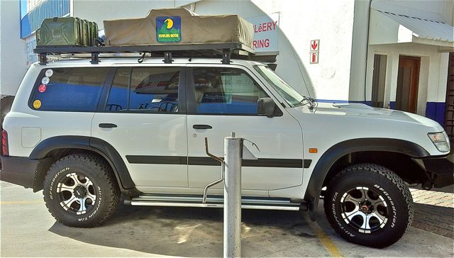

Post fitment of Air Springs .... including a better view over the bonnet (at the recommended 0.5 bar - unloaded.
