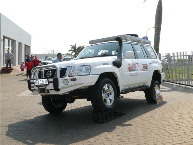

Another dilemma: My Patrol is currently all white. I am looking for a bullbar, so do i go black or colour coded? Also in the market for a roofrack, was thinking black? Any views?

Hi Louis
I guess that is a question of peronsal taste
My preference is that darker patrols can possibly go colour coded, but a light coloured or white Patrol (such as mine) looks like it has some sort of disease if all the steel bumpers and roofrack is white as well. So all mine are black. Colour coded is more expensive.
If you are interested in a second hand ARB bumper, pleae PM me. It is black though (http://www.patrol4x4.co.za/viewtopic.php?f=43&t=3474)

Gents herewith a pic of a white 4.8GRX with a colour coded ARB and for me this looks blerrie mooi
Wit GRX met wit ARB BUMPER
Donald se Patrol.JPG (56.99 KiB) Viewed 2646 times

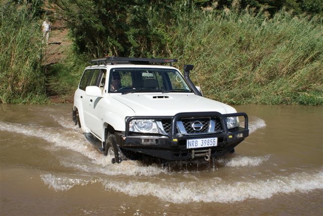

Hier is n wit 3.0Di met swart bumper lyk ook mooi
Wit 3.0Di met swart TJM
Thys river crossing1.JPG (70.81 KiB) Viewed 2646 times
Entlik lyk Patrols almal blerrie mooi

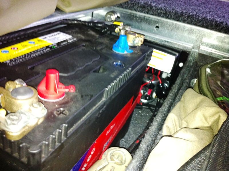

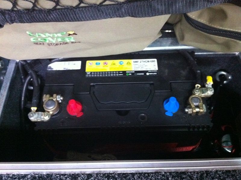

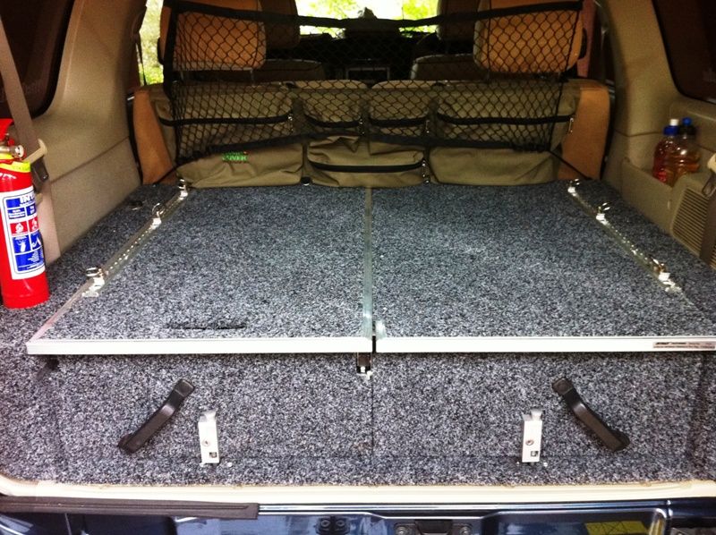

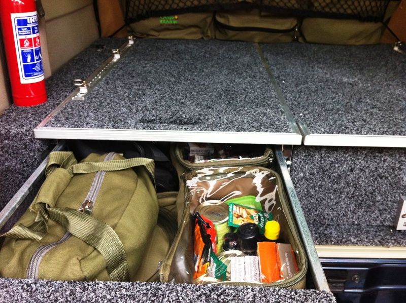

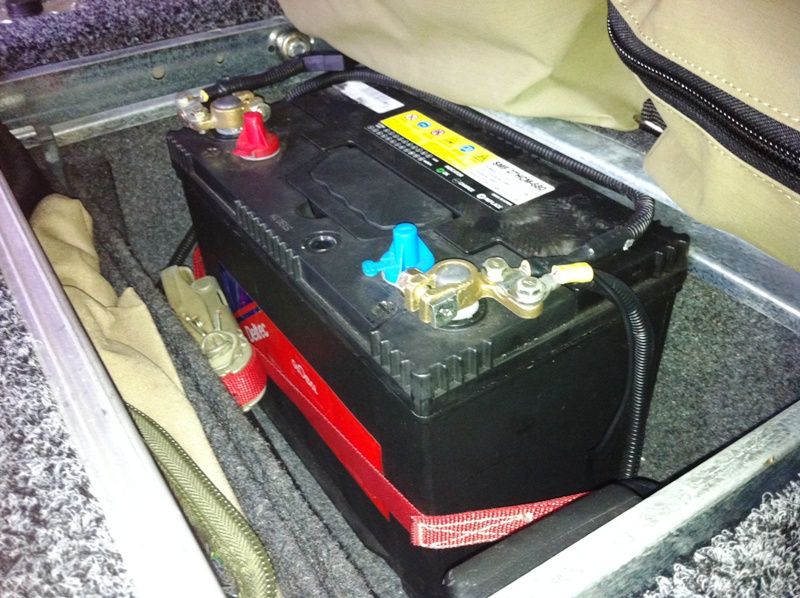

2nd Battery installation pics as requested...
Rear of Troll with Aussie Outback roller drawers
Battery bay is incorporated into top left AND seperate from left drawer section
Top view...
Side view...
The fittings...
Hope this helps
Pete

Thanks, Pete, not sure this will work for me, need the rear seats for the kids...
Has anybody installed the battery in the engine bay on a Y61?

Re: Accesorising a 4.8 GRX
Hi Louis
Most of the 4.8 cars have their second battery on the back it seems. Probably too cramped otherwise.
My second battery is in the engine bay, m engine seems not to take that much space.
However its get a little hot inside the engine bay for the deep cycle battery, and is lifespan may not be that long because of it.
Stefan
Posts: 1692
Joined: 28 Apr 2009 08:43
Full Name: Stefan de Villiers
Nickname: Stefan
Post by Stefan »
Hi Louis,
In the 3.0 there is enough space to fit a 2nd battery and when I purchased mine the dealer installed a brand new Deltec 105. Due to the heat in the engine bay the battery only lasted 1yr. So unless you can insulate it very well, the engine bay is not a great solution. My 2nd battery connection is now in the back.
Posts: 2671
Has thanked: 61 times
Been thanked: 258 times
I have had my second battery (95amp) in the engine bay since July 2010.
The system is National Lunar.
No trouble yet, touch wood. But if / when it fails the forum will know.
