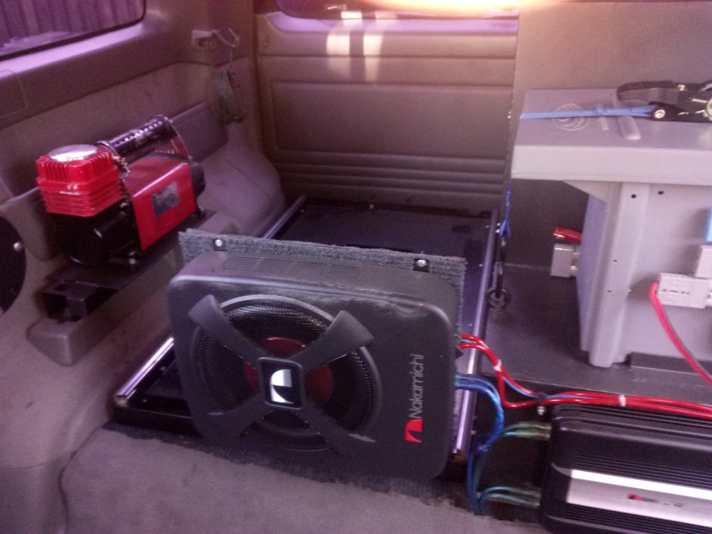

I used the largest fridge slide available which is the old Frontrunner large slide and used to fit my old Snomaster 100 l and my new Snomaster 74 l double door Expedition fits with plenty space to spare. You can also see the bracket I made for my compressor which clears the fridge and bolts into the back seat mounting. I can open the main part of the fridge from inside the vehicle but need to use the slide to access the freezer. I was going to replace the back side window with a gull wing window to access the fridge but we are now building up the bakkie for overlanding so doubt if I will ever do it.

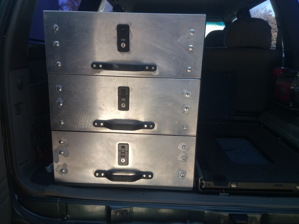

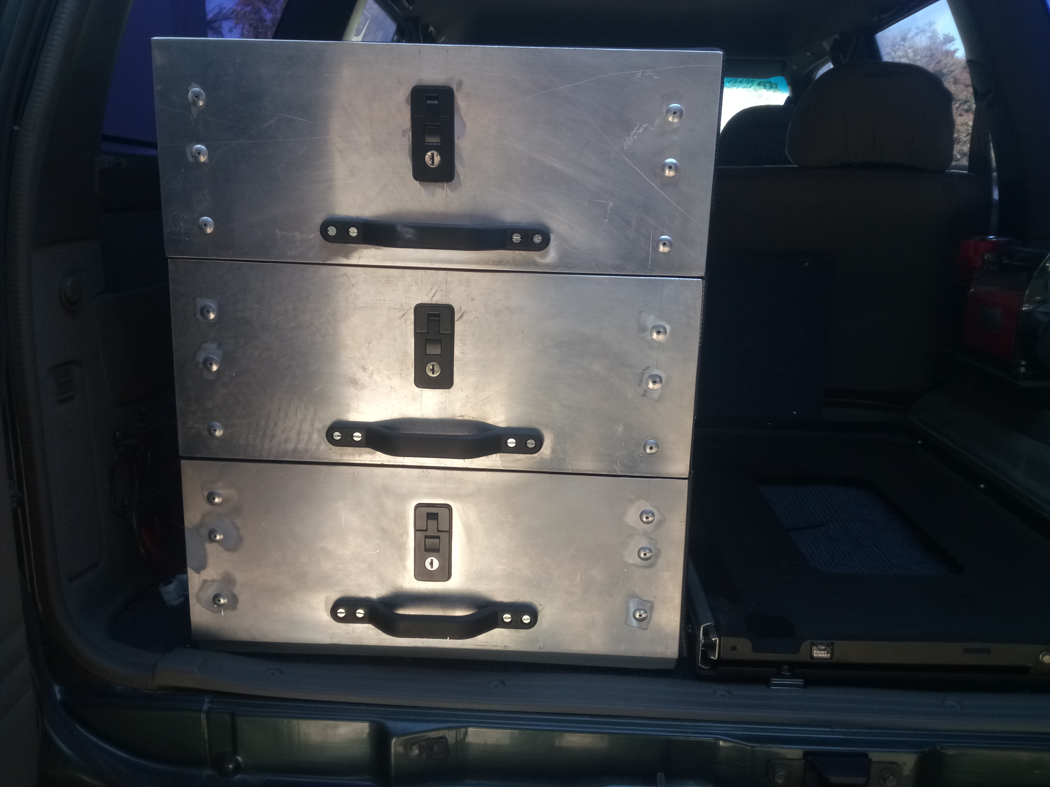

Built the drawers with steel case and aluminium drawers. Bottom drawer is 900 mm long and the top 2 drawers 600 mm long. The reason will become clear with the next photo. The whole system is mounted with 2 bolts that fit into the old jump seat mounting.

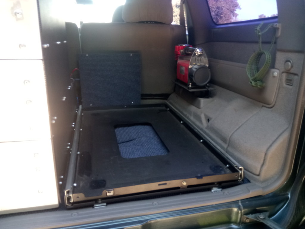

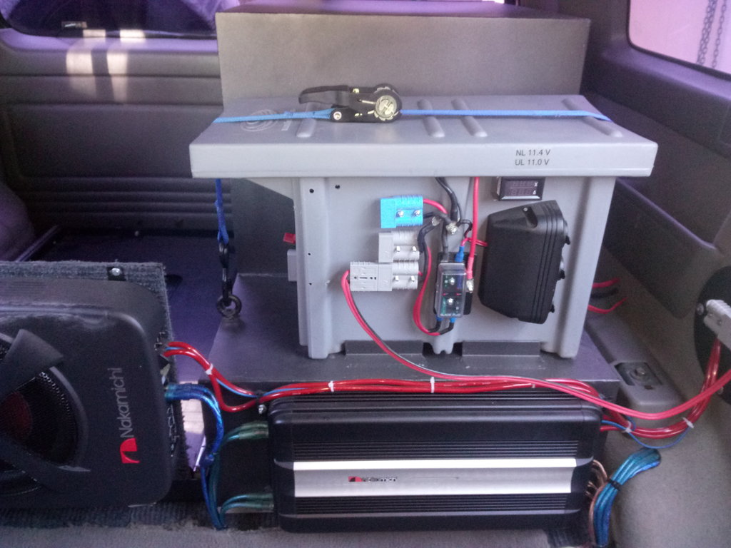

The reason for the 2 shorter drawers. My power station fits perfectly. I also had enough space to mount the amp on the back of the longer drawer.

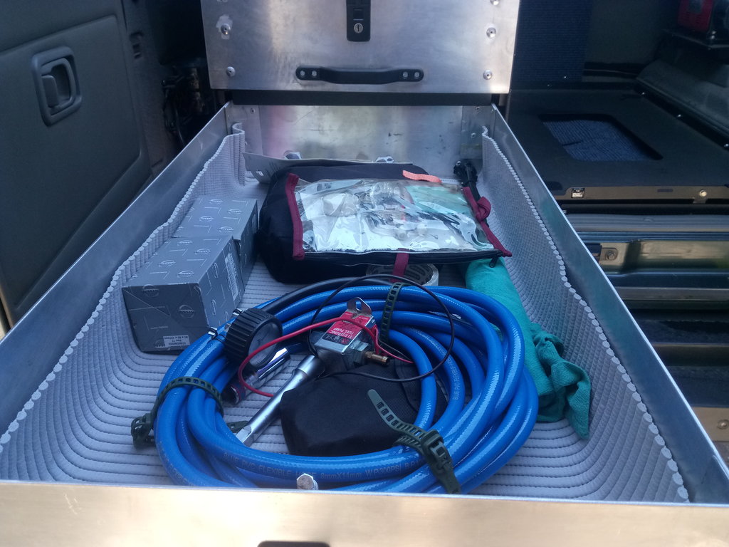

The large drawer. Allocate this to SWAMBO for her clothing and you ain't sleeping in the doghouse for a long long time.

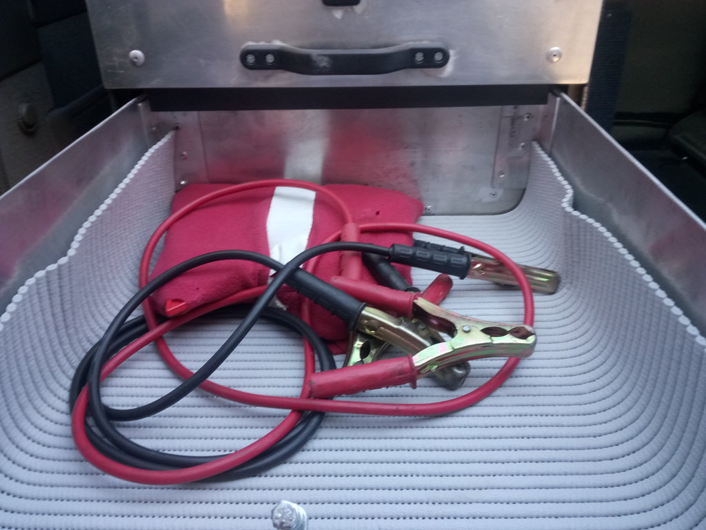

One of the smaller drawers.

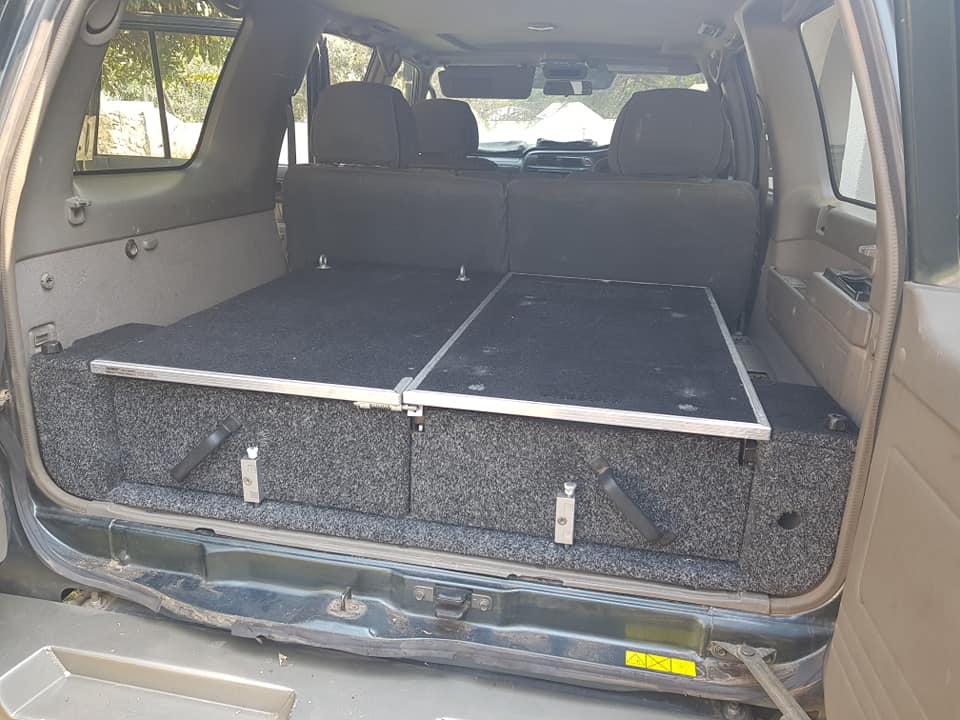

I recently bought Alex' Outback drawer system from him. Very happy with it so far, and it fits "nommer pas". As for how well it works / similar, I cannot comment, as I've not finished kitting everything out as a result of my recent "very busy busy busy" thing.
Biggest shortcoming I have at the moment, is my fridge. I run a 90L SnoMaster fridge. Previously, it worked well just in the boot, but now because of the drawers, it sits too high to open the lid... And the 90L SnoMaster size is not compatible with the widely available fridge slides here in Gauteng. I have ordered a drop-slide which will work, but I'm still waiting for it to arrive.
The one thing I liked (sort of) about the Outback drawers, was that because they are designed specifially for the GU Wagon, it fits without having to make any major modifications. And I like the way it looks. And it's going to make a massive difference in how we tour, I think
The frame lines up perfectly with the bolts for the four load points in the boot.

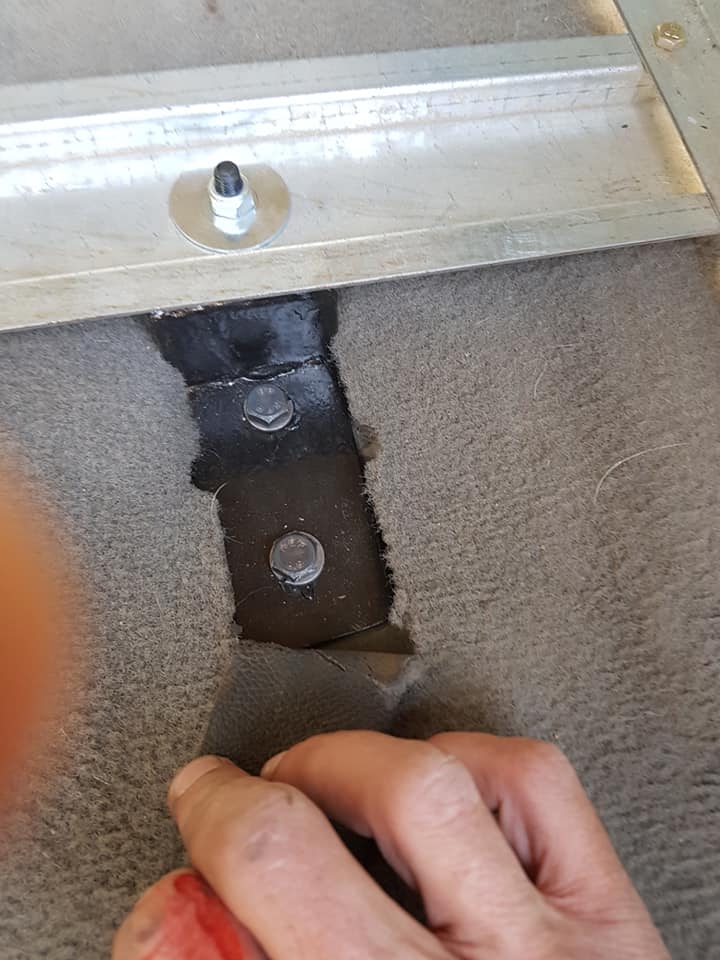

But I was a little worried about weight (especially with the fridge, when it is installed) on the 4x6mm bolts which bolt through the drawer frame, so I butchered some steel plate and added four more brackets. Two on the sides, where they bolt into the spots where the hinges for the third row of seats fit, and two at the bottom, which bolt in where the "locks" for the third row seats sit.
Anyways, I don't think this will help much, as I've still got no "real-world experience" in rolling with the drawers. I'm still finishing the stuff off. But in the meantime, I'm happy. Will see how it pans out when I get the fridge slide.
Edit: Oh - yes. In terms of what David said regarding the fuel pump, I agree 100%. In my case, the right hand drawer and "top" both slide out. I will be mounting my fridge on the right hand side, and should I need to get to the fuel pump, I can remote my fridge and just slide out the top shelf and drawer. I've already cut a neat "access" flap into the carpet so that I can get access to the fuel pump cover panel without any issues. :biggrin: :biggrin:

ricster wrote: 23 Aug 2018 09:33 Is that a little spanner rash on your finger there?......Patrols are not for sissies and plasters.....hahahaha
Nicely spotted, Cedric... :rolling: :rolling:

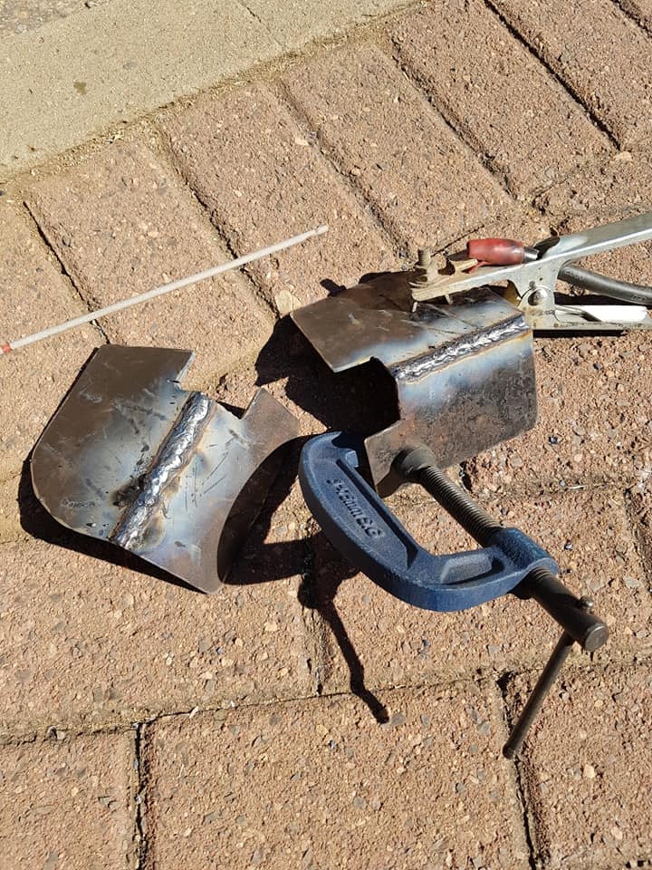

Not spanner rash, sadly. You can rather call it stupidity and haste...
I was in Cape Town a week or two before doing this. Whenever I'm away from home, my wife re-arranges all my stuff and I can never find what I'm looking for. In this case, I could not find my leather metal work gloves. It was a quick job, and not much cutting, so I reckoned I'd just do without.
There are two great benefits of using gloves when doing metal work.
1: Cutting metal means that the bits you are cutting get hellishly sharp. Gloves prevent you cutting your hands open on the sharp bits before you debur them...
2: Cutting metal means the metal gets very hot. Wearing gloves means you can handle the metal without burning your hands.
In short, I absent-mindedly picked up a piece I'd cut right after cutting it. It was a few gazillion degrees in temperature, which means I let go of it fairly quickly. Dropping the sharp end onto my unprotected right hand...
Anyways, lessons learnt. Wear your PPE when doing metal work... :rolling: :rolling:
