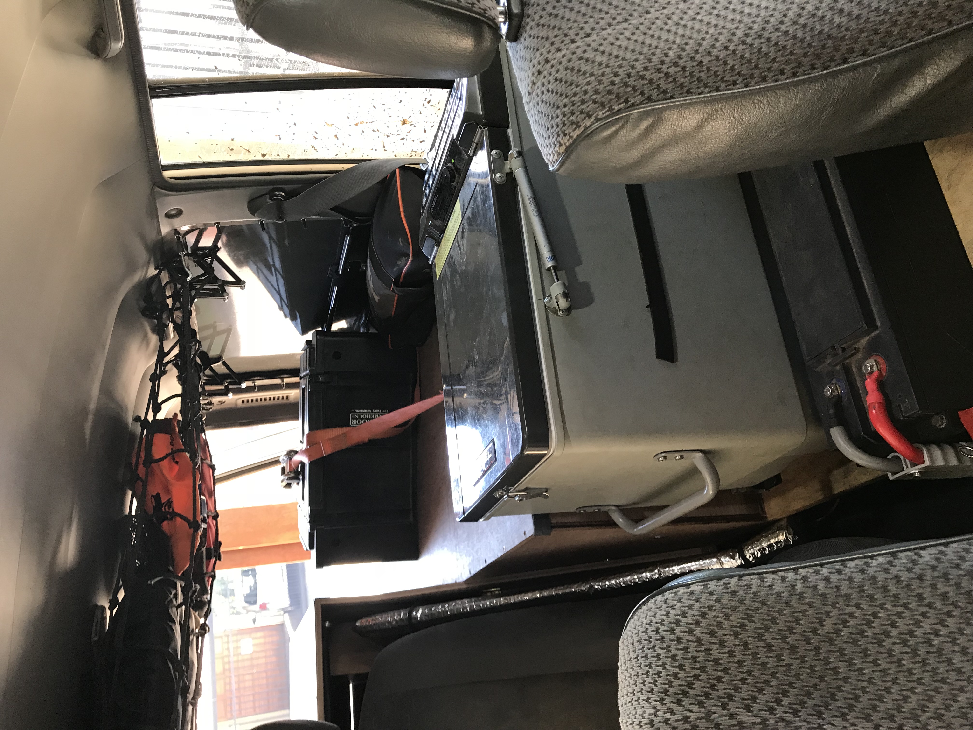

- Has thanked: 235 times

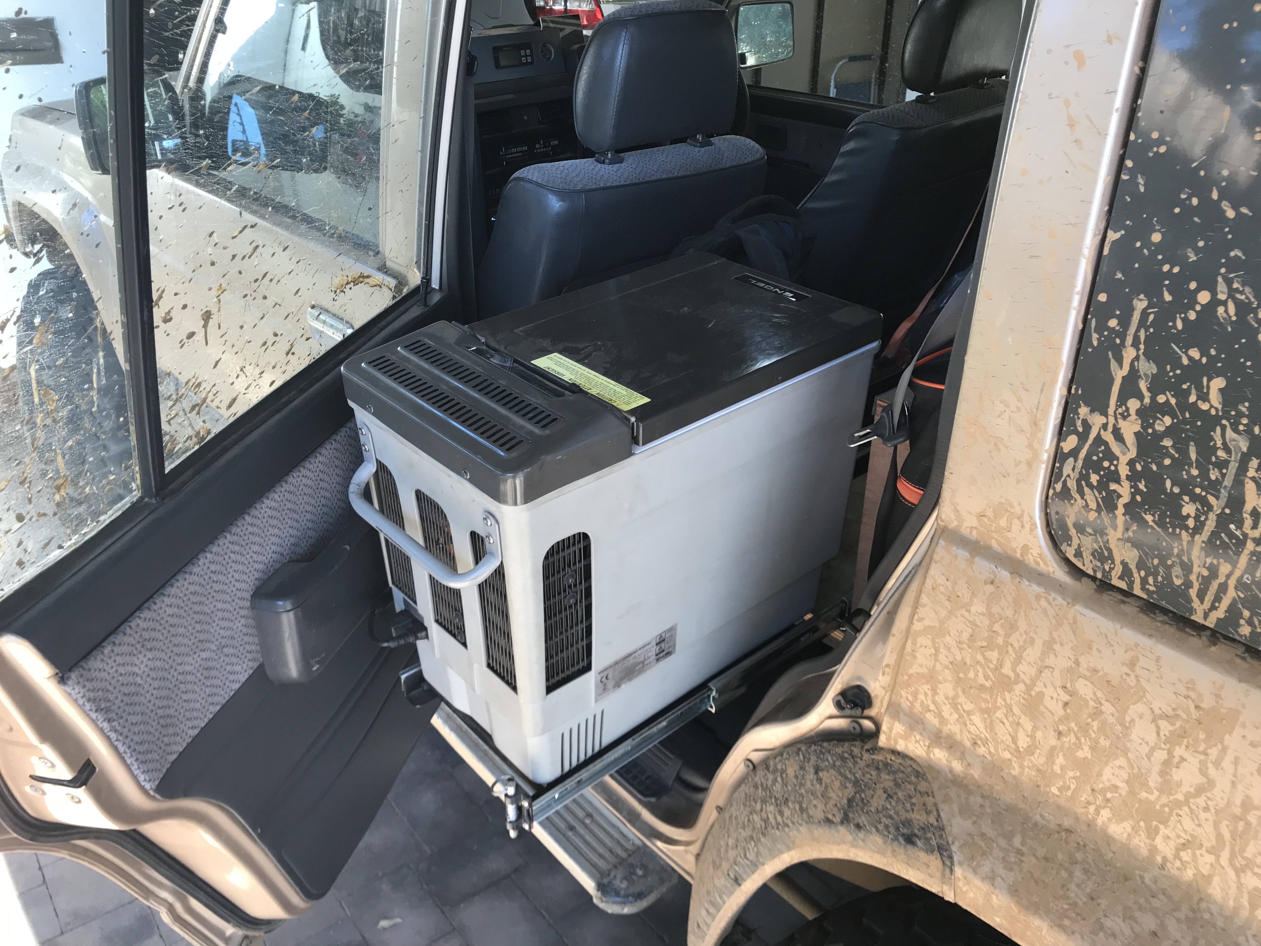

Re: Drawer system question
Something like thisizakjbrt wrote: ↑18 Aug 2018 17:02Thanks, so it’s basically the nr 1 I mentioned?Peter Connan wrote: ↑18 Aug 2018 16:17 As Tinus mentions, a big issue wit a drawer system that has the fridge on top is not so much whether the the fridge fits in the car, but whether you can reach inside the fridge...
For that reason, I built mine to have the fridge next to the drawers.
2007 Nissan Patrol 4.8 grx

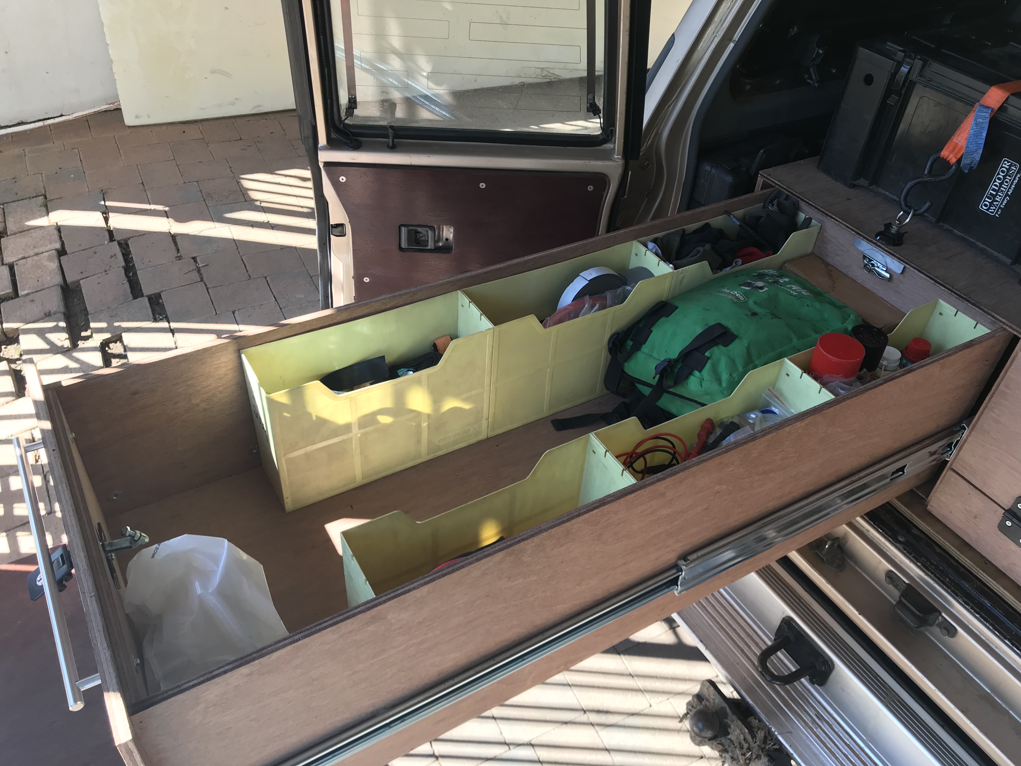

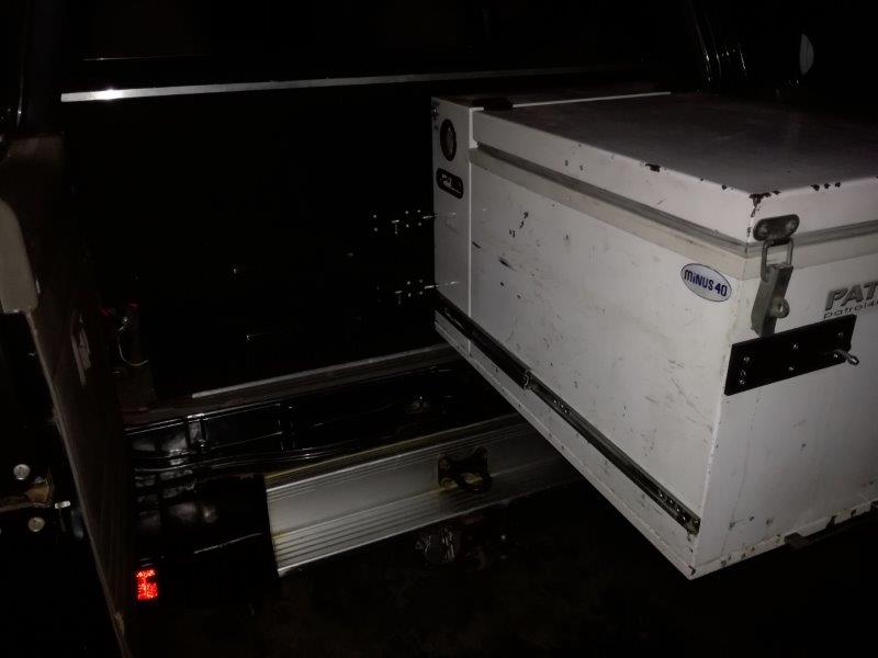

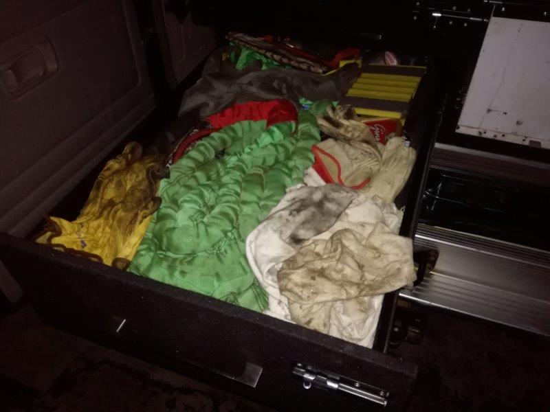

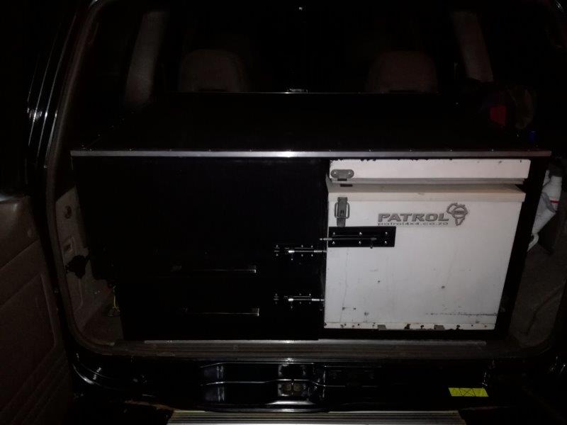

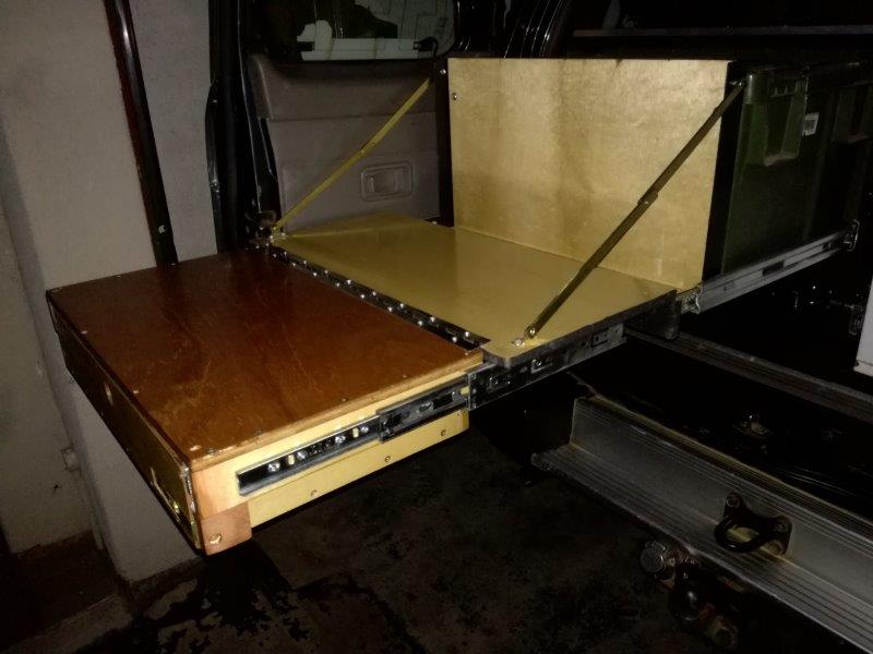

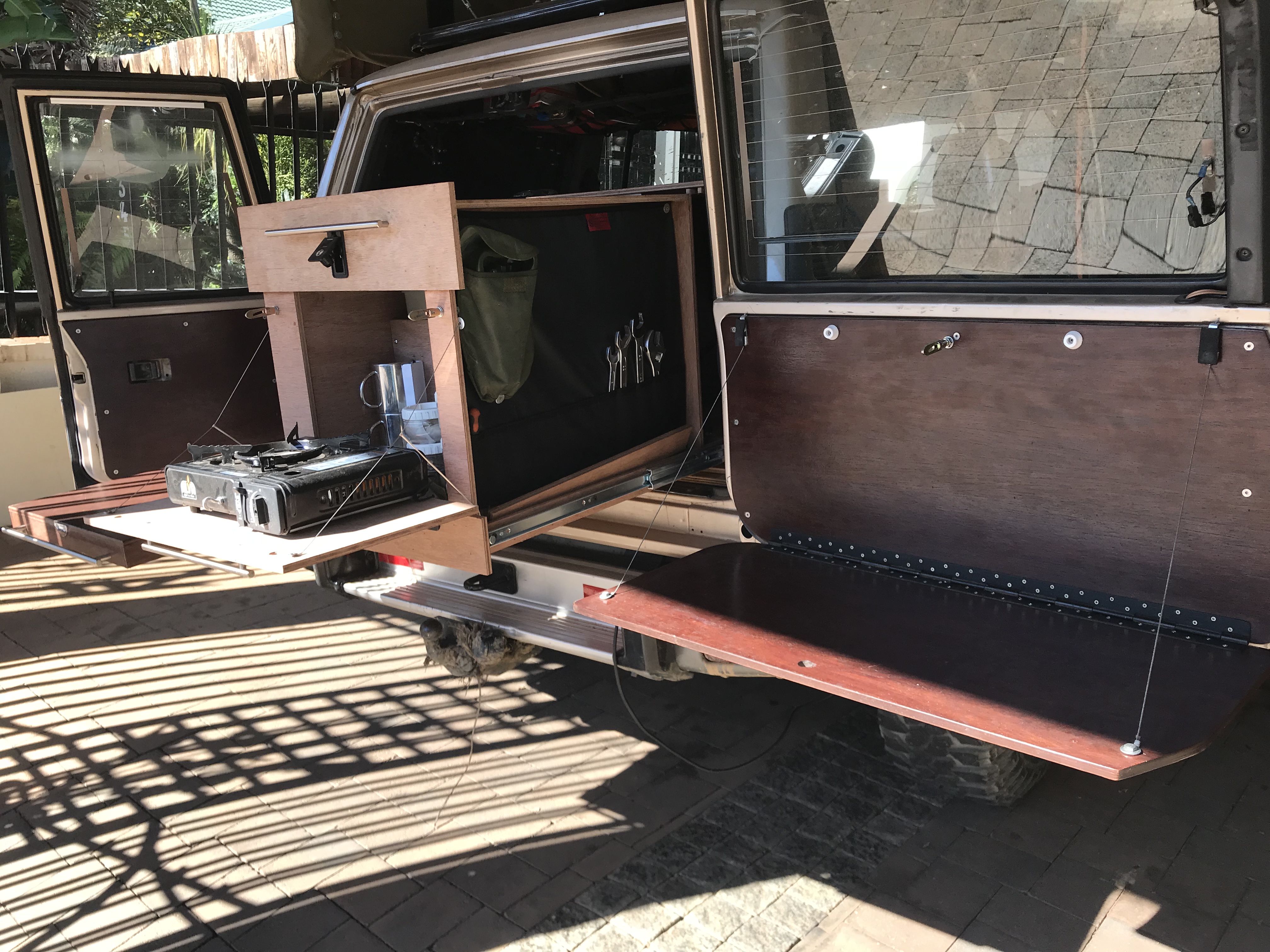

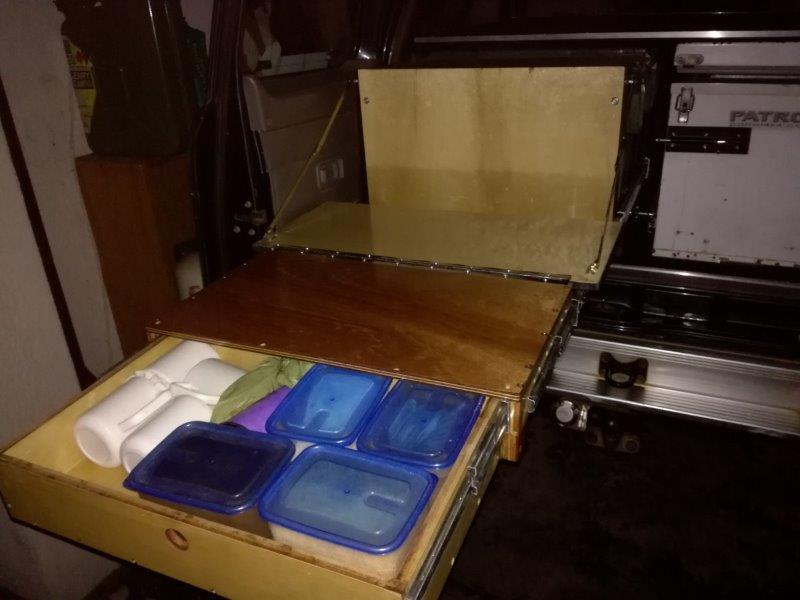

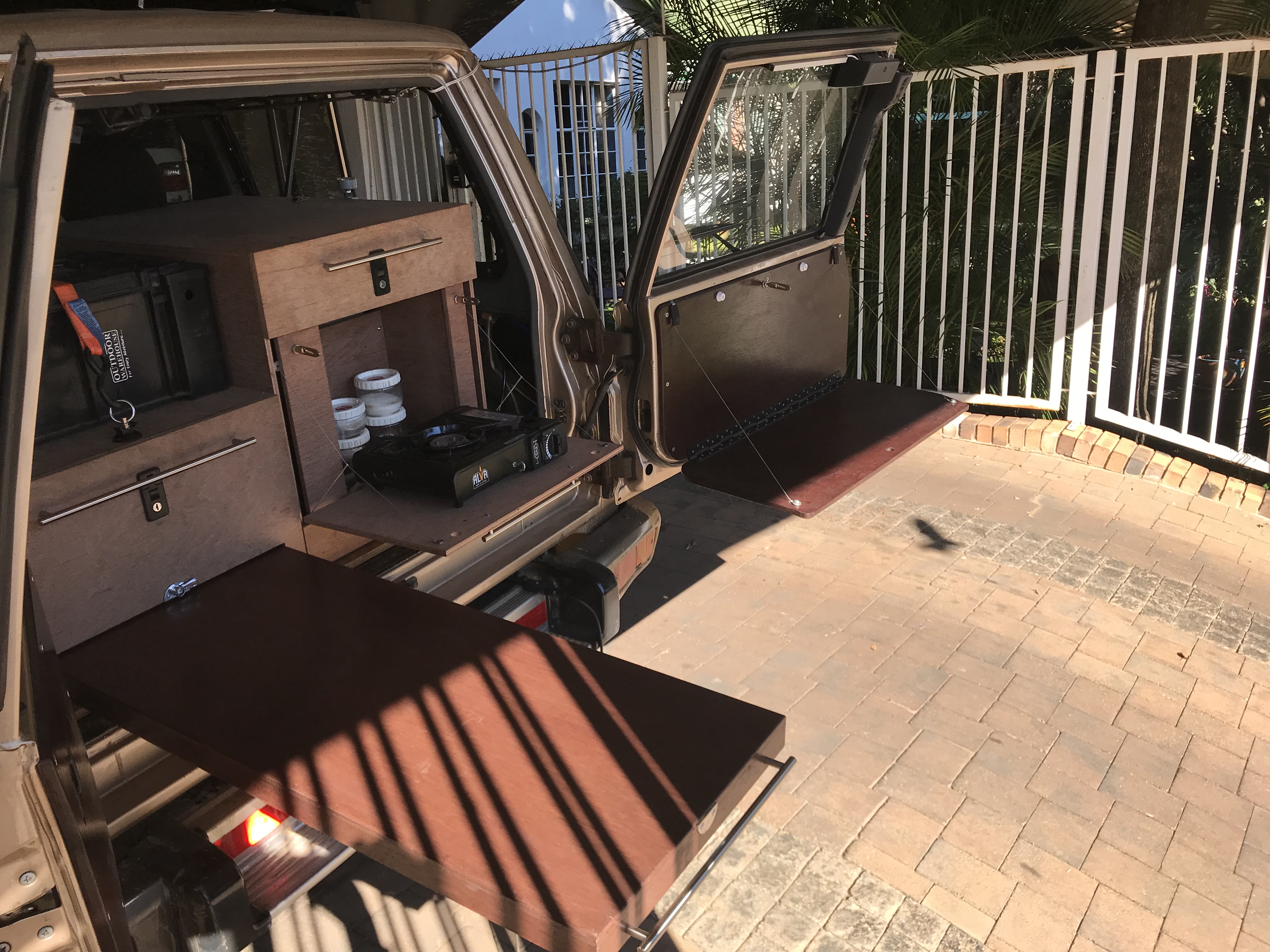

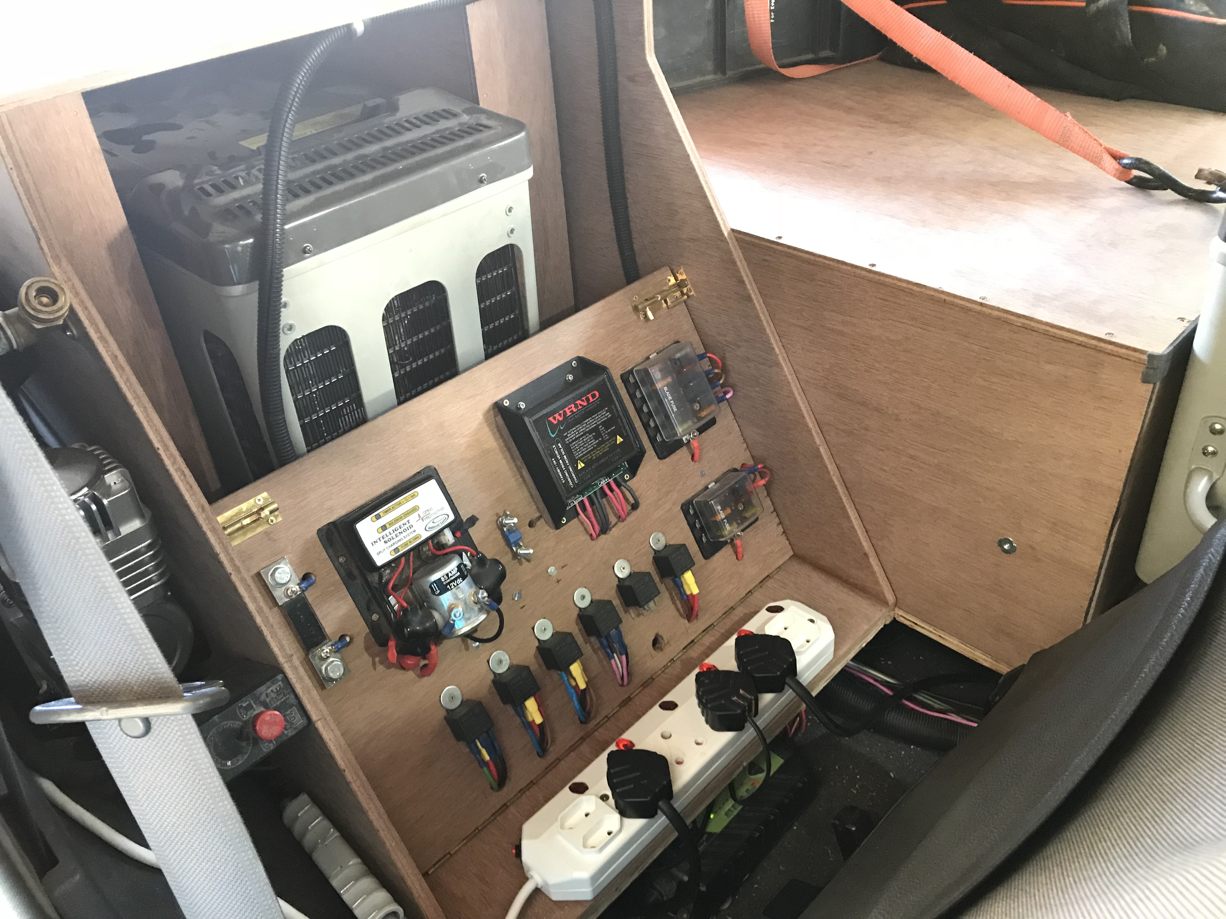

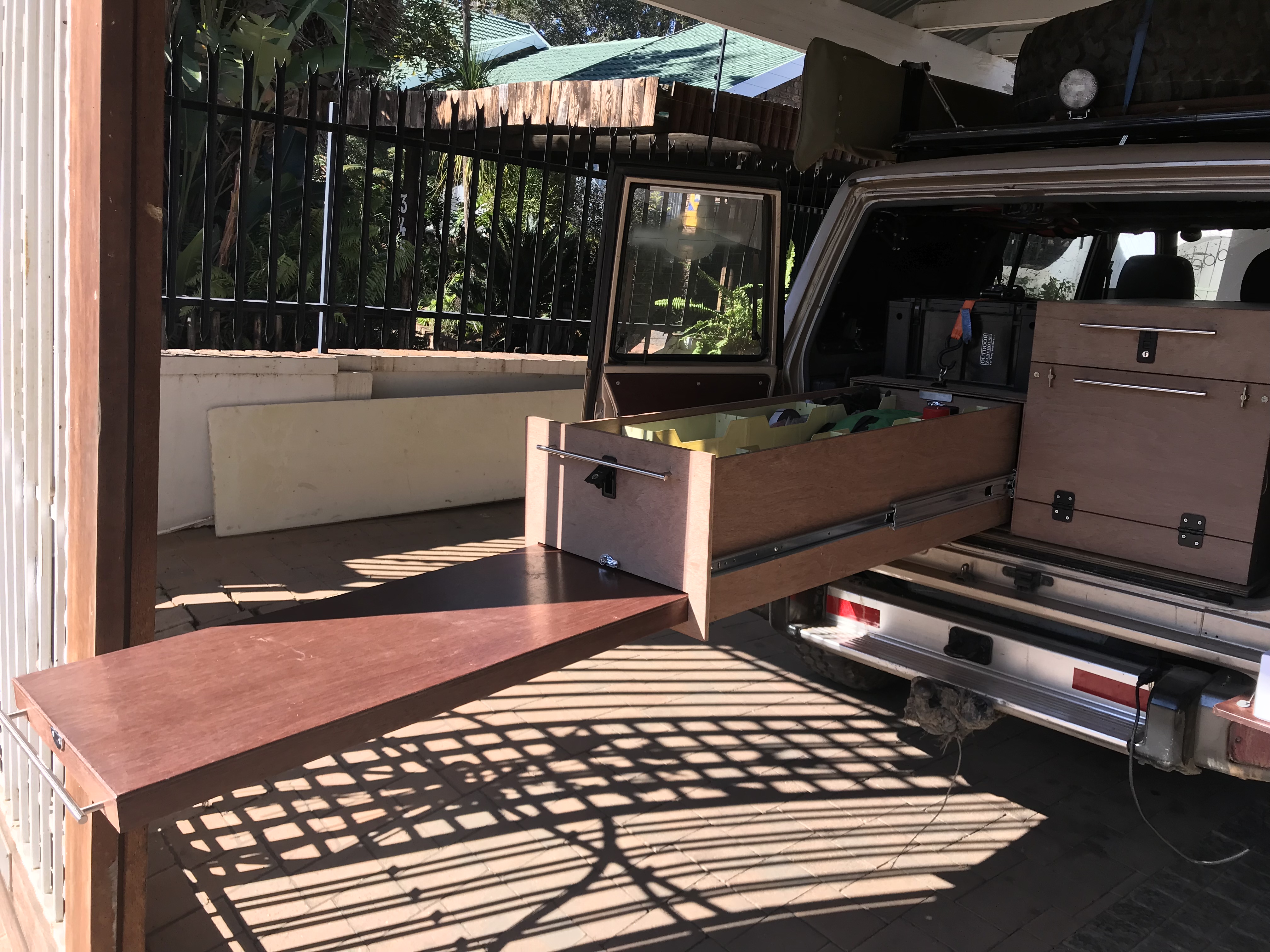

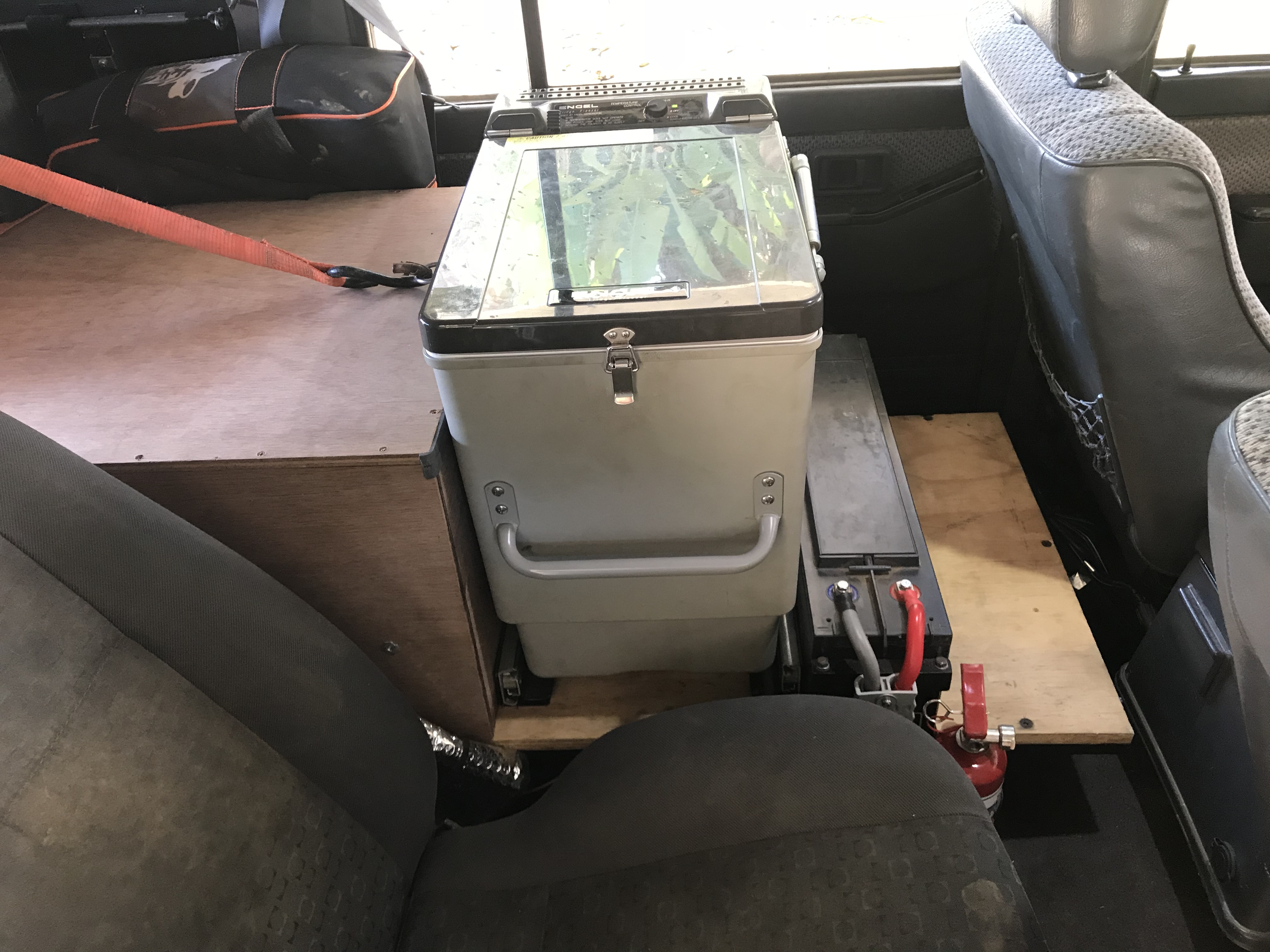

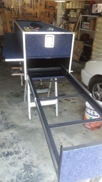

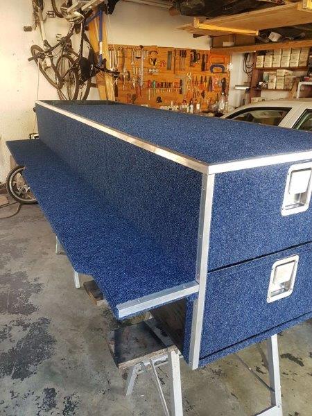

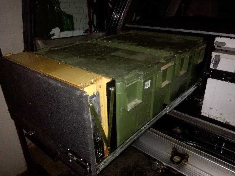

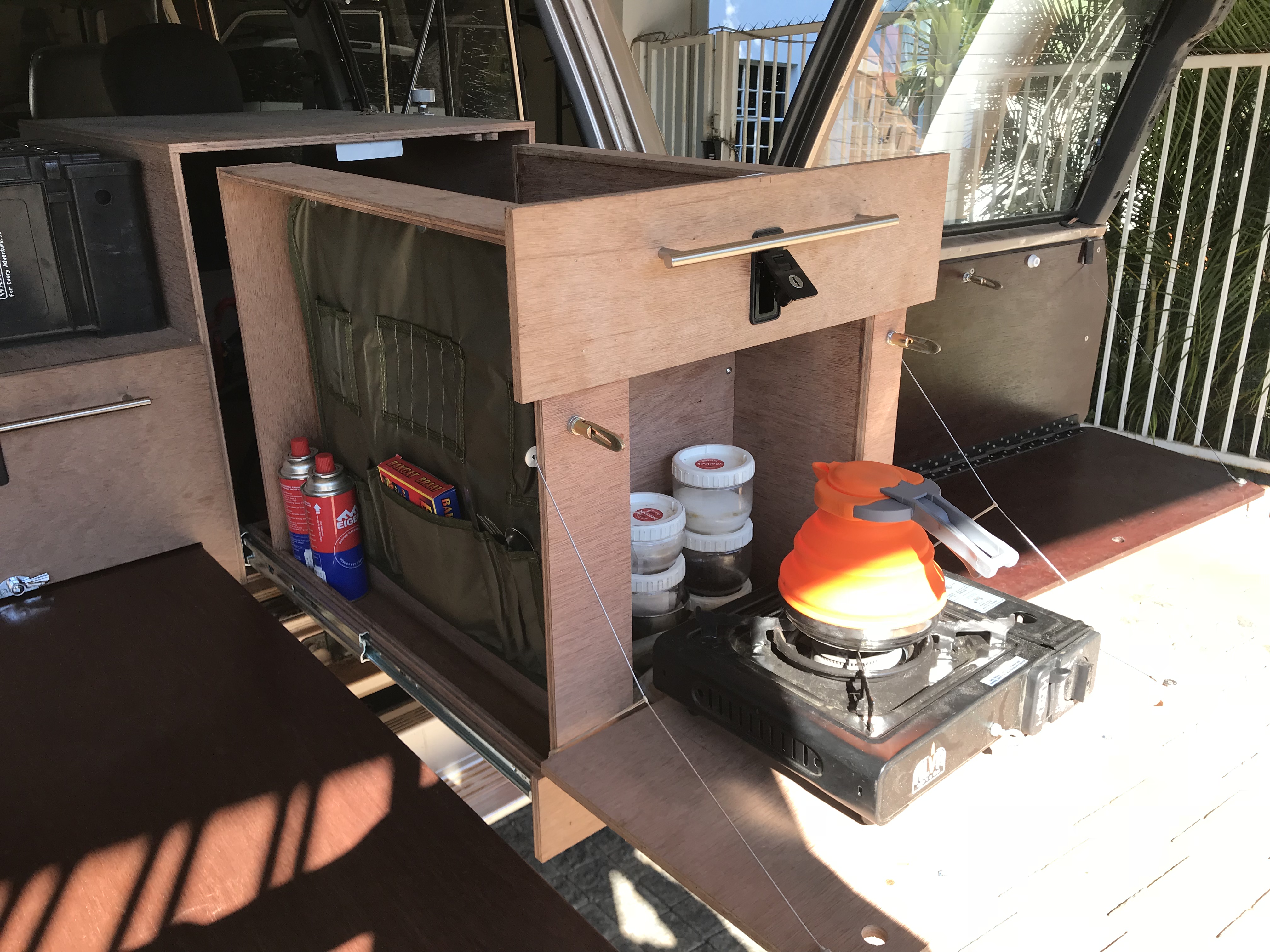

I also have a big fridge. I built my drawers to take the fridge and have a drawer for packing boxes and another for recover kit and spares. I had 100mm left in front of the boxes slide so I made a quirky little tray with a drawer for my coffee stuff. The lower fridge position works well for me and my short wife.
Sorry, the pics were taken at night.

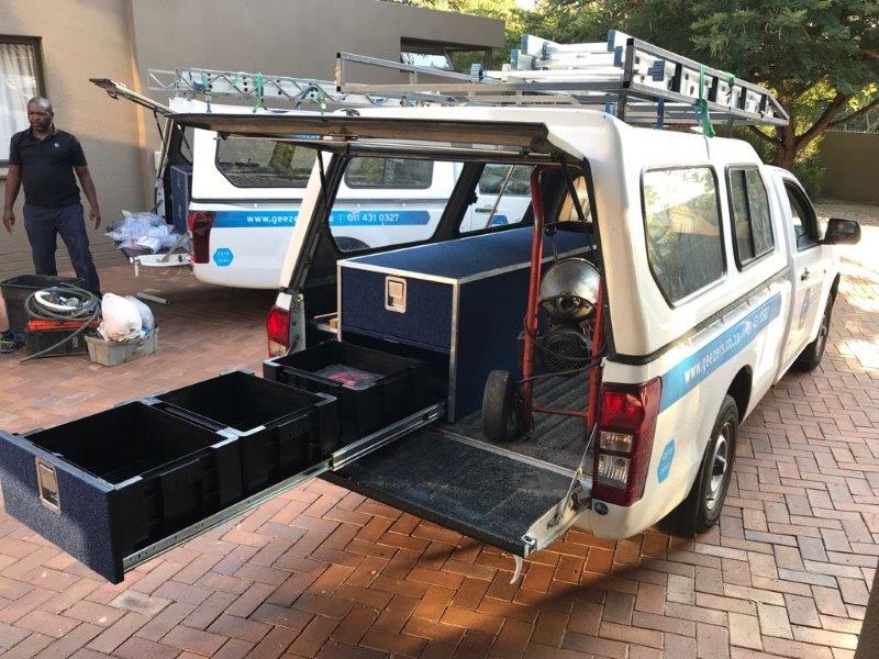

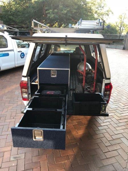

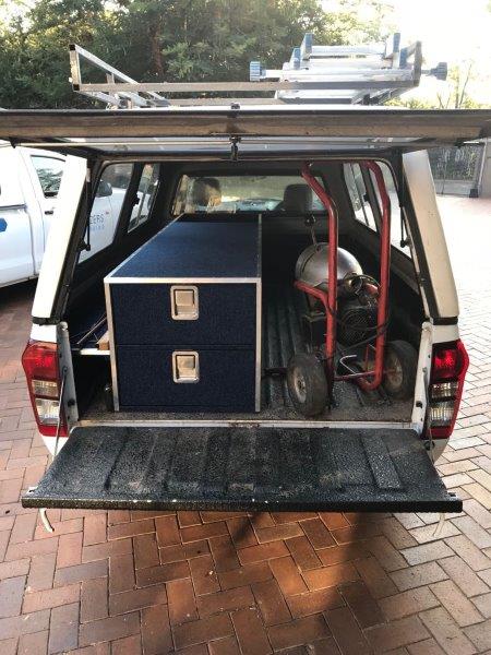

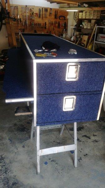

I did another custom drawer system for a plumber who wanted drawers on one side of his Isuzu bakkies. I used the longest (and strongest) available slides from furnlock. I got 8 ammo boxes into each unit with a bin at the back for larger parts.
The parts and tools to be carried were heavy, hence the huge slides. they had to be able to carry the weight at full extension. When he came to collect I told him to open the drawer fully and load his kids in the end of the slide. I covered them in Belgotex fungus and mildew resistant carpet in a colour that best matched their logo.
As Tinus said, I will be doing a custom system for Alex in "skilpad" I'll take pics once I start the build. Should be in a weeks time that I start.
- IMG-20180302-WA0015.jpg (39.66 KiB) Viewed 7593 times

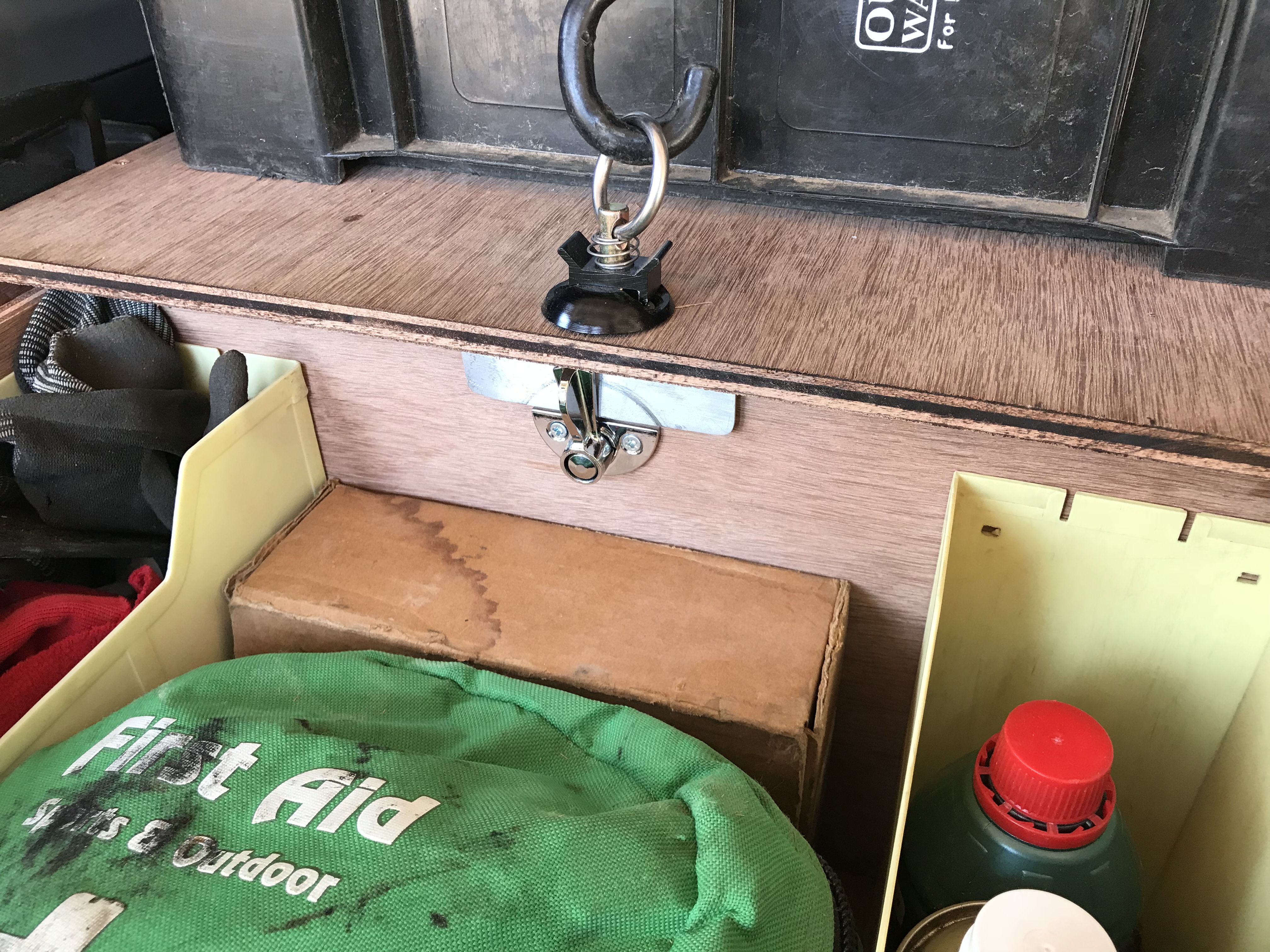

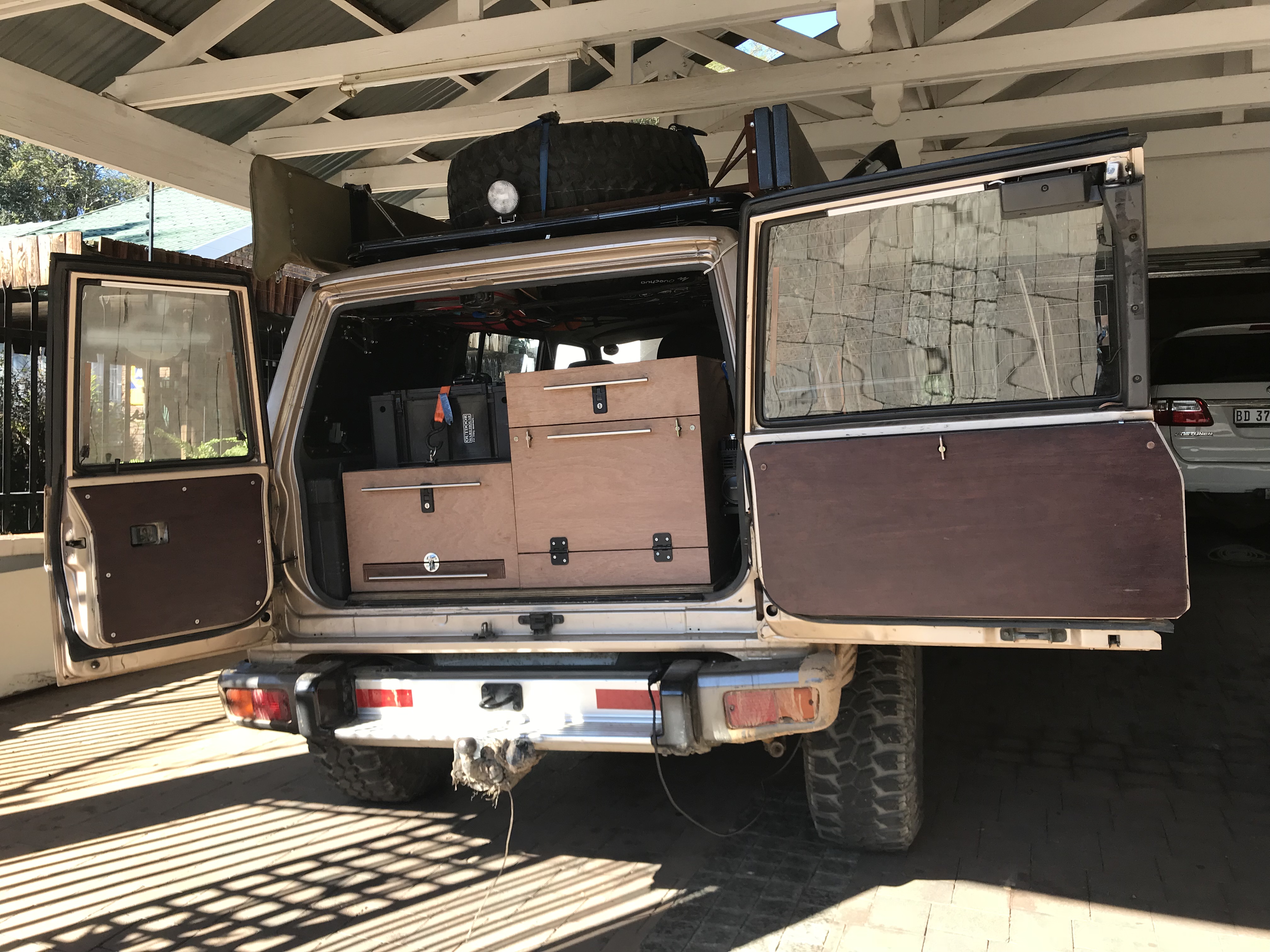

Wow Anthony, I always love seeing your work.

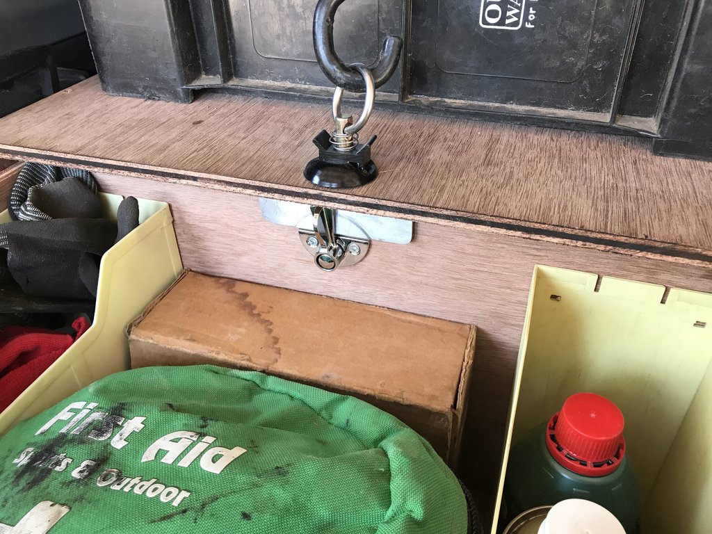

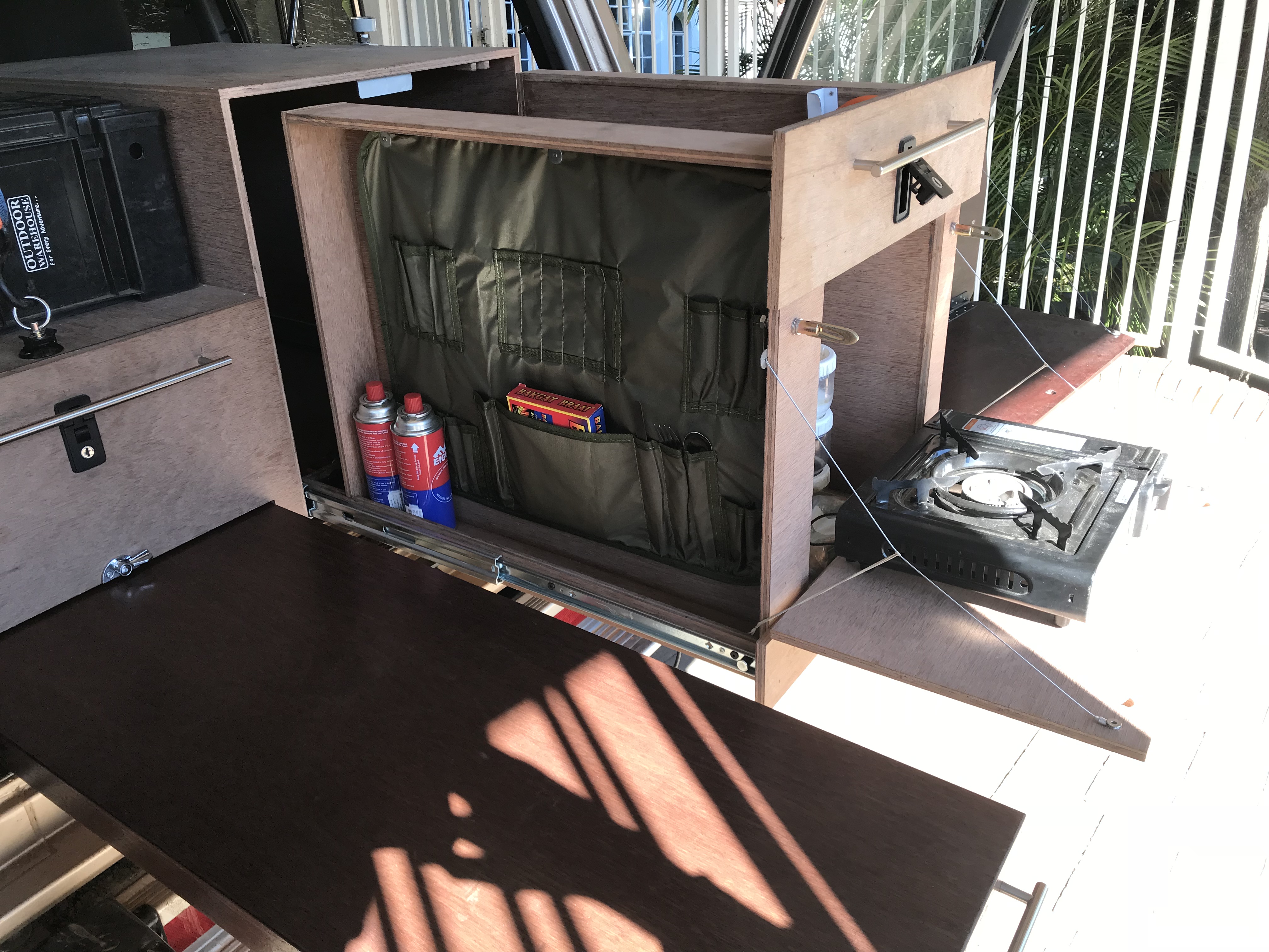

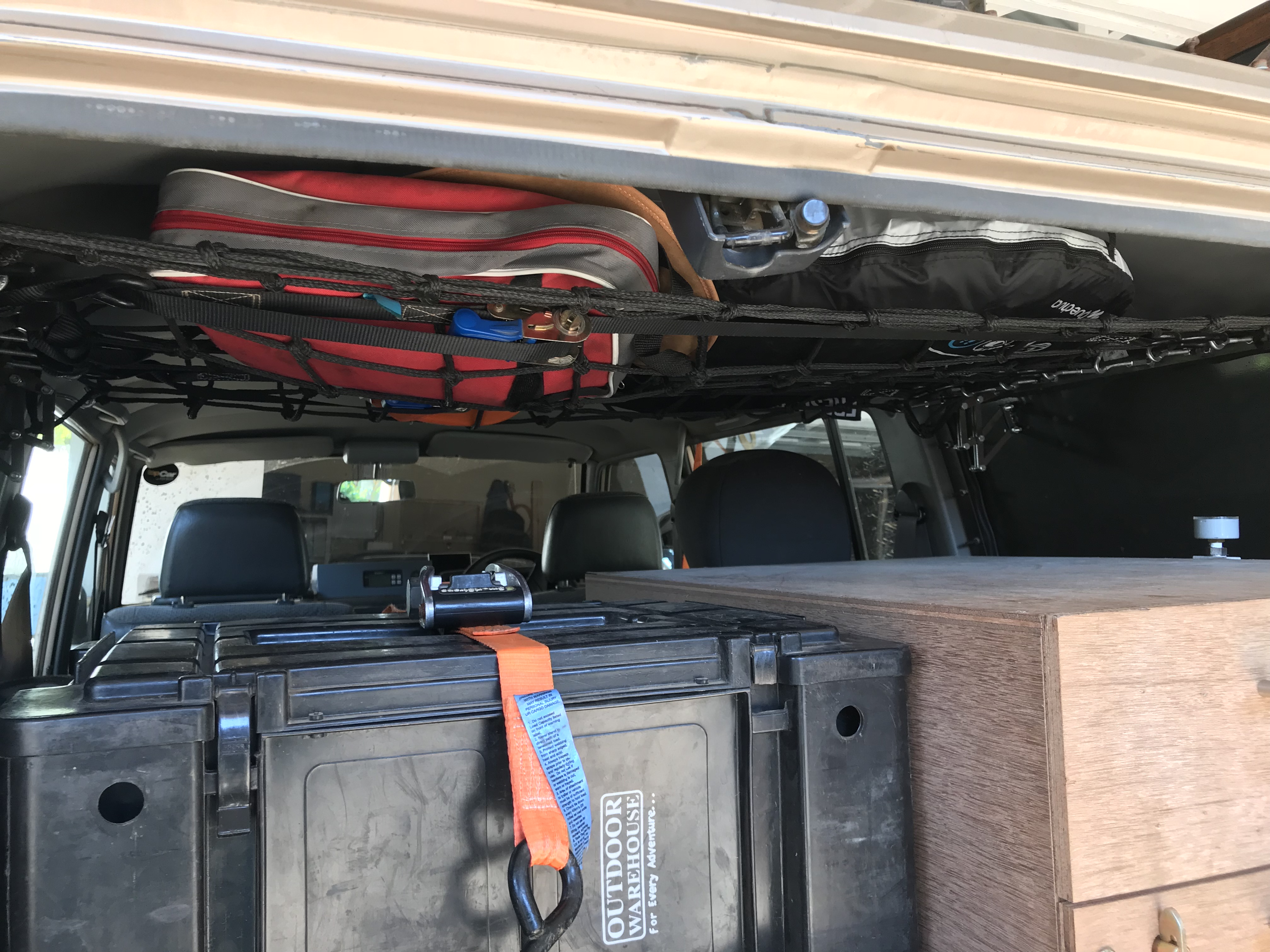

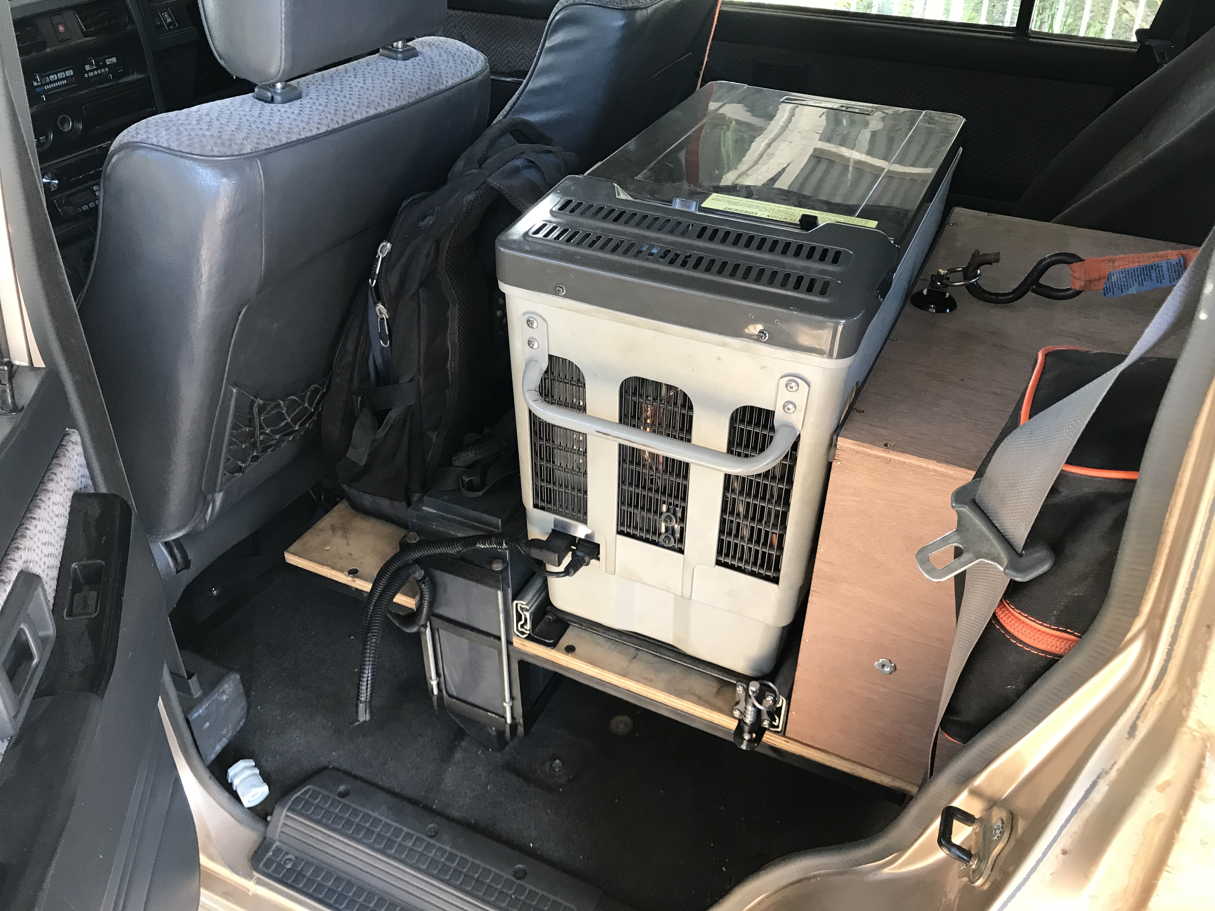

I also built my own drawers. Its not finished yet. I first wanted to do a few camps so that if I wanted to change anything I could do so easily. Will probably take them out again next year to do all the finishing toutches.
Personally I really really hate ammo boxes/Wolf packs, mostley because you always need the bottom one if they are stacked, overloading them and that their clips open sideways so. I do like the frontrunner Cub packs more if I had to choose. Their clips sit on the lid and they are a bit smaller.
I don’t recomend the locks I used. They don't handle the weight of such big drawers very well. I will probably be installing ones that Anthony used soon.
I have replaced my ammo boxes with another drawer in the mean time.
I would recommend for you also just to but three stacked drawers on one side of the vehicle next to the fridge. One deep one at the bottom an the two smaller ones on top.
