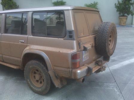

after driving into a serious donga at Groenkloof Jongosi has developed the death wobble :sad:
thank goodness for this post - I will be parking Jongosi in the garage and begin the great mend.
I have already had some LUDICROUS quotes from a number or suspension / steering shops and am taking the mantra - you break it you fix it!
On the positive note - I was out at Groot Marico over the weekend, spent the day on the dirt roads between Groot Marico and Zeerust practising my recovery skills as they had had over 100mm of rain over Friday night / Saturday morning. Thinking of renaming Jongosi ; Imvubu which means hippo in zulu :biggrin:
good looking rear-end
An ox, but with balls !!!
