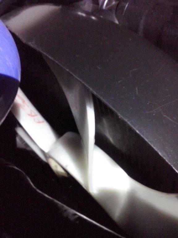

Bought Patrol Cape Town Aug 14, over net, in servicing Patrol in prep for trip to Namibia, noticed fan serious cracks on all webs, Nissan no stock, delivery 4 days @ ZAR 2,100.00, found over counter fan at Auto Cooling Solutions for ZAR 500.00, fan working fine no overheating :thumbup:

Please give Fan diameter, number of fins and does the pitch compare to std
Re: Radiator Cooling Fan
Put a picture :clap:

Did not measure outer diameter, i took off the original fan and put up against the new unit OD, Pitch and 7 Fin Blades exactly the same except the recess on the fastening point to viscous was 5mm more deeper than the original, the 5mm made no difference, at first i thought might touch radiator, but did not. If you really need diameter i can get a caliper tomorrow and measure, please let me know.

Tinus lotz wrote:Put a picture :clap:
I took some pictures a couple of minutes ago on my cell, will send tomorrow my cell USB cable at work.

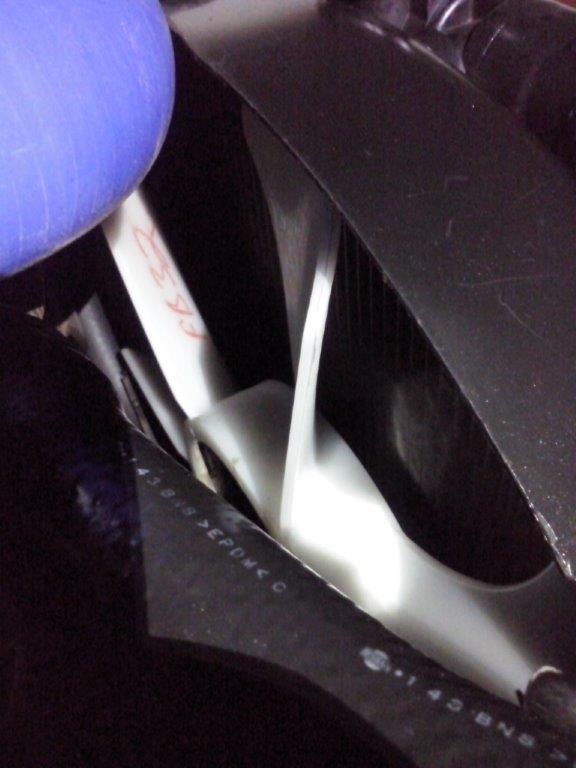

As promised a picture :oldtimer:
