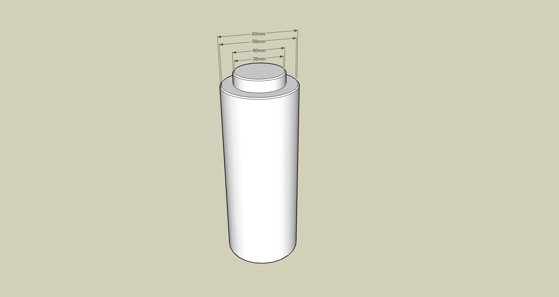

Tell me the measurements .... as I guessed these ones, and I'll change my sketchup model

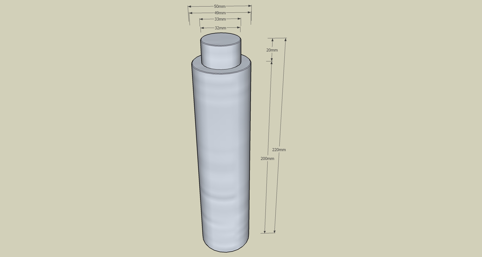

I actually use cad for a living, but in this case I just made quick hand sketch for the machinist at the lathe :redface:
I used 50mm BMS bar and the turned down section must be 33mm, about 15-20mm long. The bar needs to be about 200mm long if you want to install the seal with the knuckle in place, otherwise about 100mm long should be good enough.

Updated sizes for the tool

Cool thanks for the tool sizes :thumbup:
