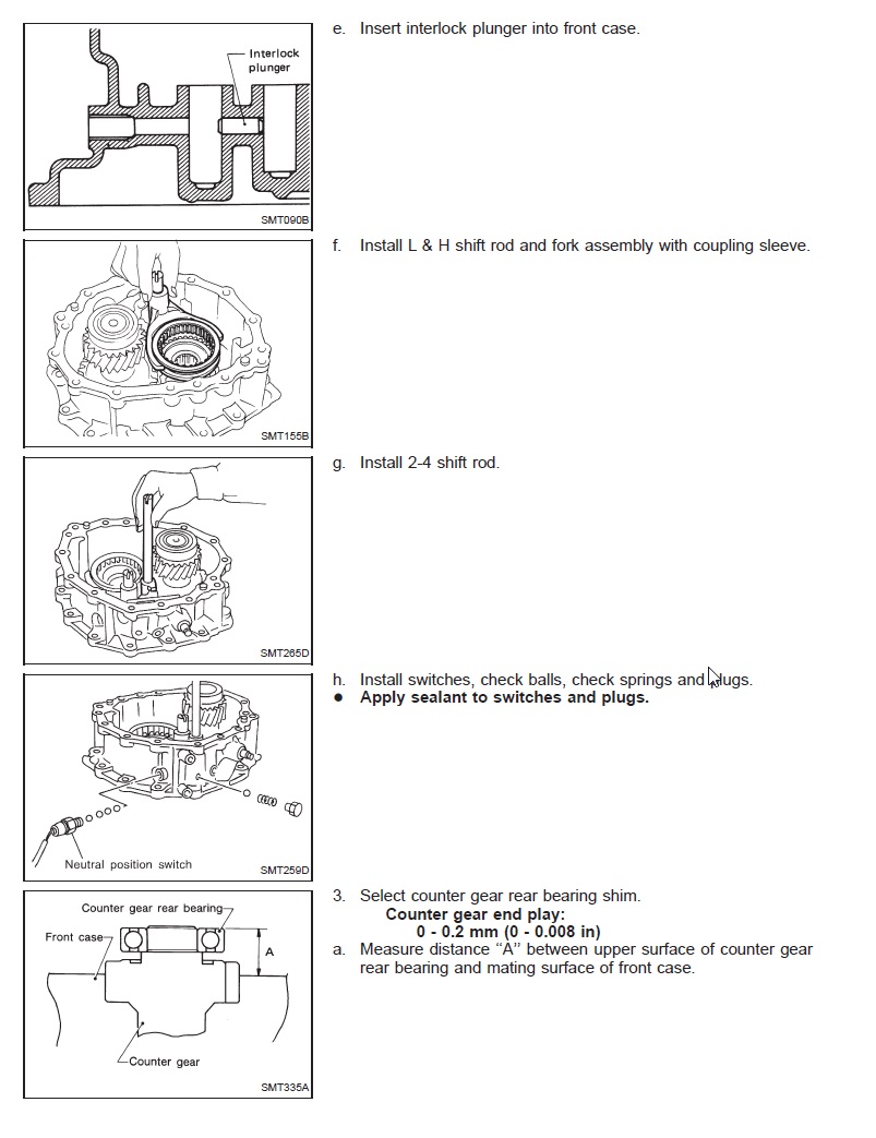

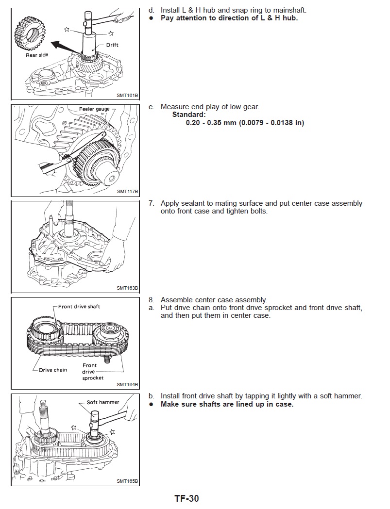

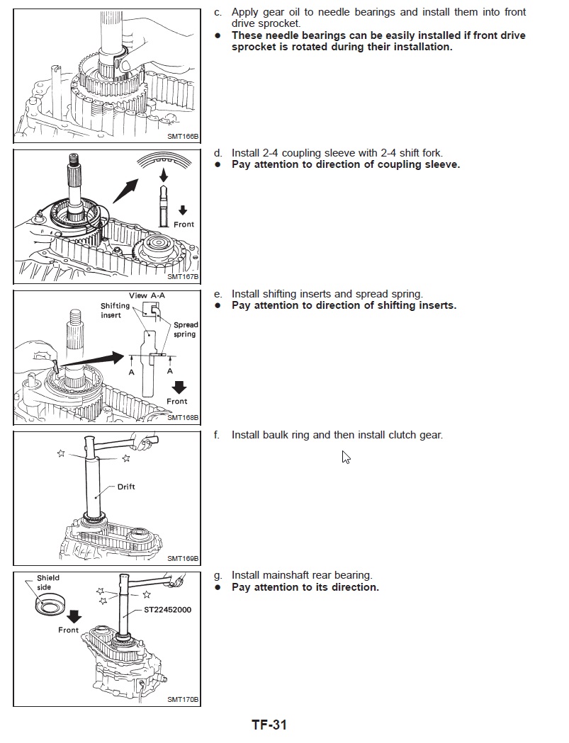

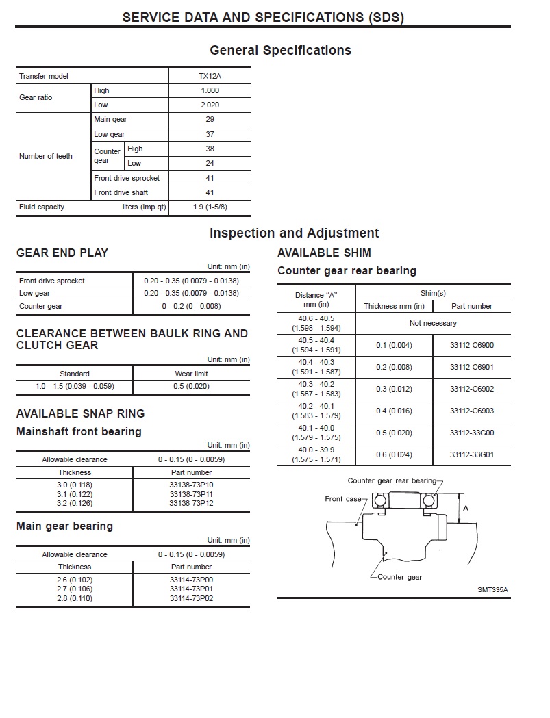

Had a request from Tim in Windhoek for this info ...
Hoop jy kom reg Tim :thumbup:

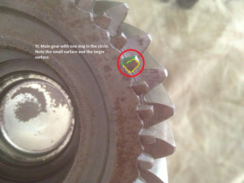

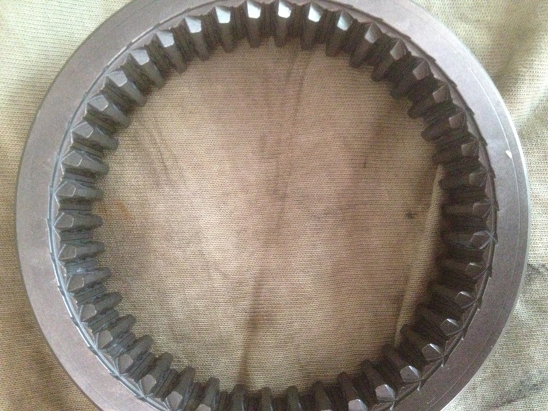

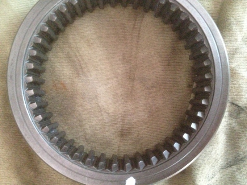

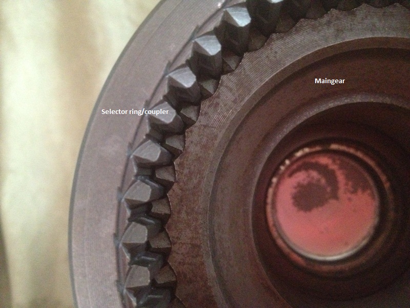

At this point it is not very well described what the orientation of the TC main gear coupler is. This coupler is located in the mid section of the transfer box of the TB45 GU and switch between the TC main gear and TC low gear. From the pics it can be seen that the main gear as well as the coupler has a different dog gear "pitch" one surface is somewhat larger than the other. I'm not sure about which side should match up with which side when the coupler is shifted on to/over the main gear.
There can obviously be only one CORRECT way in order not to damage the maingear dogs.
Thanks
Tim

Tim, getting back to the subject:
Please note that I am not a transfer case expert, and have never opened one of these.
But it would seem to me to make sense if the dogs are arranged in order to favour changing from low to high.
