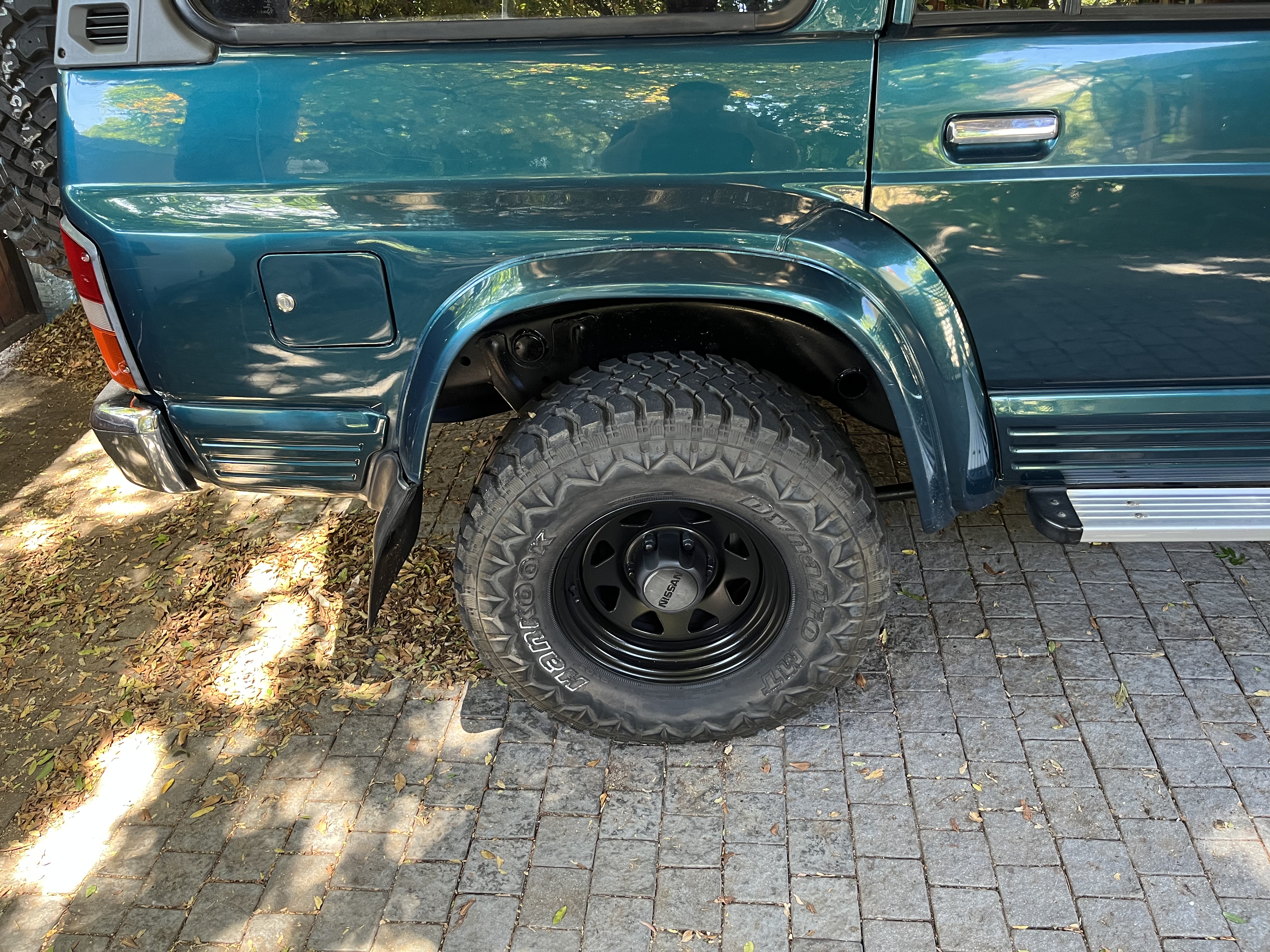

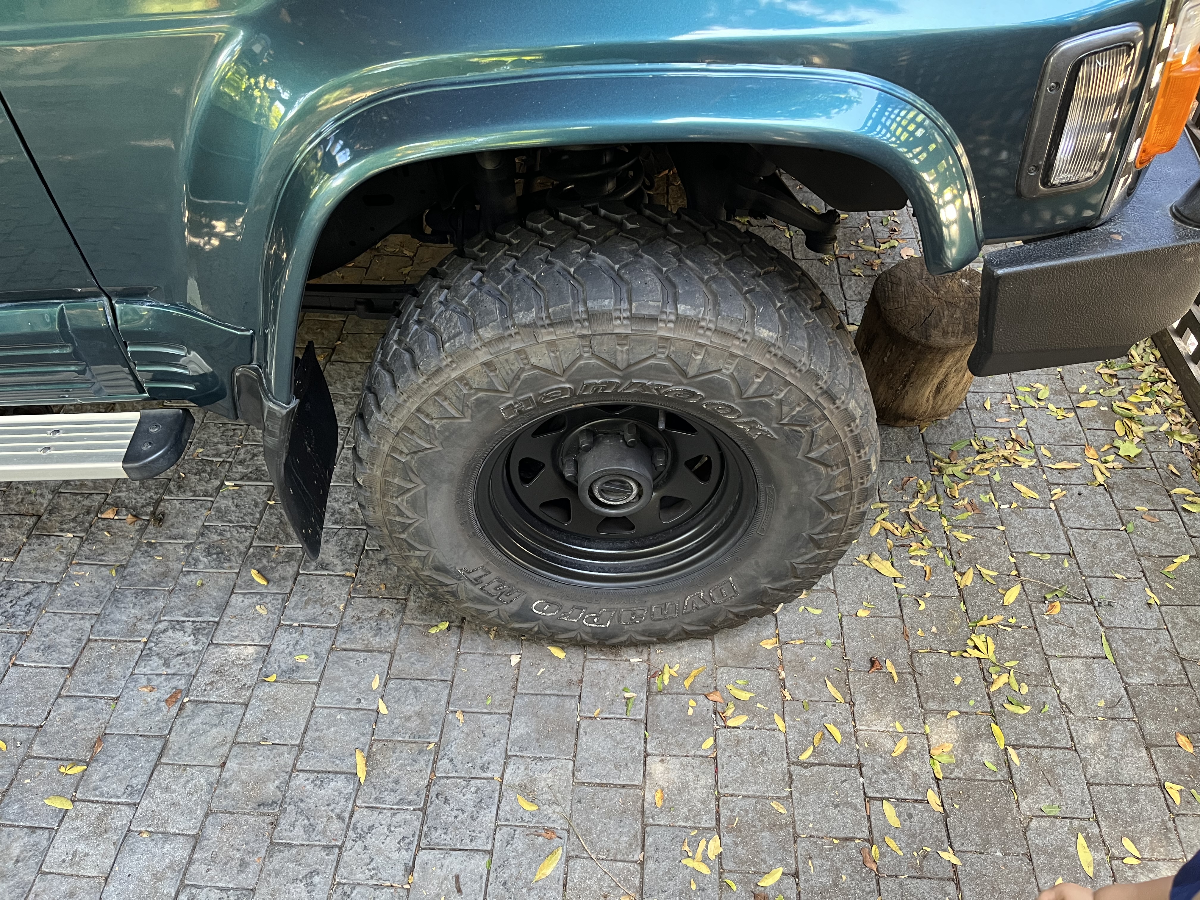

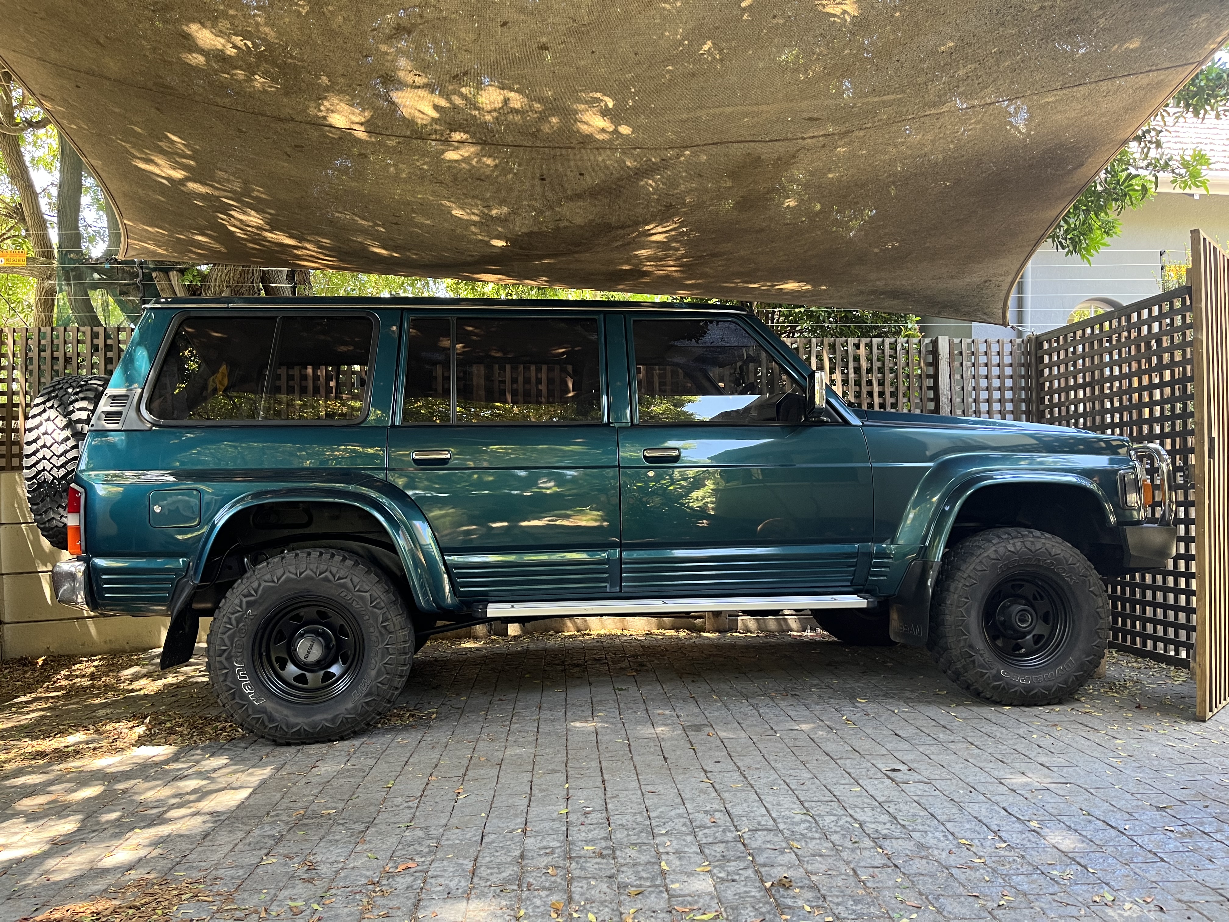

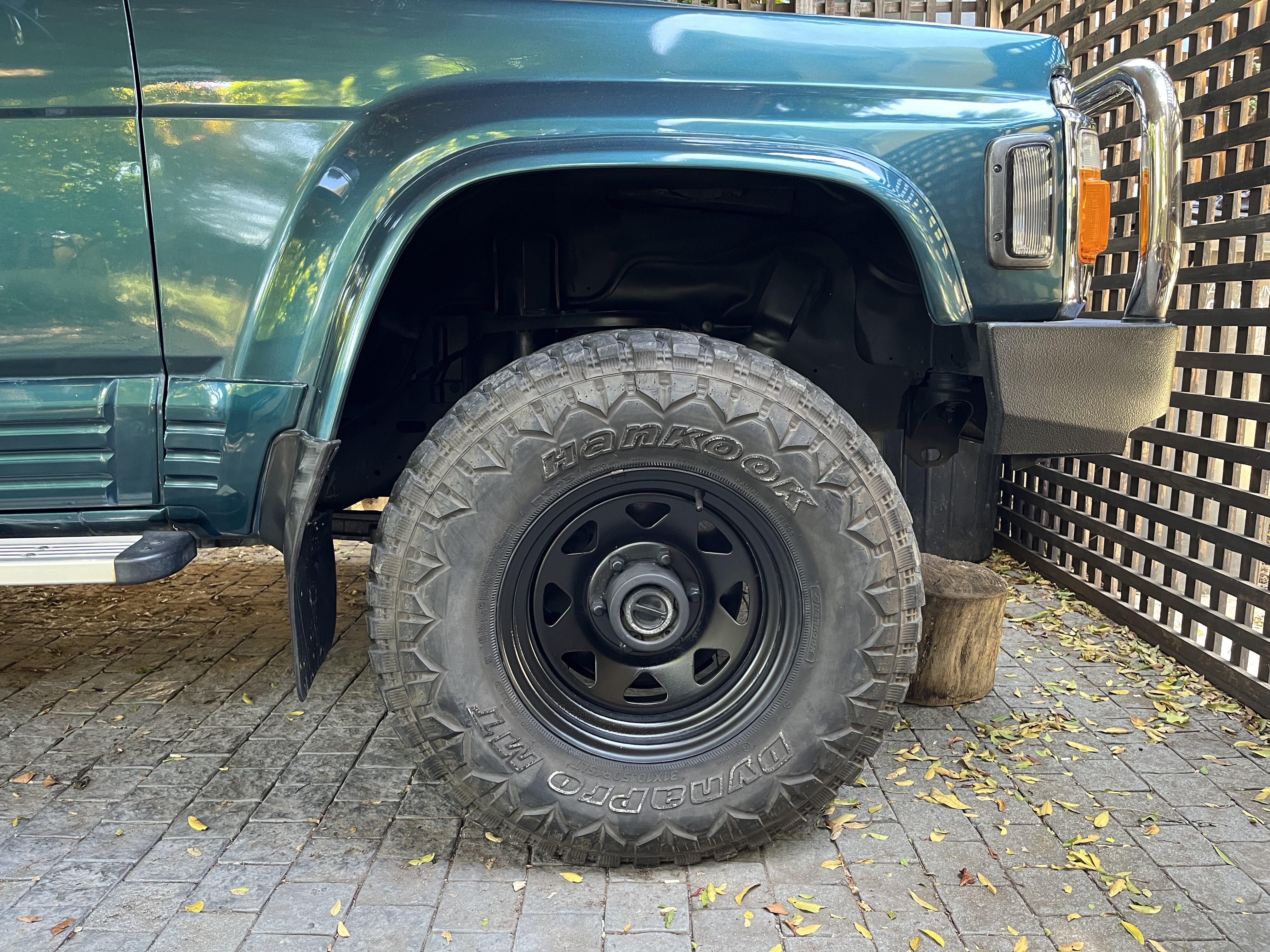

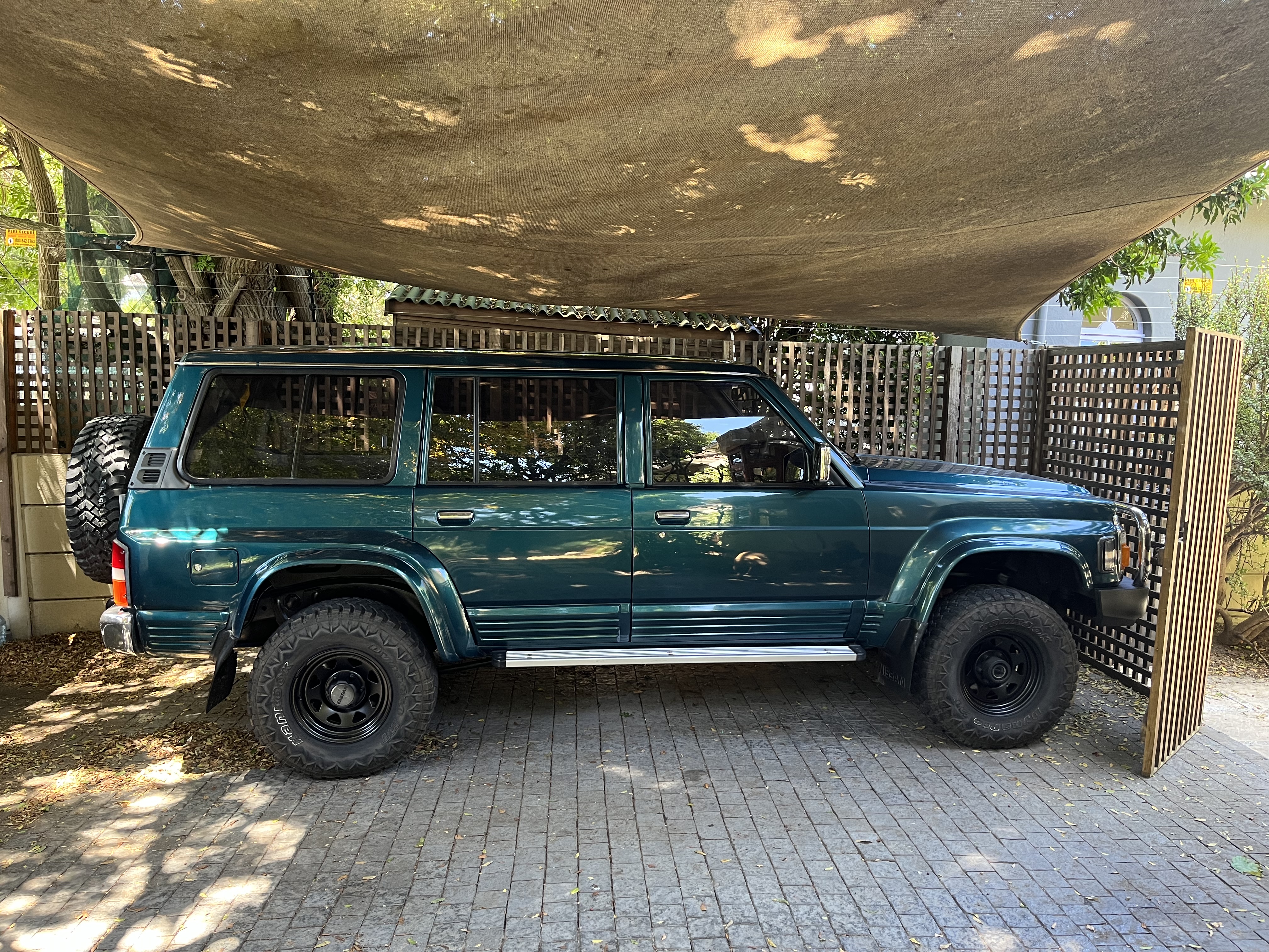

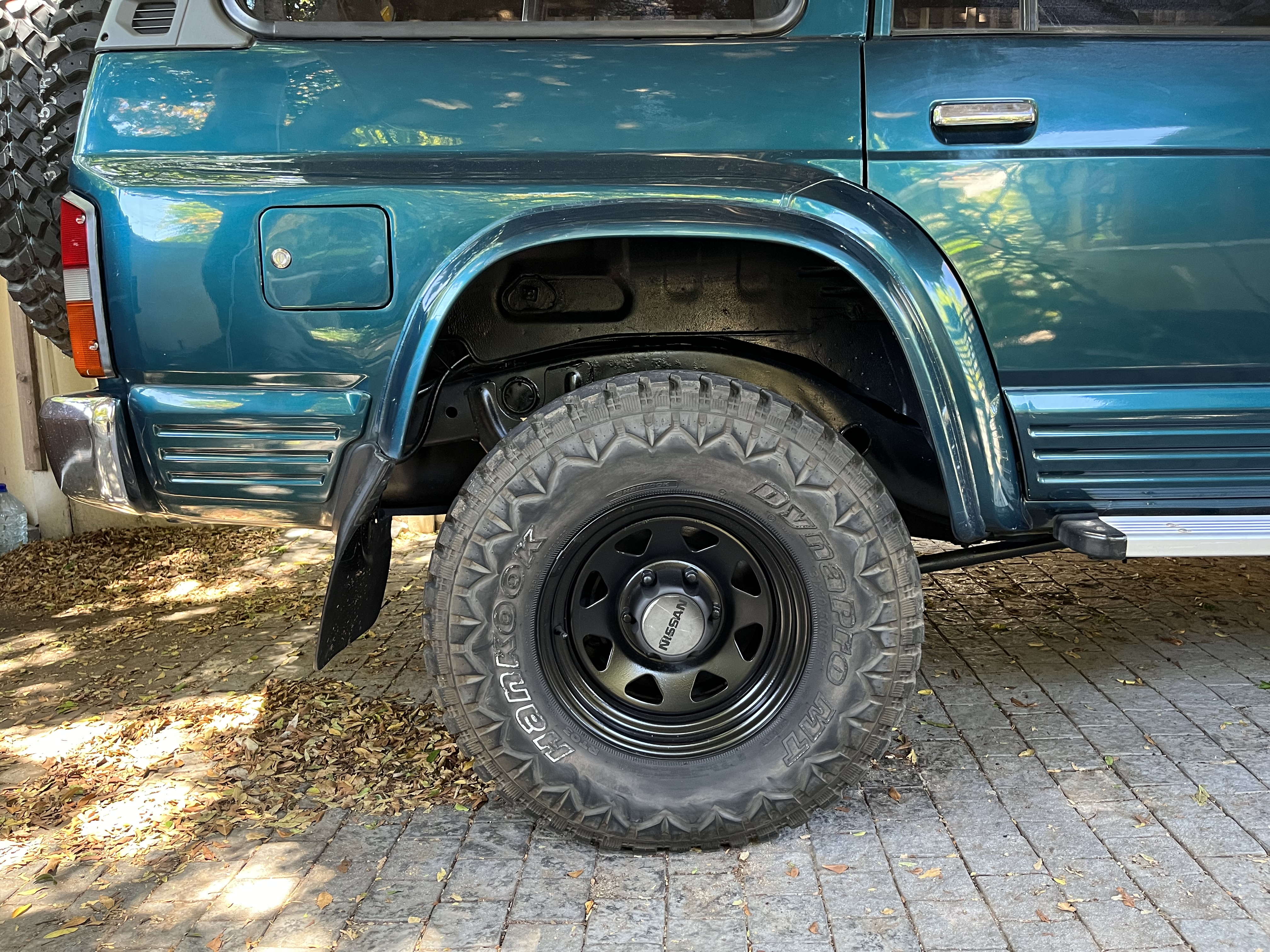

Sorry, just went to look at the pictures of your car again.
Looking at it's stance, you alreary have 2-3" of lift. Probably closer to 3 than to 2. So unless there is something wrong with the way the car rides, I would just keep the springs and shocjs as they are.
If the rear springs are constant-rate, then the Terrain Tamer progressive rear coils will improve the ride.

I definitely think my car has a lift, maybe around a 2" ( I doubt 3), which is a little disappointing as the car seems low even with a 2" lift. My Pajero with a 3" lift was substantially higher with more clearance :surprised:
With that in mind, I definitely think I would at minimum want to go 3", as mentioned, possibly add a 1" spacer after if needed.
Also the way the car sits in terms of castor makes it look lifted.
I understand the GQ's are pretty low standard, very much have that wagon/station wagon look without a lift. It's also surprising how it seems 33's would just about fit with a 2" lift, no bigger. (would like to keep the arches as they are, no cutting), don't mind getting rid of the mud flaps.

How the car sits at the moment (driveway is at a bit of an angle :rolleyes: ):

With regard to lift, I think the workshop manual has some dimensions for the gaps between the axles and chassis. Don't have it on my phone. Much prefer that to measuring to the body.
But yours still looks like about 3" to me.
