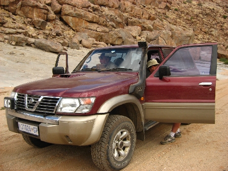

I like my Safari because it let me do this (see pic below) for a month....it's VERY important to go through the whole system though...the moegoes who installed mine did a shocking job and it wouldn't have kept out a cup of tea. I had to get to all the joints and seal them up properly. If you have a TD42 then you need to block off the dust vent at the bottom of the venturi under the bonnet. It's a small rubber nozzle hidden under the big black steel venturi on the front left of the car. It's an absolute must on any Diesel engine....I spray my engine and body with Fluid Film before I go on a trip...it's VERY hydrophobic and did a great job on our soggy trip through Zambia and Bots last year.
I don't personally like the looks of the TJM and I like that Safari Venturi Head system like Ross has on his Patrol. The Safari hasn't made any noticeable difference to wind noise, but it does increase the engine noise with the passenger window open. If you wash your car after you have a trip then the problem of having sticks/stones between the body and the snorkel is minimal. That being said I've never had that problem.

Hello SRXy
You are spot on with the snorkel that need to seal properly.I dissagree on one thing thou.That rubber grommet on the bottom of the airfilter drum,I will keep it open.That "valve"get rid off heavy particals and water.I see your snorkel face back on the picture,or it look like that,that will keep the rain out.Or a big splash off water over the hood.That rubber get rid off water that might enter the system.It also should shut if water enter the enjine compartment,and if not it has to be replaced.If water find its whay through the rubber,it is not enough to damage you enjine.
