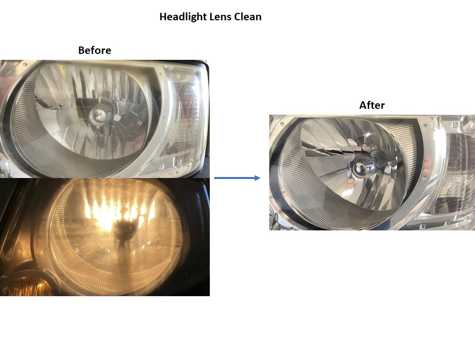

Did a quick DIY on my headlights last night and thought I'd share the experience. After my bad HID experience a few years ago I was reluctant to tackle this upgrade, but after cheking a few posts on the forum and advice from Ant (thank you), I ordered an LED replacement kit from 4x4 direct (H4 LED headlight kit).
1. Firstly, I used a bit of brasso and buff on the lenses to clear up the cloudiness. 10 min job. This made a big difference, see below.

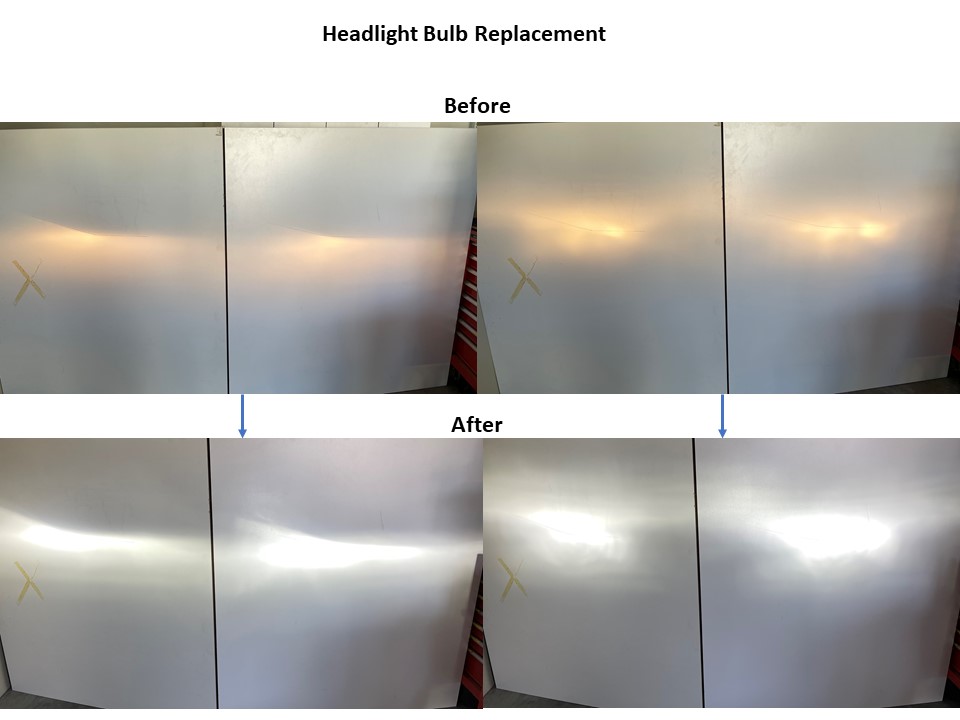

2. Secondly I replaced the bulbs. Was very straight forward, except the 5 minute job turned into 10 minutes because the heatsink is so large it's difficult to get clips back, but I managed to to it with 2 screwdrivers after a few attempts. So, no need to remove the headlight.
In summary, after my first drive early this morning, I'm very happy. The light pattern mimics the orginal as shown in the pics.

I replaced mine with LEDs a few years back. It required some fine-tuning afterwards (downwards adjustment, mostly), but it does make a big difference.
Re: Headlight Bulb Replacement - DIY
Yeah, it took a little time to find the right globes, and the to set the beam levels took a little time, but it definitely makes a big difference. What I really like though is when I put my brights on, with my halogen KC spots you get a nice mix of white light and yellow from the halogen. These 2 colours actually compliment each other making visibility exceptional.
