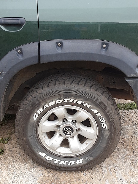

I got the Dunlop AT3Gs I was considering here:
viewtopic.php?p=116912#p116912
I went from 285 to 265 width to save some money. I was surprized by the amount of increase in power to the car.
Off the bat, the tires are deflating nice, and interstingly I have a softer ride at normal pressures over speed bumps, potholes, and gravel roads.
One thing I hated though, is the protective green/blue tire chalk on the white lettering! I've read elsewhere people struggle to get this off, but sweet cheeses it's ridiculous. The shop guy told me it'll wash off "with a bit of water and soap", so I asked him to wash it off while he was fitting the tires. He tried for 5 minutes then gave up. After several weeks and no fading, I tried various soaps, boiling water, brushes, and an eraser :rolling: . I found paint thinners worked in the end. Yes, I know it's bad for rubber. Still, it took me 1-2 hrs to do 5 tires with thinners (granted by then I had a beer for every swear word I had to keep from uttering). If I ever buy a tire with chalk on again, I'll insist they remove it before I pay.
Cost per tire was R3,835 incl VAT.

Good evening Dion.
They are great tyres, I also fitted a set recently, not to my Patrol but to my Navara and it still has the blue stuff on, i washed it a bit and then just left it and thought I will give it a go again with stronger soap when I have time but clearly its not that easy then. I fitted Lt265/65/17's and paid R2200.00 inc each. I got a Price on the 16" ones also and they where R300.00 more per tyre.
When they finished fitting the tyres and I inspected them I saw they fitted only one Lt and the rest were normal 265's when i showed it to them they played dumb or maybe were really clueles. Then they tried to convince me they are the same etc. When i did not want to except that they just wanted to swap the Lt for a normal 265 but i did not want them as I paid for Lt's and thats what I wanted to fit. I ended up spending half the Saturday at the place as they did not have any other Lt's so had to get 3 from another branch. I think they did not expect that I would know the meaning of the codes and index numbers etc, they got a bit fed up with me.
I think because most people don't know all that details they often sell people bakkie tyres or 4x4 tyres but they are actually tyres for a soft roader suv etc. that just looks the part and are not always suitable.
Dewald

Hi Dewald,
Thank you for that comment.
These are 265/75/16.
You know, these are not LT. I asked for LT, and the shop owner told me that there is only one version of the tire and it is basically an LT but not marked as such. I'm going to double check his statement with Dunlop and see what they say.

Its a pleasure.
Yes i saw they are not Lt's, but they are still very good as their 116T load index is 1250kg.
I think in the 265/70/16 is also a Lt, not every size of them has the normal and Lt version.
These ones we have on with the white leters on the side walls are the latest AT3G's (WLT) they only have a two ply sidewall but its still a strong sidewall tyre.
The original AT3G was the one with the 3ply sidewall, They were not available with white letters, just plain black, they are now called the AT3Gm still 3ply and black only.

Yes, I see on Errols Tires online that the 265/70/16 is available in LT, but not the 75s. I just assumed everything had an LT equivalent. But like you said, no. But I mailed sumitomo rubber to be sure.
Errols pricing is consistant with the price difference between your tires and mine, in that the 75s in normal rating are much more expensive than the 70s in LT. Eish.
I had planned to get the 70s in LT but then changed my order last minute on the phone to 75s to retain some advantage in clearance lift. That's when the dealer told me not to worry about the LT story. Hmmm I'll pay more attention next time.
But like you say 116T is not a disaster. We actually have the 3ply sidewall version on our other patrol (fitted 2.5 years ago in R15 size), in LT, and that only has a 109S rating!
Thanks Dewald.
