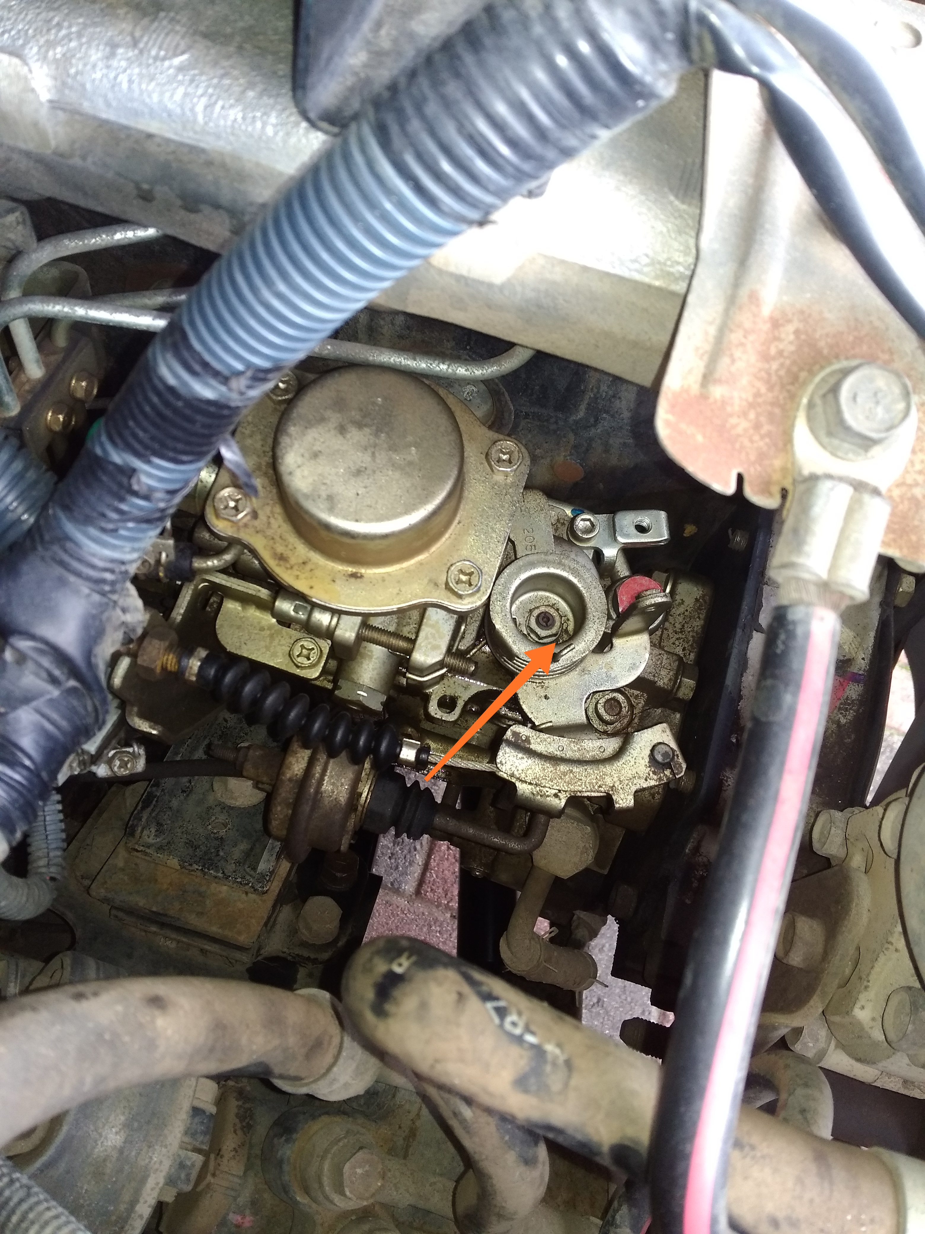

Hey Chaps
I am having my 2007 NA TD42 diesel pump rebuilt at Constatiaberg Diesel. They have had the vehicle now for 10 days and they say they cannot find a replacement Throttle shaft unit anywhere. This is where it is still leaking. The pump is a Bosch pump number 104760-7050. Anyone know where spares can be had?

It Appears that there are no spares for my Bosch Pump model anywhere in SA. Tried Frans's guy, Michael and every Diesel place I could find. Solution was to re-sleeve the pump housing\cover to get Shaft to sit tight again

The diesel guys in Constantiaberg sorted the top cover by re-sleeving the throttle shaft "hole". No more leaking and so far all good. After the re-build and calibration the old best seems to be a bit more responsive.
