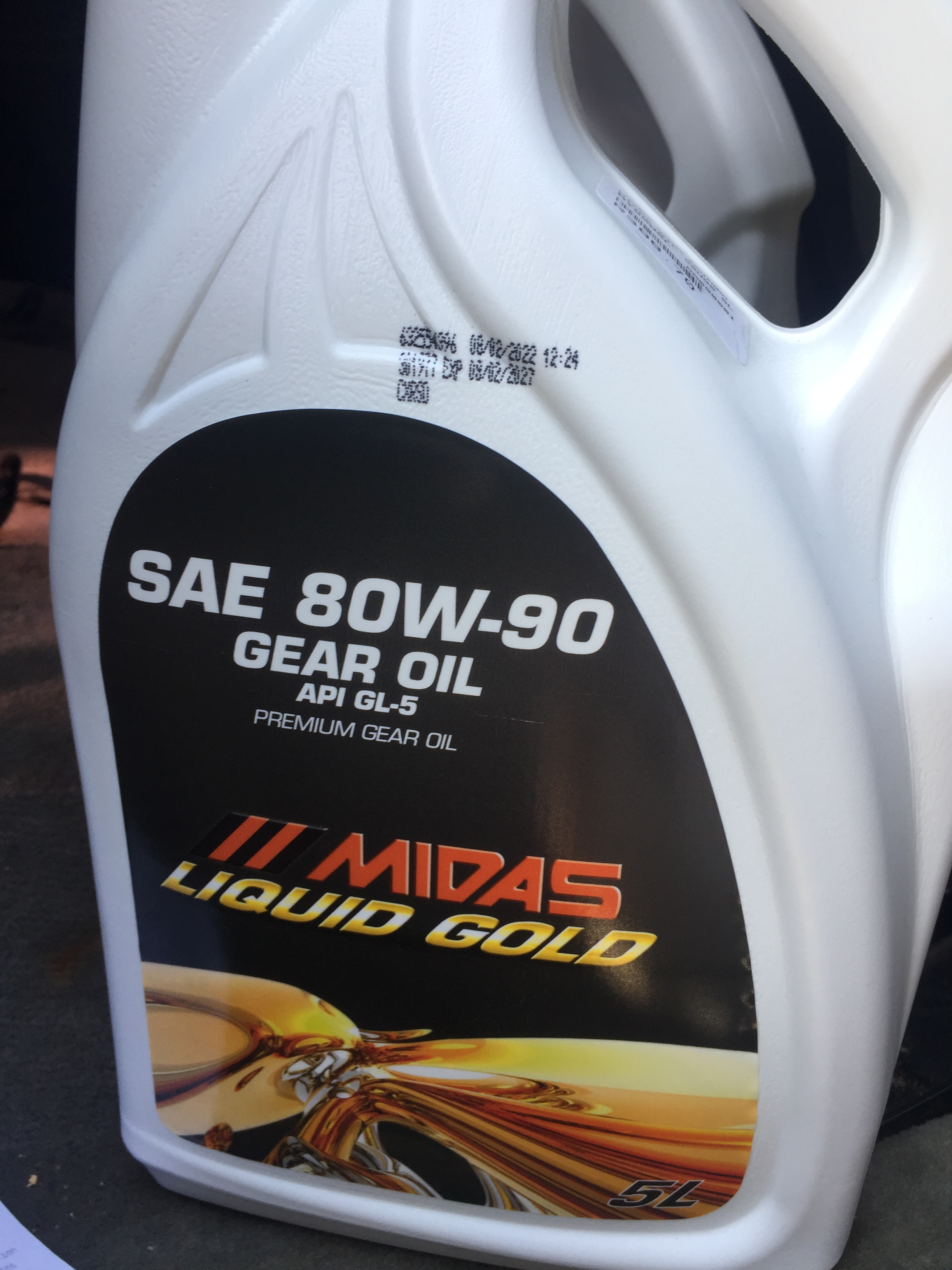

Hi All,
Is anyone using Shell Spirax S2A 80w90 in their diffs?
Spec sheet looks almost identical to the Castrol EPX but it's half the price...

Spike your diff oil needs to be GL 5 not 4 . Your coolant is p38 speck nissan ford and bmw use the same antfreeze in sa made in durban you can buy from any of the above agents .

Re: Diff oil - Shell Spirax S2A?
So Tinus,
Would any decent quality GL5 work then? I am sure Shell would put out a decent product?
Sure it will yes fuchs shell castrol
Ravenol liquid molly just not midas fong kong oil
Midas olie is actually nie so bad.Tinus lotz wrote:Sure it will yes fuchs shell castrol
Midas gold is caltex delo gold...
Net so is al hulle olie astron olie
Mind you, Astron is herlwaarskeinlik fong kong besit, so ignoreer my post...

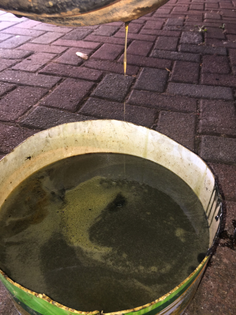

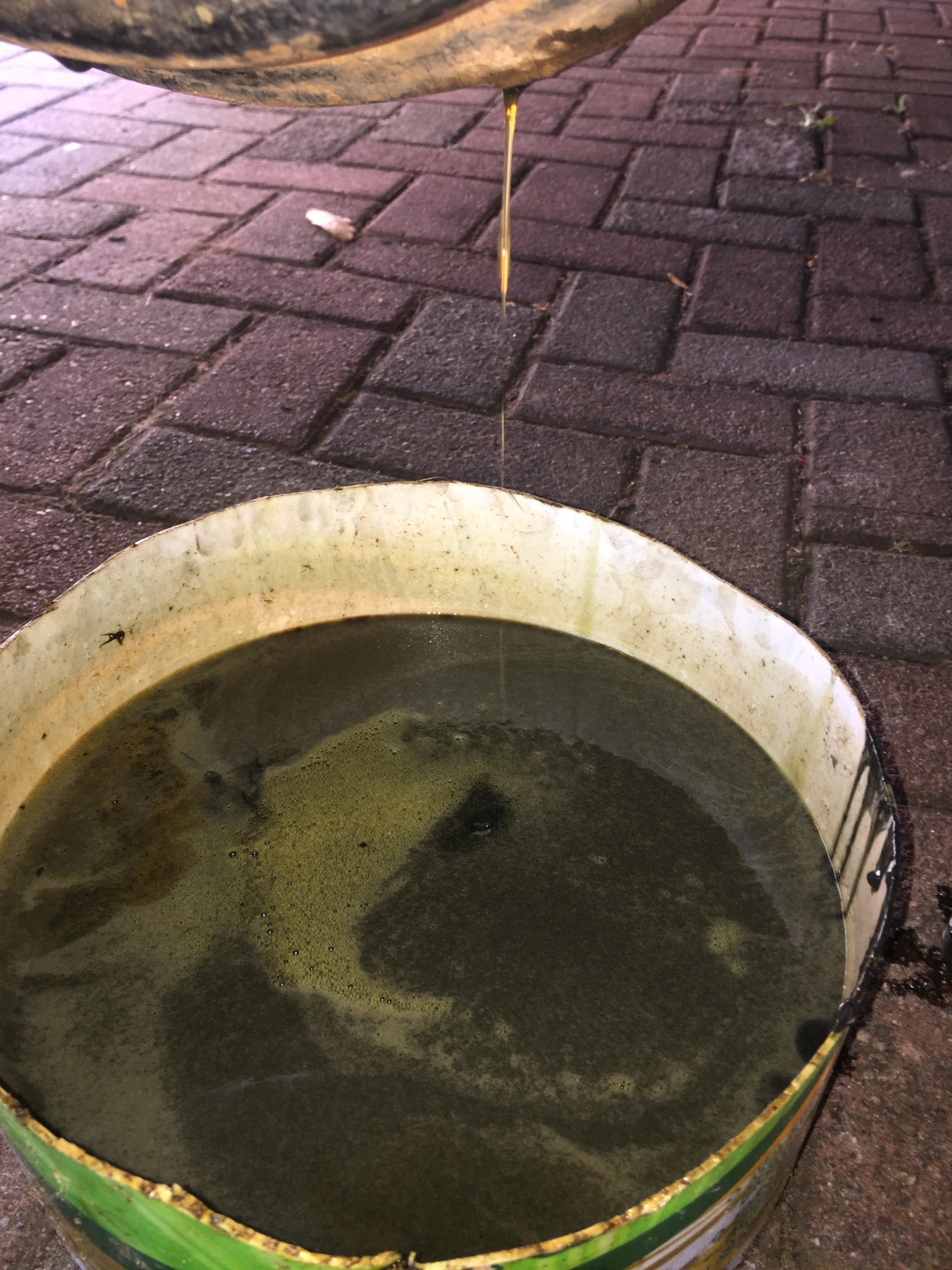

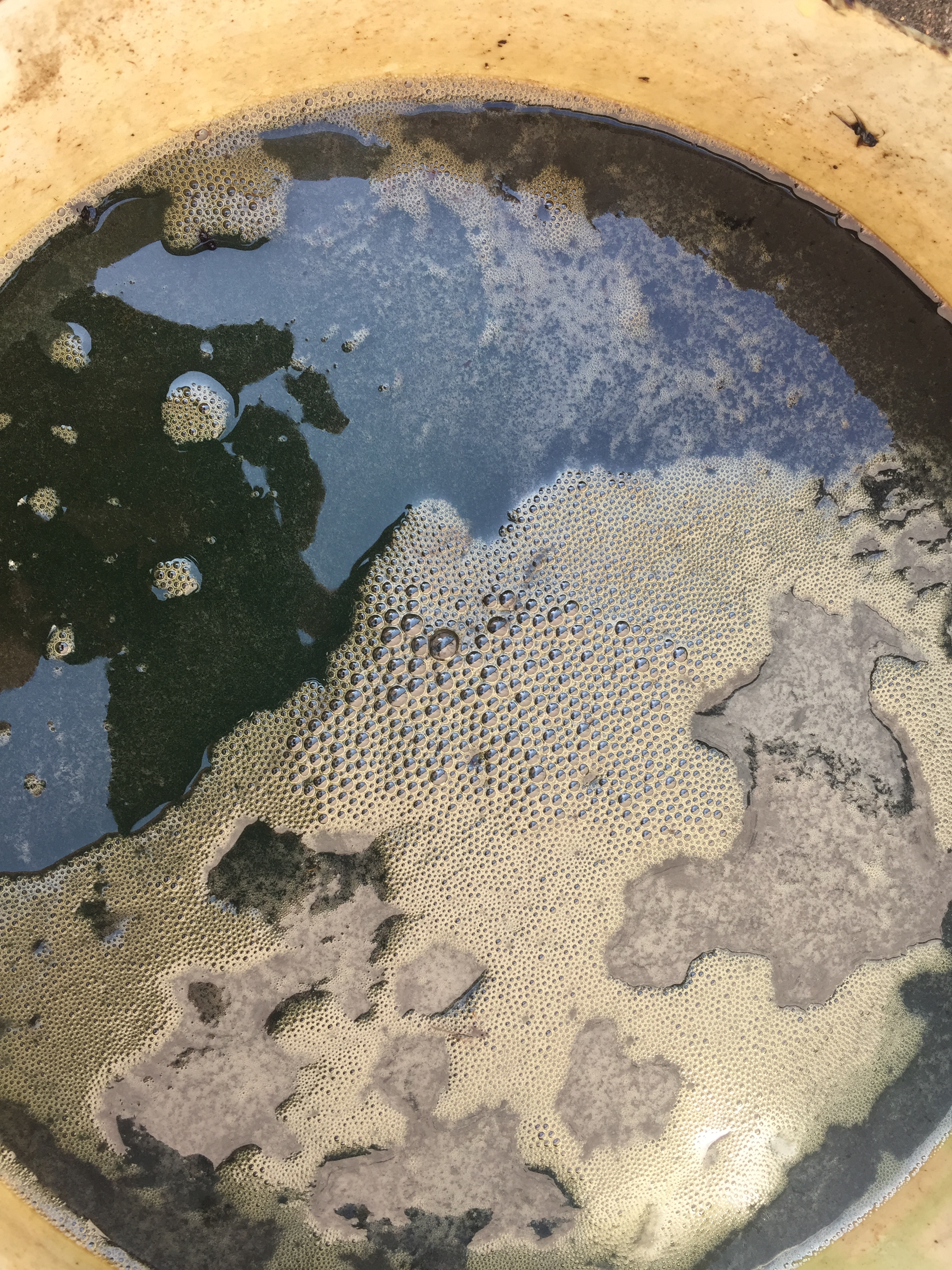

What would the diff oil capacity be for the rear diff on a 4.2 SGL ? (with difflock)
Front as far as I can tell is about 5.4 l. I am assuming it would be less than the front diff?
- Posts: 3367
- Full Name: Fanus
- Has thanked: 249 times
- Been thanked: 219 times
Looks like the rear only takes 2.something liter. (spilled a bit so is not 100% sure).
Changed the gearbox and transfer case oils last year before river trip but for some reason not the diff oils... they were way overdue for a change..
