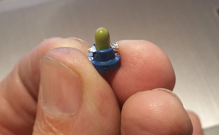

There is what looks like an LED with a boot over it inside the diff lock switch. That does not illuminate

When you guys switch on your diff lock does a light glow inside your switch, just behind the difflock label on the switch? I'm just wondering if that blob in there is actually a covered LED or maybe a fusible link of some sort. There is no continuity through it hence thinking it might be a covered LED
