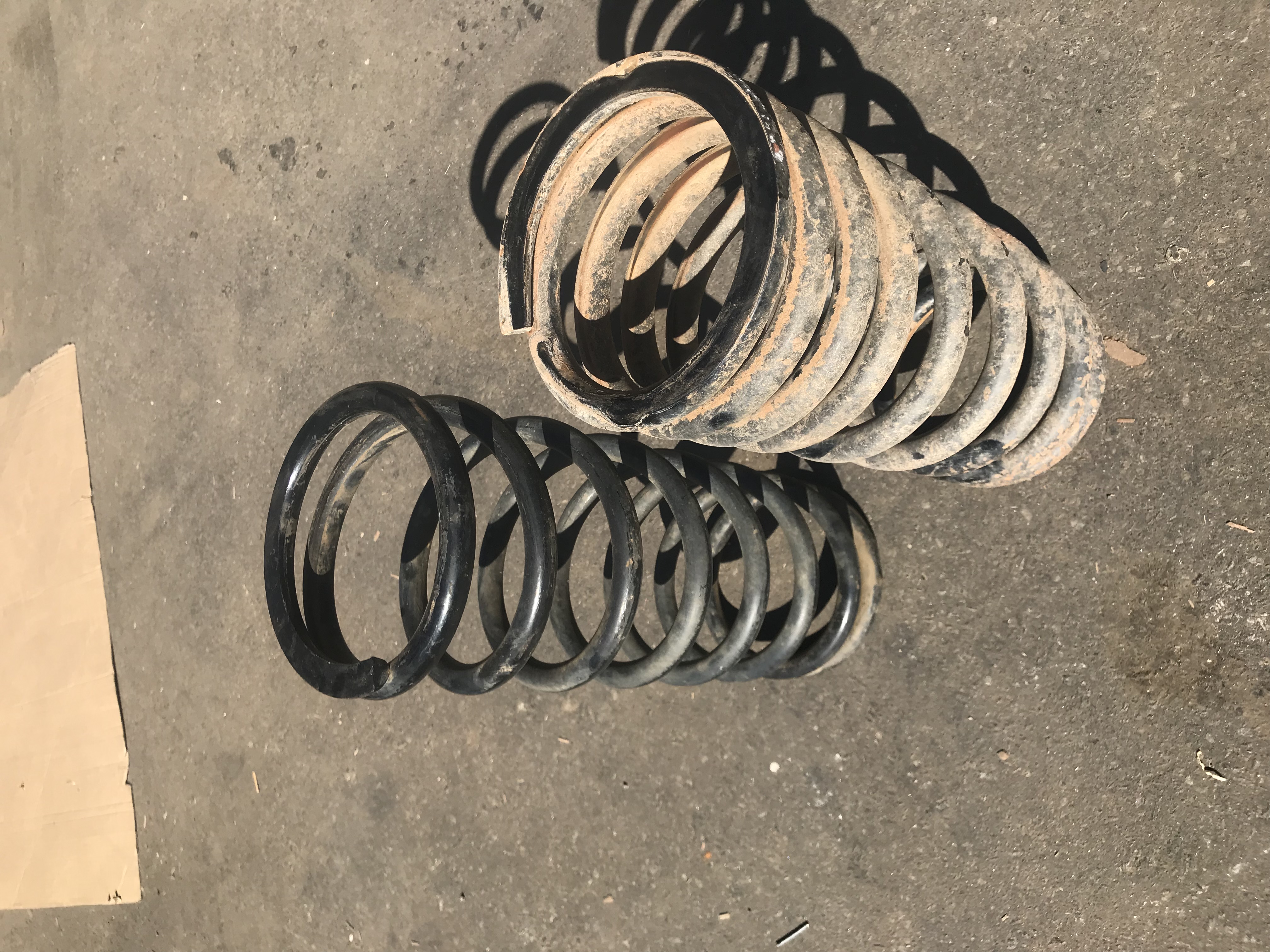

If anyone has some old heavy duty rear coils taking up space, please give me a shout.
Mine started to collapse, I do have a second set of coils. Fronts work great but the rears are just to light and getting some nice propshaft vibrations.
I don't mind Paying, I would just not like to fork out a lot of cash before the river trip.
