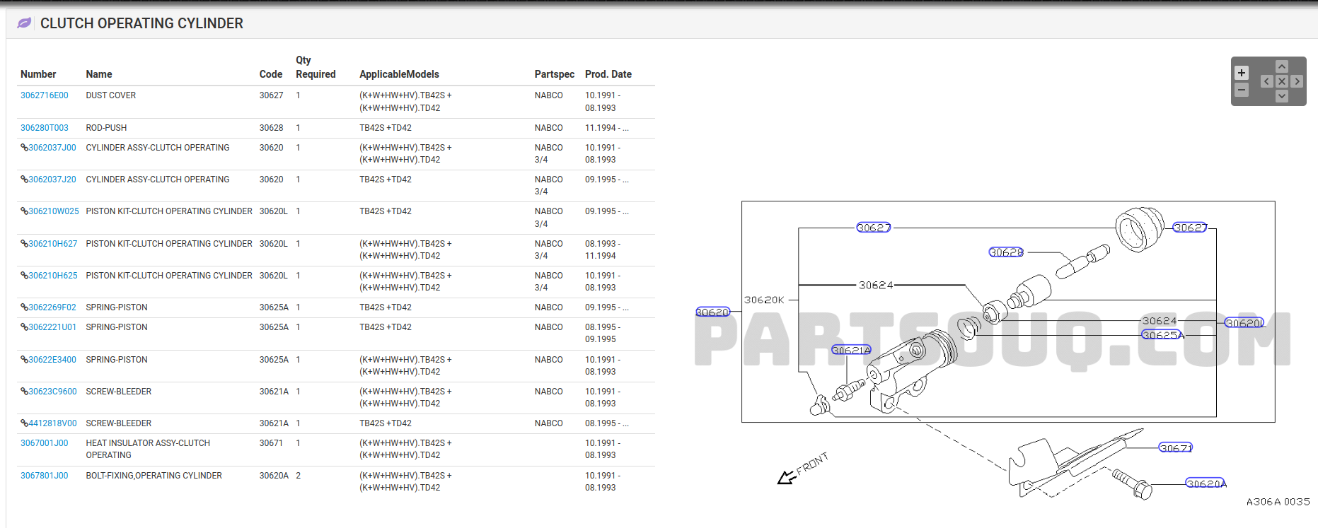

Looking for operating cylinder part number. Not hose.
Will have a look on PartSouq :salute:

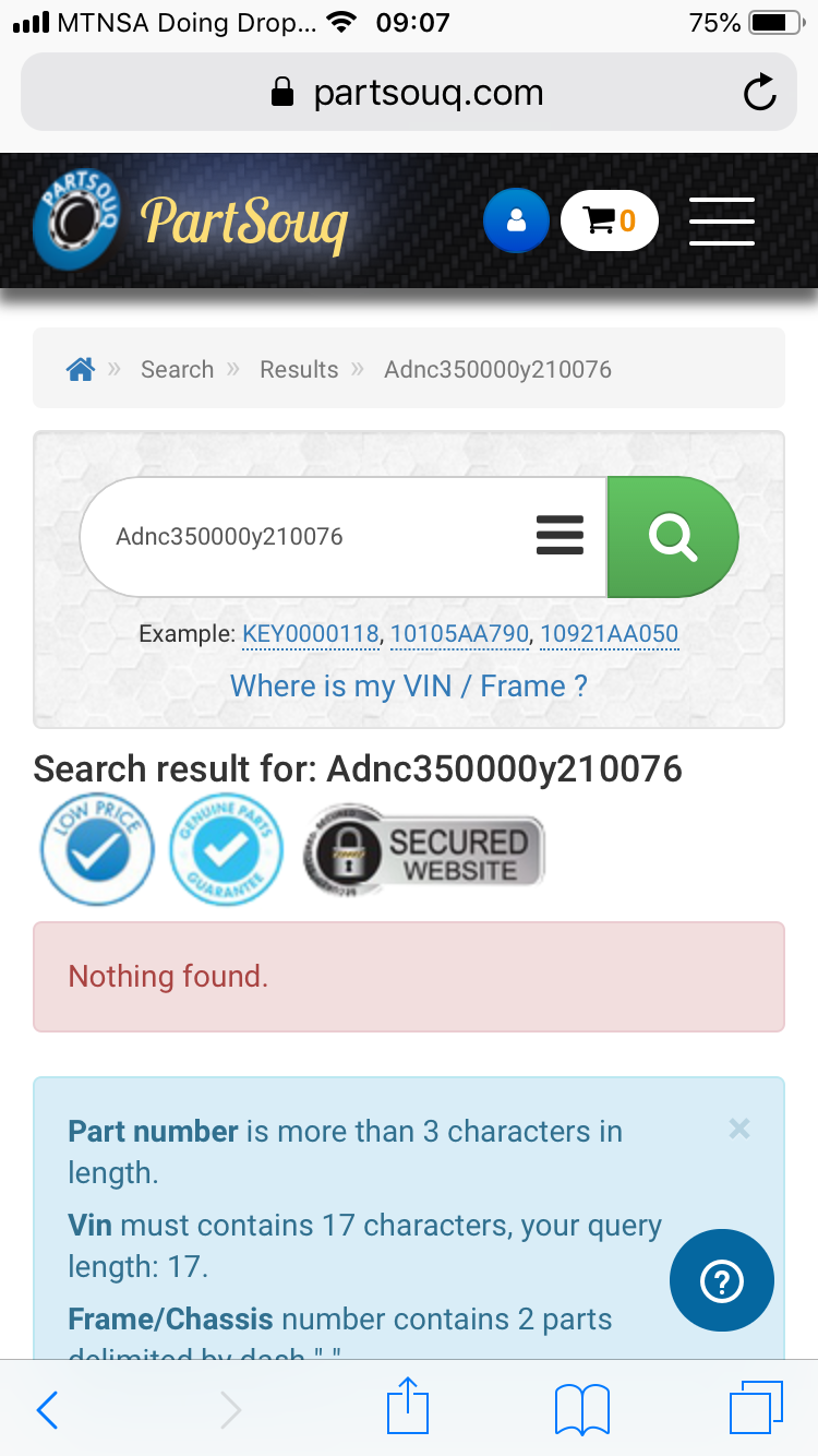

GQ vin number.... :think:

I did a bit of digging. Part number will be 3062037J00 or 3062037J20 as per attached screenshot.
