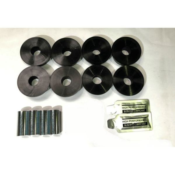

I had a look there yesterday but i thought they only had caster correction bushes,.... and i want standard rubber, as i have drop boxes.
but, now i see this...
https://www.terrainparts.co.za/products ... 01-138.php
Do you think these are:
1) FRONT bushes ?
2) Rubber or Poly ?
I wish they had pics.
I must try contact them

They have rubber non-corrected bushes.
Just contacg Marinus, his service is excellent.
I replaced mine 4 years ago. I have an 8" Record bench vice. No way it would shift those bushes. I had to go stick them in the hydraulic press at work.

We do supply these bushes for a standard height vehicle. It is the TSBK0001 kit as in the link.
The bushes are from a synthetic rubber and outlast any bush in the market, Poly or rubber.
