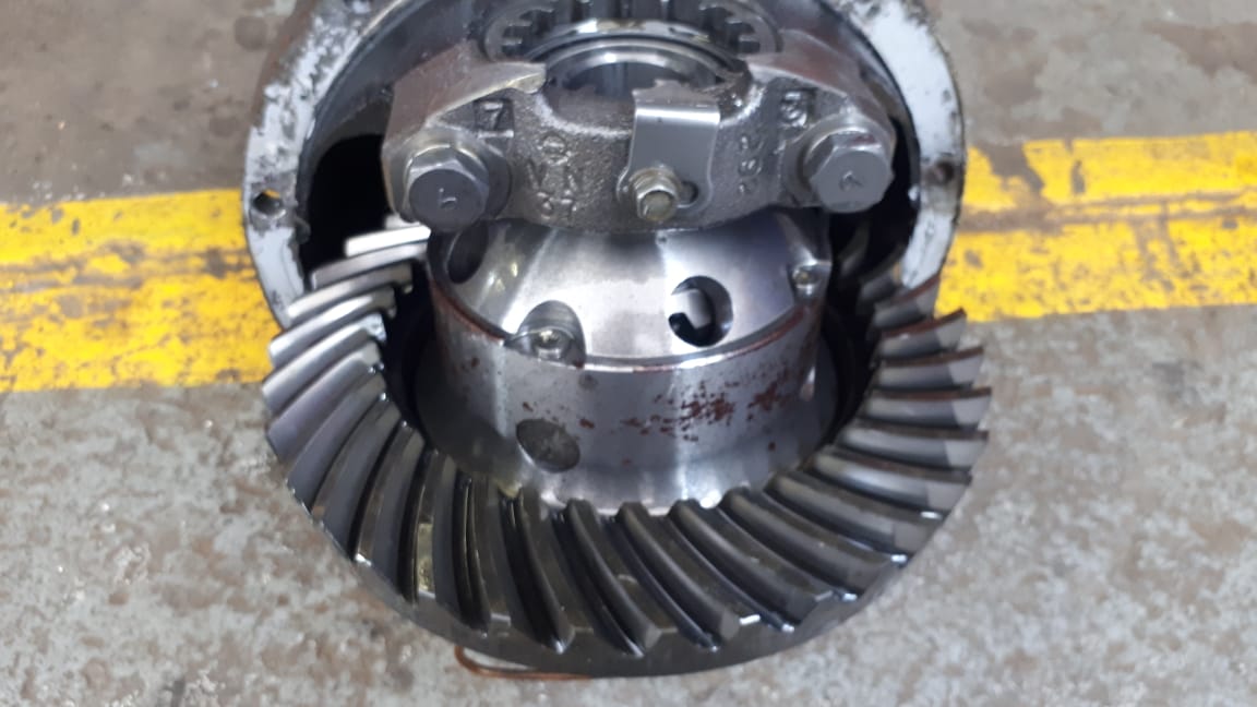

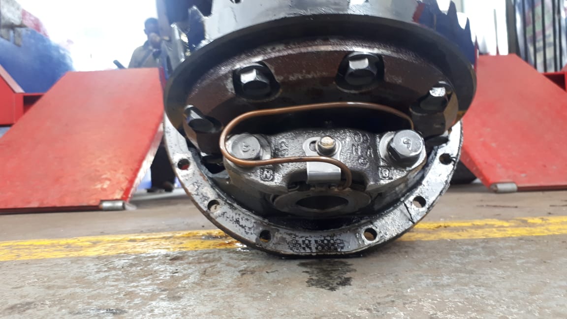

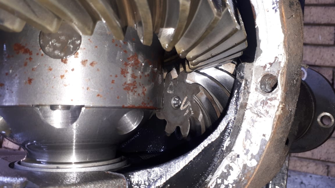

Fingers crossed the unit is ok...
Some surface rust on it... hope the seal faces arent pitted.
Been idle in there for many many years.

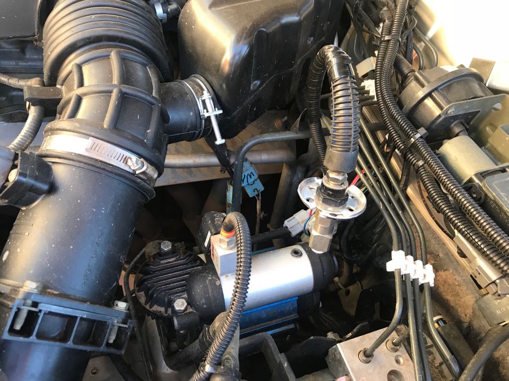

Re: ARB Compressor
I have an ARB front locker with the compressor mounted in the engine bay. Two switches mounted under the 12V cig plugs under the aircon dials. One for compressor and one for locker. Just like Kagiso - switch pump on, 5 sec, switch locker on. It switches off almost immediately (compared to the back and forth of the standard rear diff lock)
I reckon the ARB compressor is well worth the expense. it is t he smallest one of the range and you were going to put a lokka in anyway! I have run an extension from the engine bay to the rear tow hitch so that i dont have to open the bonnet to inflate tyres and no longer need an extension to get to the trailer.
I have never had the compressor overheat and I regularly pump from 0,8 bar for all 6 tyres. MTCW

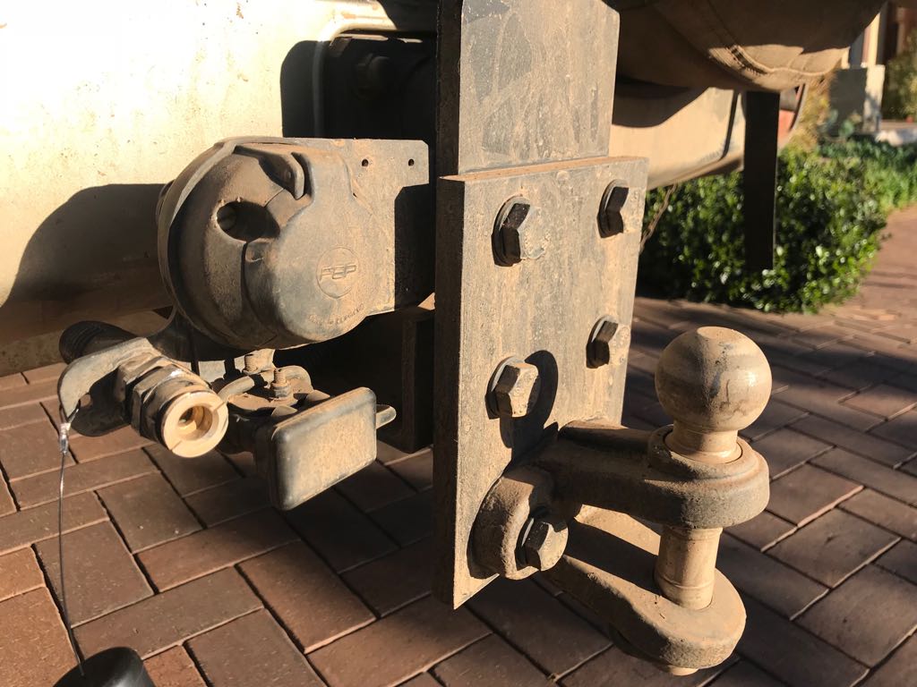

Re: ARB Compressor
For interest ...
Connected a standard ARB orange extension hose and ran it under the car
So that it exited at the tow hitch. used a simple door stop as a cover Internal switches
