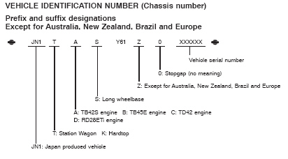

Where does it come from. Japan, China, Australia or SA. Does the Vin no state.

Re: YOUR PATROL
The VIN Number does state where it was built! The "JN1" at the start of the number means that it was built in Japan.

Re: YOUR PATROL
My VIN also starts with JN1, which identifies the vehicle as being made in Japan (the "J") by Nissan (the "N") and as a passenger vehicle (the "1").
Does anyone have a Patrol with a VIN starting with anything else?

Re: YOUR PATROL
Ja. Mine doesnt start with JN1. I posted about this just before the manky miscreants hacked this forum.
Mine sommer starts with the vehicle codes: "WRGY60". Standard roof, TD42, LWB, Y60/GQ Patrol.
Thanks guys, this explains why Nissan Dealers are always hassling me saying I've given them an incomplete VIN.

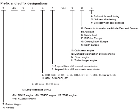

Re: YOUR PATROL
Great, this is an excellent reference! On mine the 3rd part (of the series depicted in the jpg) is 'E' which probably signifies the 3.0TDi engine

Re: YOUR PATROL
Correct.Stefan wrote:On mine the 3rd part (of the series depicted in the jpg) is 'E' which probably signifies the 3.0TDi engine
E=ZD30DDTi
F=TB48DE

Re: YOUR PATROL
Just remember each vehicle has a Model Variation Number as well!
- Model Var No.jpg (44.07 KiB) Viewed 4858 times

Re: YOUR PATROL
Hi Herrie,
It looks like that VIN description is for the Y61's. Is it also applicable to other 'RSA' Patrols?
