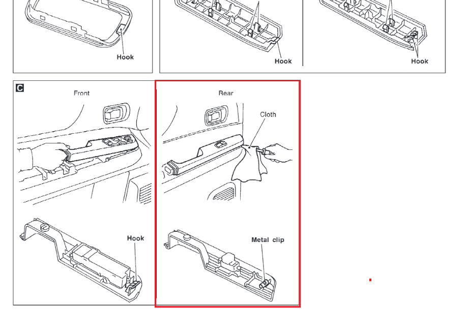

You should be able to do yourself, Nissan will probably just import a part to replace it.
And because picture paints a thousand words ...
door trim.png (149.06 KiB) Viewed 8992 times

You remove the soft part of the arm rest first, unclip it from the rear first, ( grab and pull up or use screw driver to leverage. Undue the screw in the grab handle recess and the pull up, there is a clip on the front that needs to release,
Unclip wire harness , undue screw holding switch. you should then split the switch , If i Rceall there is once clip in each side that you need to press to release it , just take apart carefully, there are 2 tiny balls , clean contacts and re-asemble

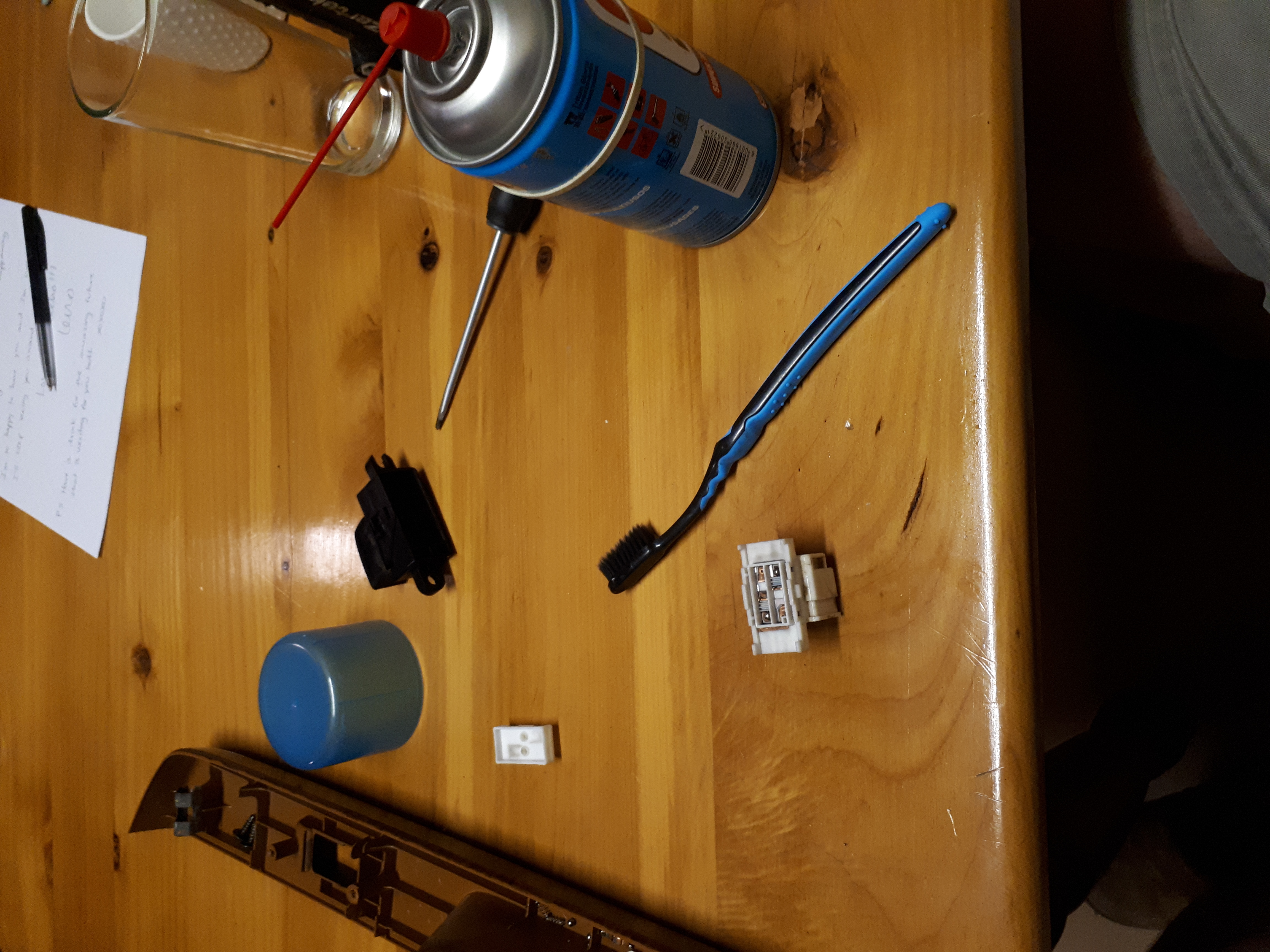

SOLVED :biggrin: !!
The only reason it took me 45 minutes was because I spent 30 minutes trying to find one of those metal balls which went on a grand treck of my lounge floor haha I forgot to take a pic of the switch before I cleaned it but yes the contacts were full of carbon. Good as new now.
But with the instructions here it was a relatively straight forward job which probably saved me R1000 or more and a trip to Nissan so thanks again for all the advice !
