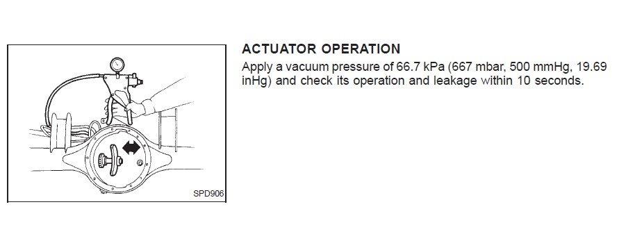

Checked the mechanical movement of the actuator by taking off the sensor and putting a screwdriver against the actuator while engaging the locker.... it moves freely...in and out when vacuum is applied.
I've checked the vacuum on both lines at the actuator... Plenty... about 6oommHg, higher than the 500mmHg minimum required (according to the manual)

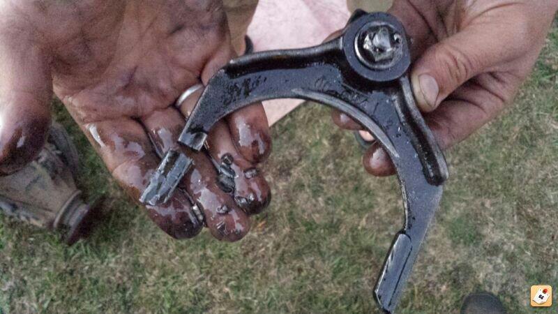

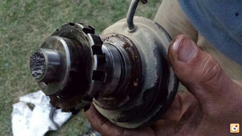

after much reading I found some pics of some of the things which could go wrong:
Broken Fork
Broken fork.jpg (63.77 KiB) Viewed 4904 times
Broken/damaged side gear or dog drive teeth (the two dog drive teeth engage with this gear to activate the locking of the diff)

Broken actuator shaft
Broken Actuator rod.jpg (53.93 KiB) Viewed 4904 times

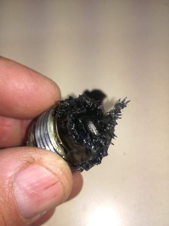

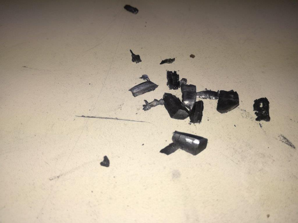

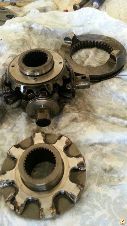

Oh dear....
Drained the diff oil. It wasn't new, but not bad at all.
Stuck to the drain plug magnet were shards of what I think are side gear teeth.
Strained the oil and found 3 more tiny shards. I shaped a piece of wire and dug around in the drain hole to scrape any more out but there were no more.
I do have to take the carrier out at some point and repair this but for the moment, I put the oil back and will drive without difflock.

Are you sure its all out??
You dont want to be driving with grinding paste in the diff...
