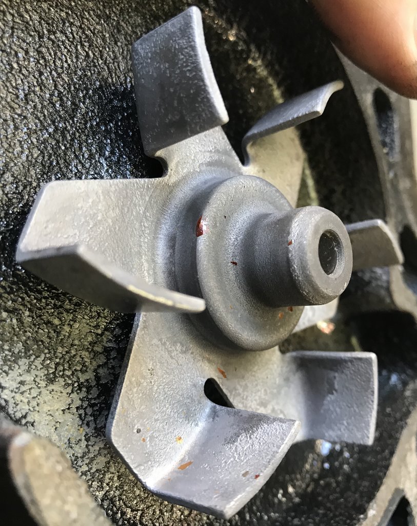

I took off the waterpump and there does not seem to be much wrong with it, the impellers are slightly worn. I think I might have wasted money buying a new one.
Or will the corroded impellers make a big difference?
Re: Waterpump
I have seen way worse, but actually still looks fine. That being said the piece of mind will be in the new pump.
The corrosion on that impeller would not make a difference IMHO, but any pitting on the surface of an impeller will increase cavitation.
Use the new one...
Use the new one...

Re: Waterpump
The problem usually lies with the bearing/seal. And then the inconvenience of having to drain and replace expensive antifreeze, removing the radiator and fanbelts. Rather just buy a good quality new pump.
Re: Waterpump
I see you bought a new pump & you pulled the old one out so best idea is to fit the new one...

Re: Waterpump
Note sure why you opted to pull the old one - now that you have done so best is to put a new one back.
