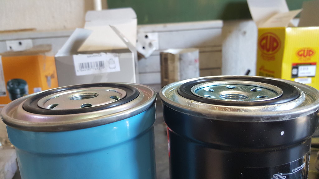

Re: Loss of fuel pressure on very steep uphill
Those campion filters are defective .... the top of the steel bottoms out on the housing before the rubber can seat ....
- Been thanked: 432 times
Jip, 100% as mentioned by Tinus and Tijmen.
Thise champion filters are garbage, they actually now stock the full range of GUD filters for the Patrols for me at our local spares shop because of these sub standard other brands.
Will post a pic of the problem
Here is a pic with the two filters side by side.
Look carefully at the centre section where it screws on
