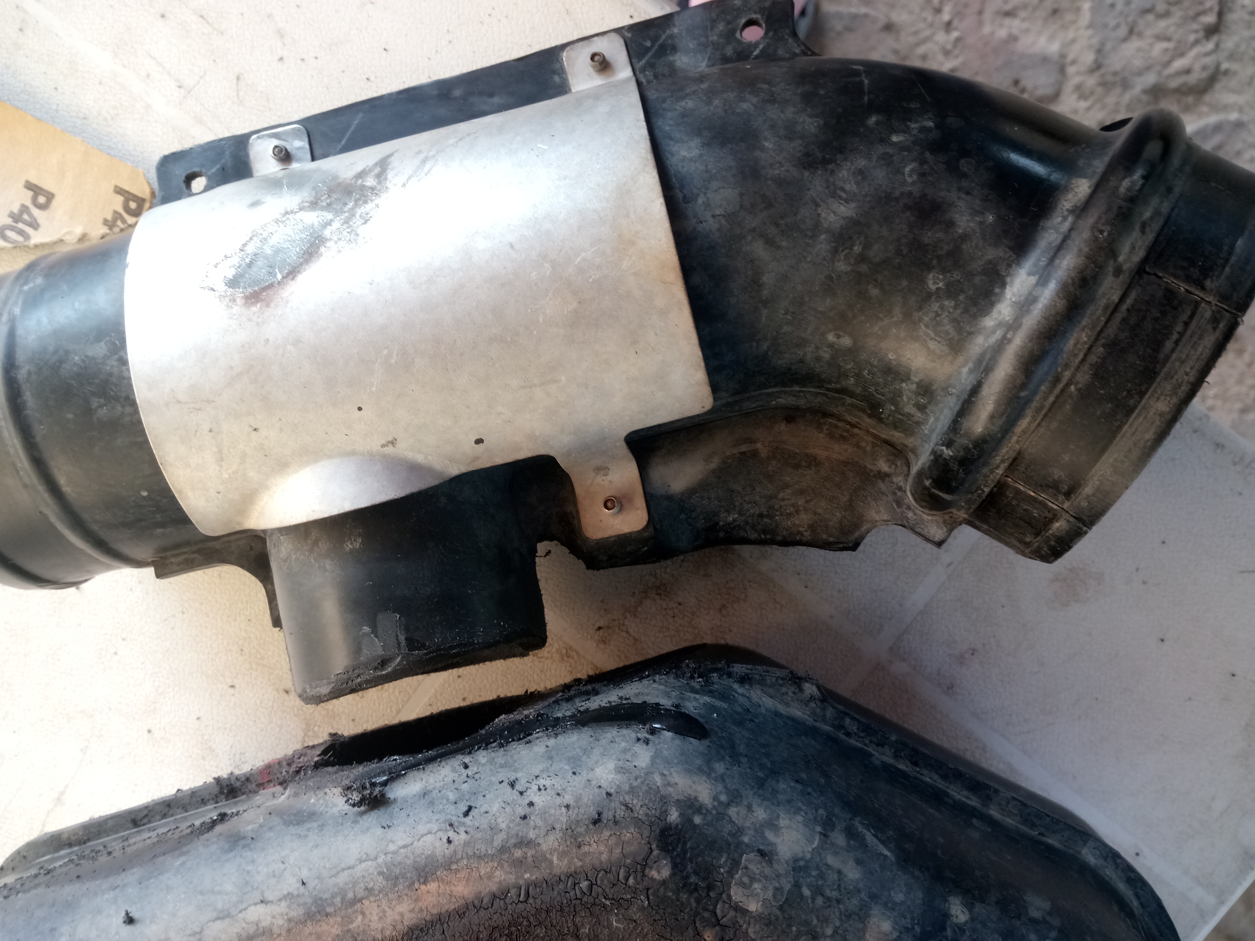

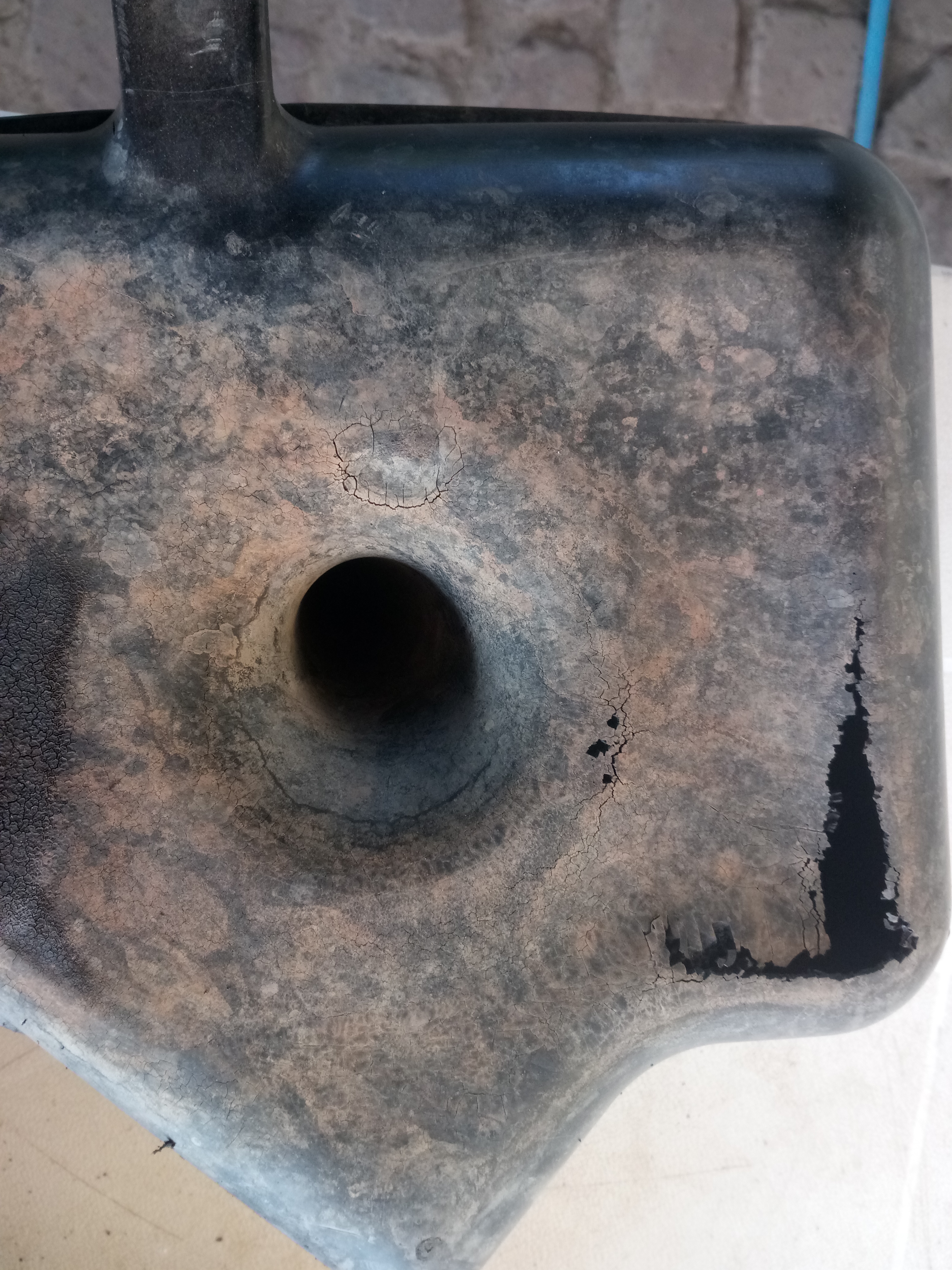

Took it to Graham the other day and after swopping MAS sensor and distributor among other things discovered this;
Would seem that over the years the heat from aftermarket branch manifolds has slowly caused the underside of the resonator box between the air filter and intake manifold to melt allowing air in after the MAS sensor.

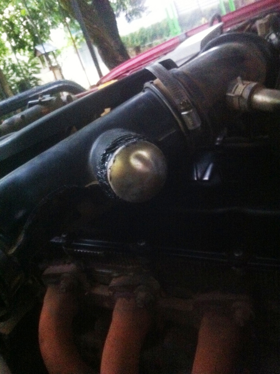

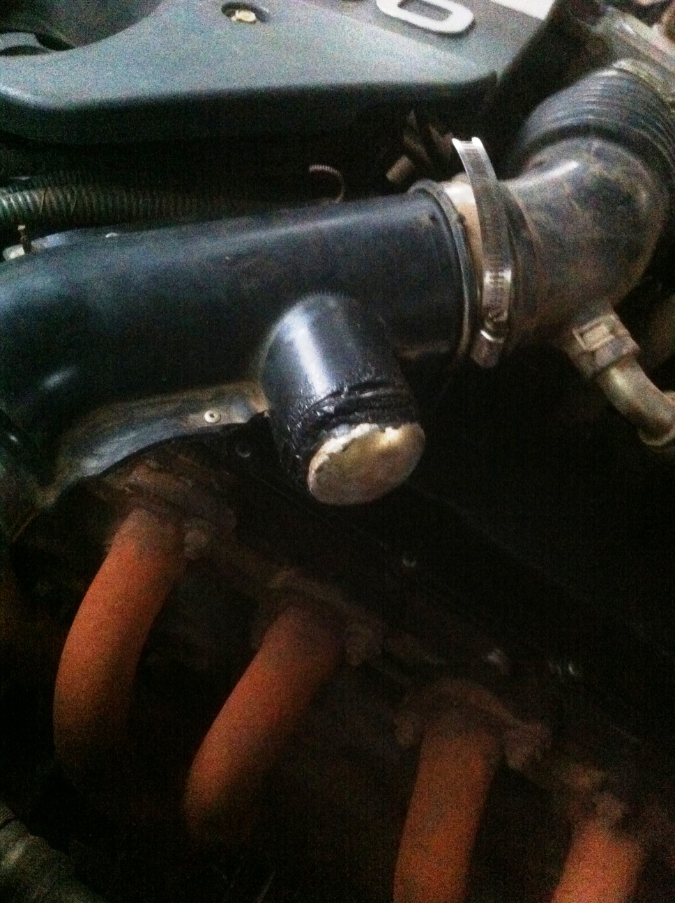

Borrowed one from Graham for the meantime but I can see no reason for the box so here is what I believe to be the solution;
1. Cut the box off of the intake pipe
2. Seal the hole
3. Add additional heat deflection
Will fit this weekend and see how it goes.
Moral of the story - If you fit or have aftermarket branch manifolds, ceramic coated or not modify and retain the heat deflection over the manifold.

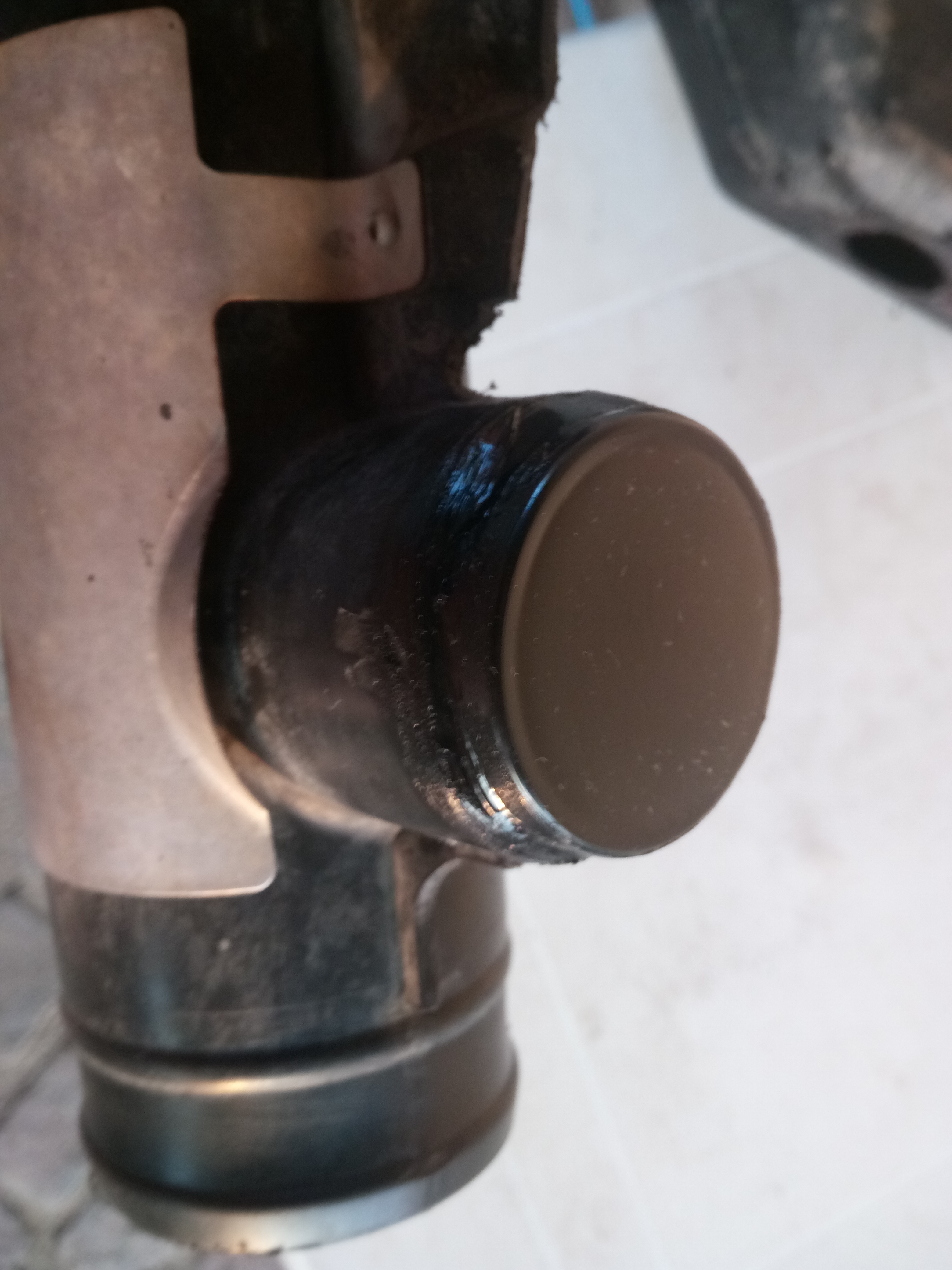

To block the pipe I just went to the local hardware with pipe in hand and tried different things until I found a plastic cap that fitted with minimum modification and siliconed it in.

Could not find a suitable "plumbing cap" but found a grease cap that I made to fit. Was slightly larger than the inner diameter of the pipe.
