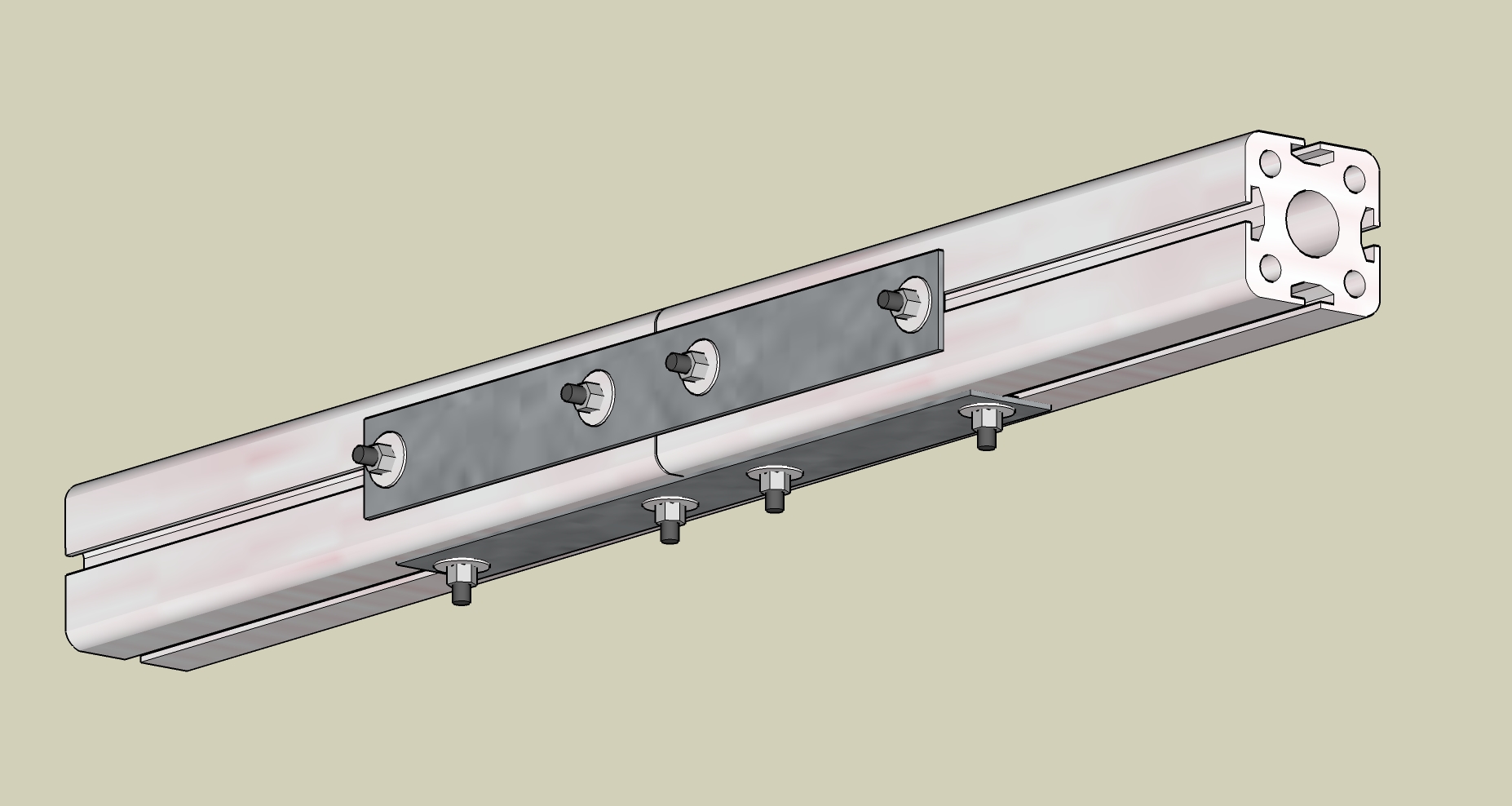

There is aluminium profiles available but these profiles cost a bit more than the usual profiles. My wifes company ( Tectra Automation ) use various profiles for various projects from conveyors to flight simulators using a profile that looks like this...
offcut joins.jpg (281.36 KiB) Viewed 3745 times
Excuse the jointing system....hahaha... as I was going to try use offcut pieces to make up a frame for a workbench. Have a look at the profile though. This is incredible strong and although I was using a 75 x 75, one can use a 20 x 20 or 25 x 50 ( sizes may vary slightly ) I know they have a bolting system that joins a 90 deg bend as tight as a full weld too. Unfortunately they don't make up roofracks, but I'm sure there is a profile similar to this available here somewhere.

ricster wrote:There is aluminium profiles available but these profiles cost a bit more than the usual profiles. My wifes company ( Tectra Automation ) use various profiles for various projects from conveyors to flight simulators using a profile that looks like this...
Any idea where they source this profile from?
Re: Waarvan bou 'n mens n dakrak?
aus Deutschland...... They are part of Bosch Rexroth, hence why I mentioned it isn't cheap, but it is as strong as ........ a Patrol !! :biggrin: :biggrin:
