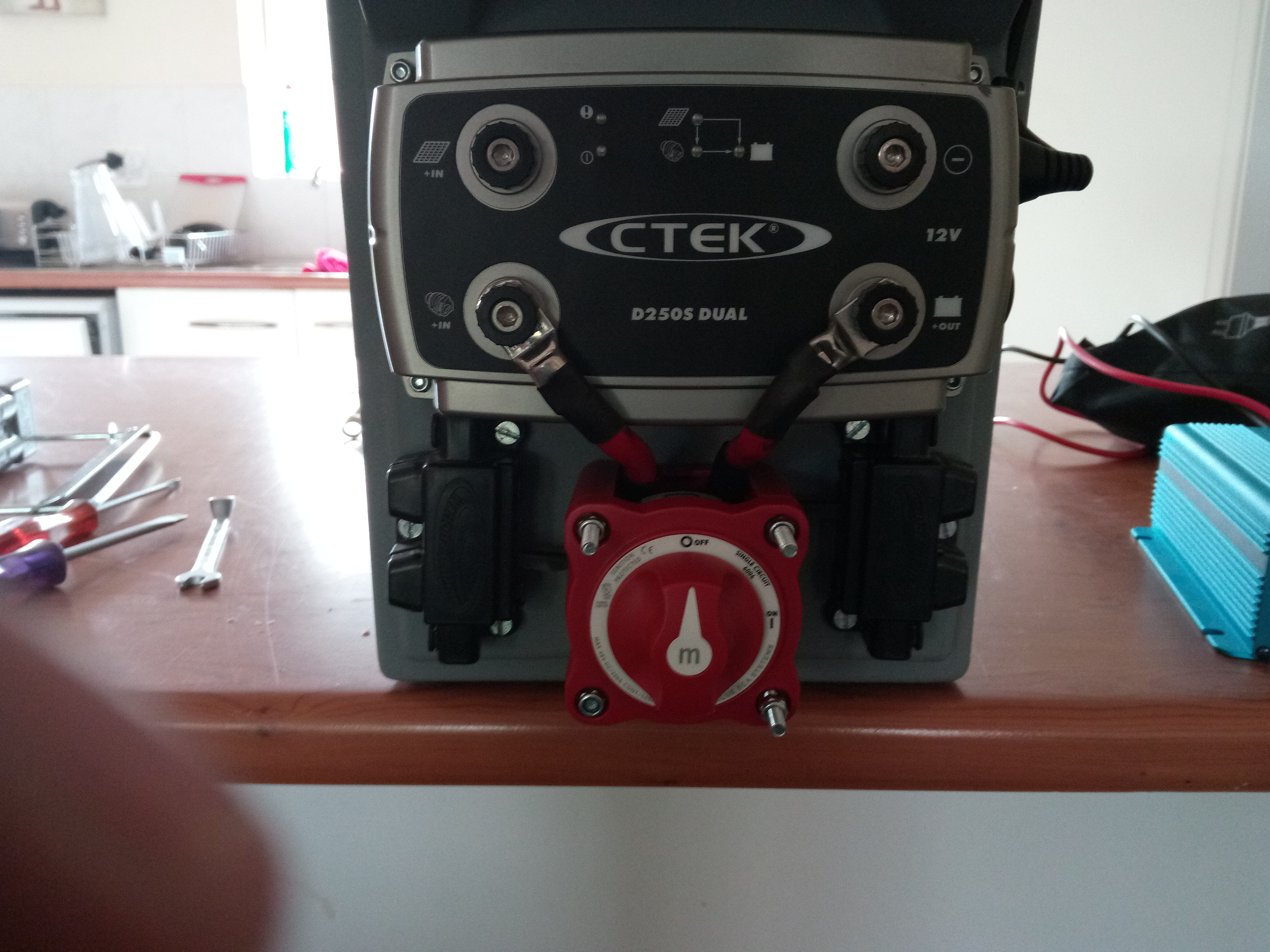

Bat box.jpg (3.87 MiB) Viewed 6137 times
Busy with exactly that. Used marine switch

biggles wrote:I am planning the dual battery install and I have some questions.
Firstly I am not keen on a rear battery but no place upfront.
One of the most used functions of my old patrol was the battery link for cranking with a flat crank battery!! With a rear battery is that possible? If I used the Ctek dc-dc will i be able to do the link battery thing?
As per post above but use the thickest cable you can front to back. I used normal battery cable and I think Chris Skinner used even thicker.

Thanks guys:) What size cable would you recommend for cranking? And does the switch just change the positive from the in to the out terminal? Am I seeing it right?

Re: Rear Dual battery
Post by David M »
biggles wrote:Thanks guys:) What size cable would you recommend for cranking? And does the switch just change the positive from the in to the out terminal? Am I seeing it right?
I was going to put the battery in as part of the drawer system but realised as the fridge slide will be permanent and the drawer system is made to be taken out and I may still use the fridge without the drawers in I will put the battery behind the fridge slide (part of it).
As Tinus says 25 mm2 cabling or you can go even bigger if you want the rear battery to assist with winching.
The switch is between + In and + Out on the C Tek and bridges it so that current can now flow both ways when in the On position. It is normally in the off position but if you want power to the front to start or winch you flip it to on.
Beware that you leave it in the On position you can drain both batteries and the C Tek will also not be doing it's job.
Of course if the C Tek stops working you flip the switch to On and the 2nd battery charges directly from the alternator.
