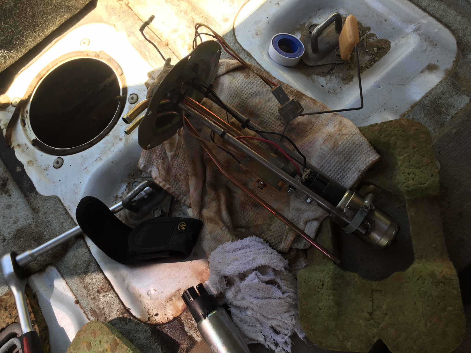

So my 31 December afternoon was spent taking out the drawer system (again), and replace the Bosch fuel pump inside the tank.
Wife and I tested the replacement driving through the "Hemel and Aarde" Valley. My car finally performed like a real v8 again!
This job also included a "phone a friend" session with Graham.
Something I spotted is that the internal fuel pump system includes a small little filter, more or less the size and shape of a teabag. It inserts at the bottom of the pump.
My pump did not have one on, which may in part explain why it was clogging up the filter as much as it did.
Be that as it may, I then realised that the small tea-bag filter made the whole sender unit too tall to fit into my tank!!!
No wonder there was not one inside.
But all I had to do, was to cut a bit off from the nozzle of the small tea-bag filter. It still fitted at the bottom off the pump, and now the whole sender unit, with tea-bag filter fitted inside the tank.

The picture of the sender unit is below.
The old and new pump can be seen.
Once the sender unit is out, the replacement is simple. The power point just clips in, and then the pump itself is clamped, as well as the outlet onto the fuel pipe.
The pain is taking out the drawer system, and secondly sealing off the gasket, to avoid a fuel leak.
Petrol as a tendency to leak if not properly sealed off.
I unfortunately forgot to take a picture of the tea-bag filter that clips in at the bottom of the pump.

I have a different opininion on why the pump died: all the sand in the filter passed through the pump first.
These pumps don't like that.
I had four fail on me in quick succession in my Lotus, before I changed to an external pump where I could fit the filter between the tank and the pump. Each time the pump went to Bosch as a warranty, and each time the claim was rejected. On the last one I said I wanted to see. One single grain of sand the size of builder's river sand had screwed up the pump completely.
The trick now is that you have sand in your tank, and you somehow need to wash this out...
I hope your tank has a drain plug?

I am not sure about the drain plug, but at least I have the little tea bag filter in this time, that should help.
I like the idea of an external pump as it is easier to replace, and the sealing of the gasket would not be an issue anymore either.
But then I suspect one needs to manufacture the outgo pipe to be at the bottom of the tank. The external pump I know does not like sucking air.
The return pipe I assume would have to remain at the top.
