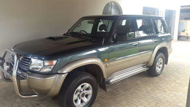

I have tecently added another Patrol to my garage. A 2001 GU 3.0 TD.
I have been fixing a couple of things on it and one issue I have is the radiator. It doesnt look the same as other similar model Patrols I have seen and even the cowling is different. So I think I am going to replace it from the start seeing that this specific model engine tends to run hot ot overheat easier( please correct me if I am wrong). Should I go the standard nissan radiator and cowling setup or would it be better to have something built? (Maybe 3core). If so where can I fing the right guys to get it done right first time round?
