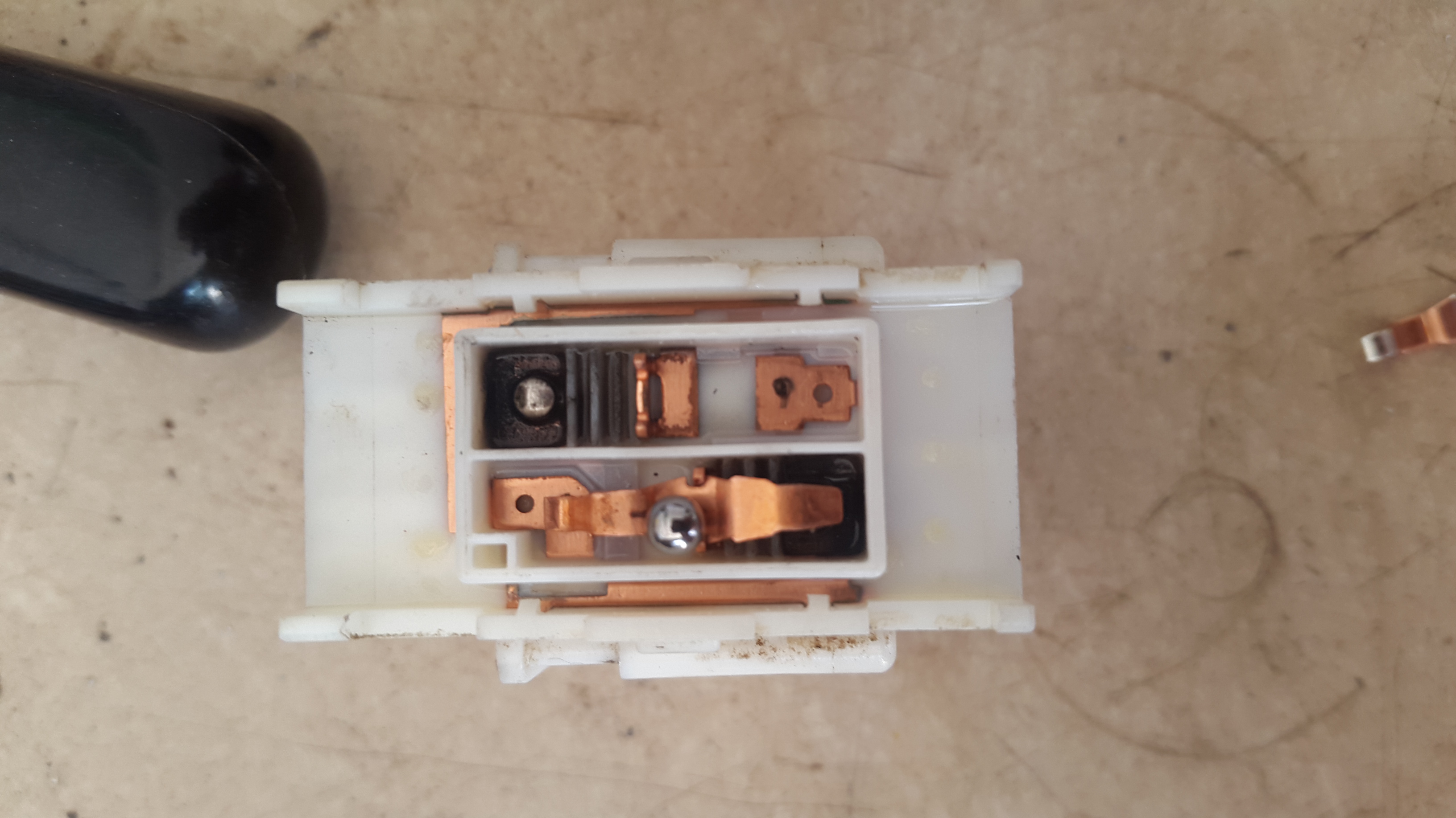

Front passenger window switch faulty
Hi guys
I've recently had an issue where the passenger window switch has become increasingly intermittent to the point where it barely works anymore, but the window does operate if controlled from the switch bank on the drivers side with no problem.
I also noted the exact same thing on another Patrol earlier this year. Anyone have any experience with this issue?
I will remove the switch on the weekend and look for a dry joint or loose connection so long.

Re: Front passenger window switch faulty
I have had similar issues. In each case a good cleaning of the switch has solved the problem.
Carefully take it apart and give it some beans with the switch cleaner spray can.
Switch or the wiring. But, to be honest, I'd say that it is probably the switch.
I've not had issues with my Patrol, but I had similar issues with the Hardbody.
After a long time of use, the contacts on the switch start building up with carbon.
You can temporarily get the switch to work by opening it up and cleaning the contacts with a pencil eraser. I've got photos lying around somewhere documenting this process (there is a bit of a trick with this, as there are two little metal balls in there somewhere which shoot out and can get lost if one is not careful), but I'll have to find them. I'll post them when I do.
The big issue is that resolving it in this manner is only temporary. Once the switch starts acting up, cleaning the contacts is only a temporary option. It's generally better to replace the thing.
Looking at the switches, I imagine a Hardbody switch will also work (at least, my Patrol and my Hardbody switches seem to be identical), but I cannot confirm this 100%. I'll need to test the pin-outs.
Hope this helps.
Hope this helps.
Great! Thanks Piet and Ian. I will get the thing out on Saturday and clean it up. Will let you know how it goes..
Quick update, sorry I forgot to post on the weekend..
Stripped the switch, cleaned the contacts up (they were quite dirty) with scotchbrite, put it back together and all good. I'm glad I did it, because I did find a few screws were loose in the door panel,
