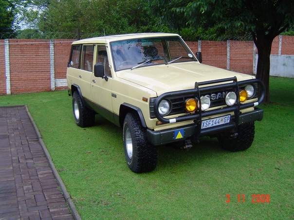

This is a picture of my patrol with the 33s fitted.
- DSC00066_resize.JPG (46.51 KiB) Viewed 3933 times
