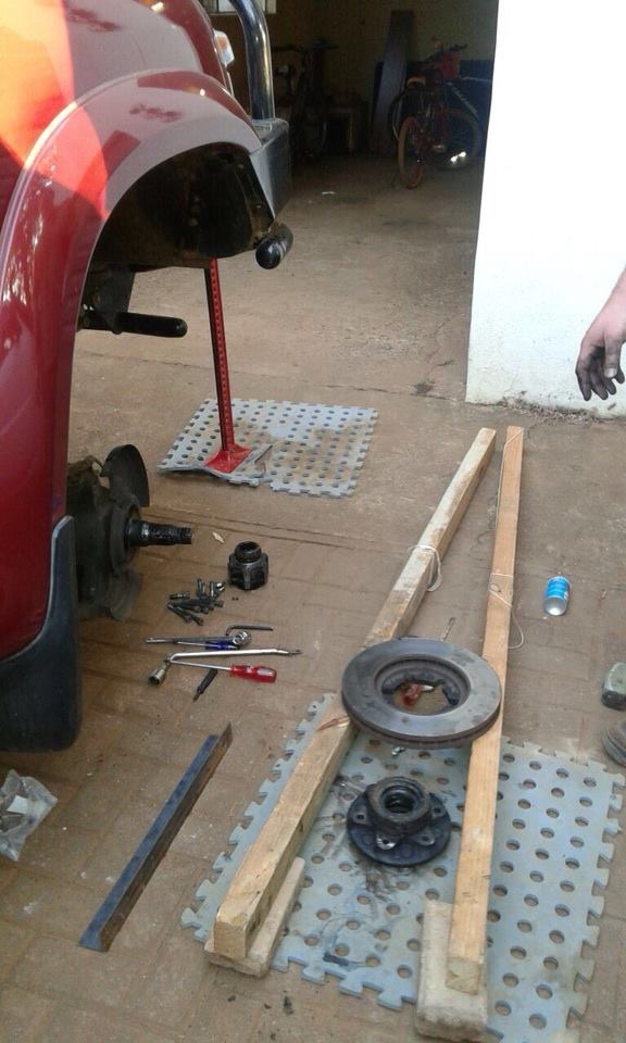

To me it is less effort to use the hilift. Just make sure vehicle is on level ground. With bottle jack you have to get on your knees to operate the thing.
(But then my bottle jack's handle is missing, so have to use a screwdriver...
