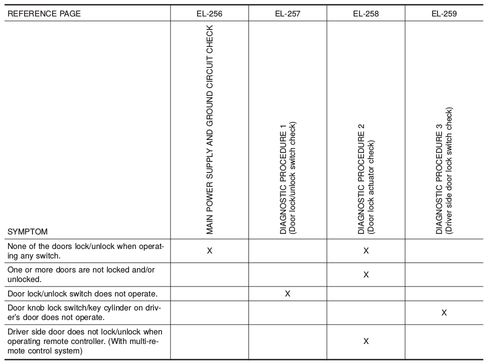

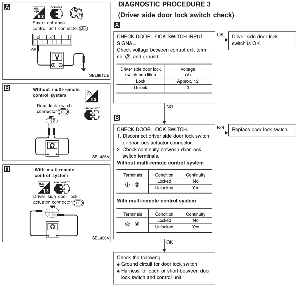

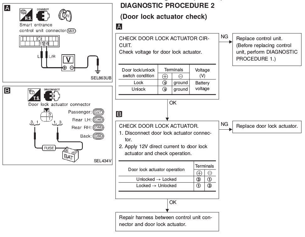

Re: driver door lock
Not sure of your vehicle. This is from the 4.5 Manual.
