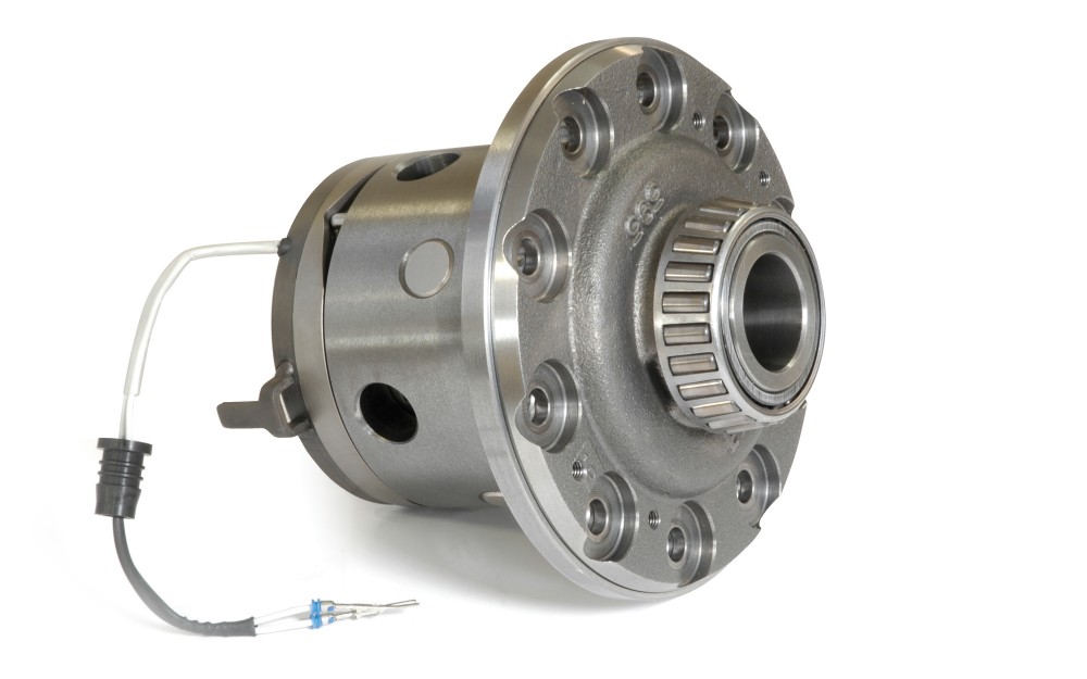

Diff locks - Harrop E-locker

When I was looking around for a locker, the E-locker from Aussie seemed to be the best option, but present pricing, with the exchange rate, will put me in ARB territory of around R26K.
I think I will rather look at locking the front C200 on my Sani, and live with the LSD till my level of expertise off road warrants locking diffs. I ran IFS open diffs to date, now SFA with 180mm lift, should keep me busy on the learning curve for a while :doh:

Here's an interesting question for the fundies out there :
Is it possible to modify a rear vacuum driven diff lock from a GU to fit and work in the front diff ???

I answered my own question on the rear to front diff lock modification.
http://www.nissanpatrol.com.au/forums/a ... -1436.html
Problems are :
1. Spline count on front diff is less (31 front, 33 rear).
2. Rear diffs Low Pinion & Front diffs High Pinion.
3. Rear diff centre won't work without steering modification - tie rod runs underneath the pinion.
4. Crown wheel will need modification to inside chamfer where it contacts the carrier.
5. Rear diff housing (hat) is different - will foul on panhand rod.
I wondered why no one has attempted it yet :doh:

Dustin wrote:Is it possible to modify a rear vacuum driven diff lock from a GU to fit and work in the front diff ???
Dustin.....I have wondered about this many times, and have thought about it last week again actually.
I have not find anything on the net of anyone who have done this before,but that does not mean it cannot be done, it will be way cheaper than an ARB and I prefer this system as you do not need an external compressor

Thought the question was worth the shot.
Would be a hell of a lot cheaper than an ARB air locker.
The guy with the mad Patrol UTE on those 4wd action dvd's said he's running a rear Detroit locker (LSD) modified to fit in the front.
That's what got me thinking about the vacuum driven units in the front.
