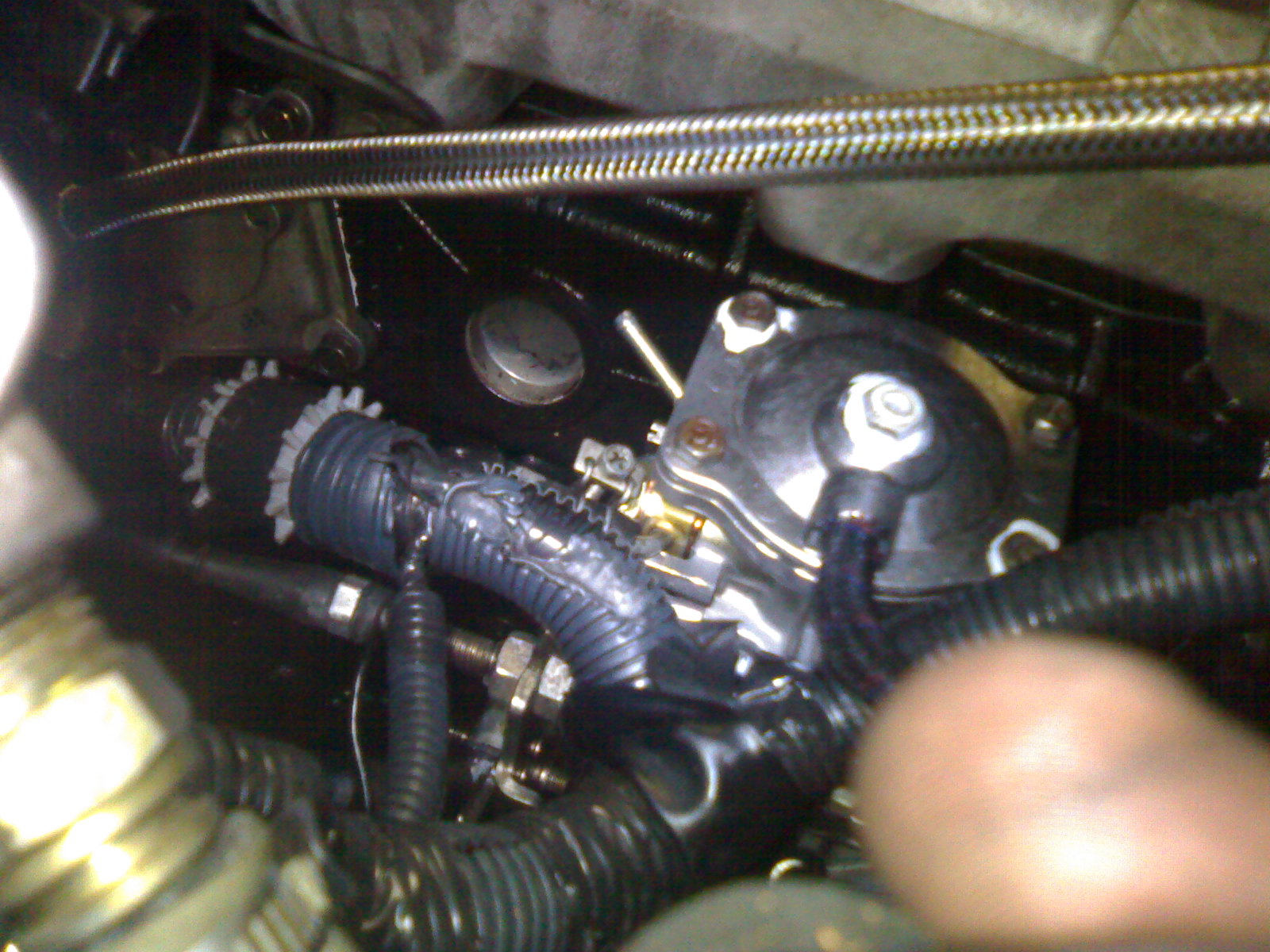

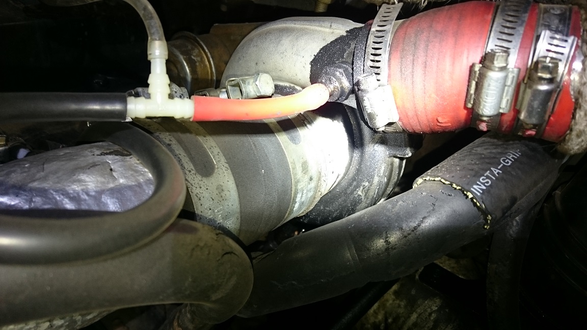

Aneroid ( compensator ) is pretty much what the other guys have said. It controls the fueling when under no boost or when boost is achieved. There will be a thin pipe from the compressor side of the turbo connected to a "T" piece where one side connects to the turbo waste gate actuator, and the other connects to the injector pump aneroid ( compensator ) ( excuse the oil on my turbo.... but she is a little tired now and needs some attention )
thin pipe from turbo to IP and Wastegate
DSC_0625 a.jpg (235.14 KiB) Viewed 13495 times
aneroid on top of injector pump
