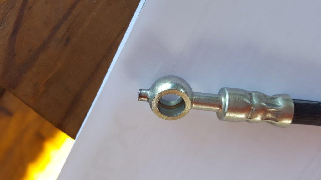

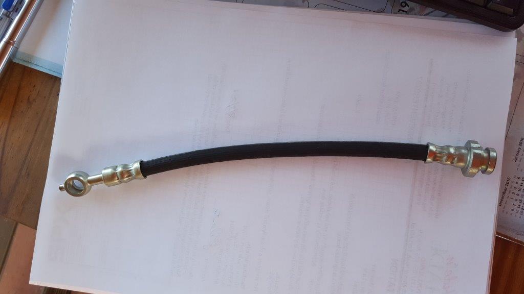

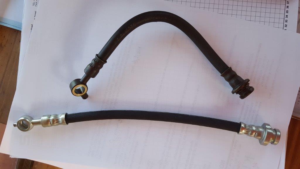

Re: Front Brake Hose Lines
Thanks guys. Got new ones made-up from the local Midas shop. Just need to install them now.
- 20160713_124254.jpg (49.28 KiB) Viewed 3877 times
- 20160713_124215.jpg (36.86 KiB) Viewed 3877 times
- 20160713_124206.jpg (42.5 KiB) Viewed 3877 times
