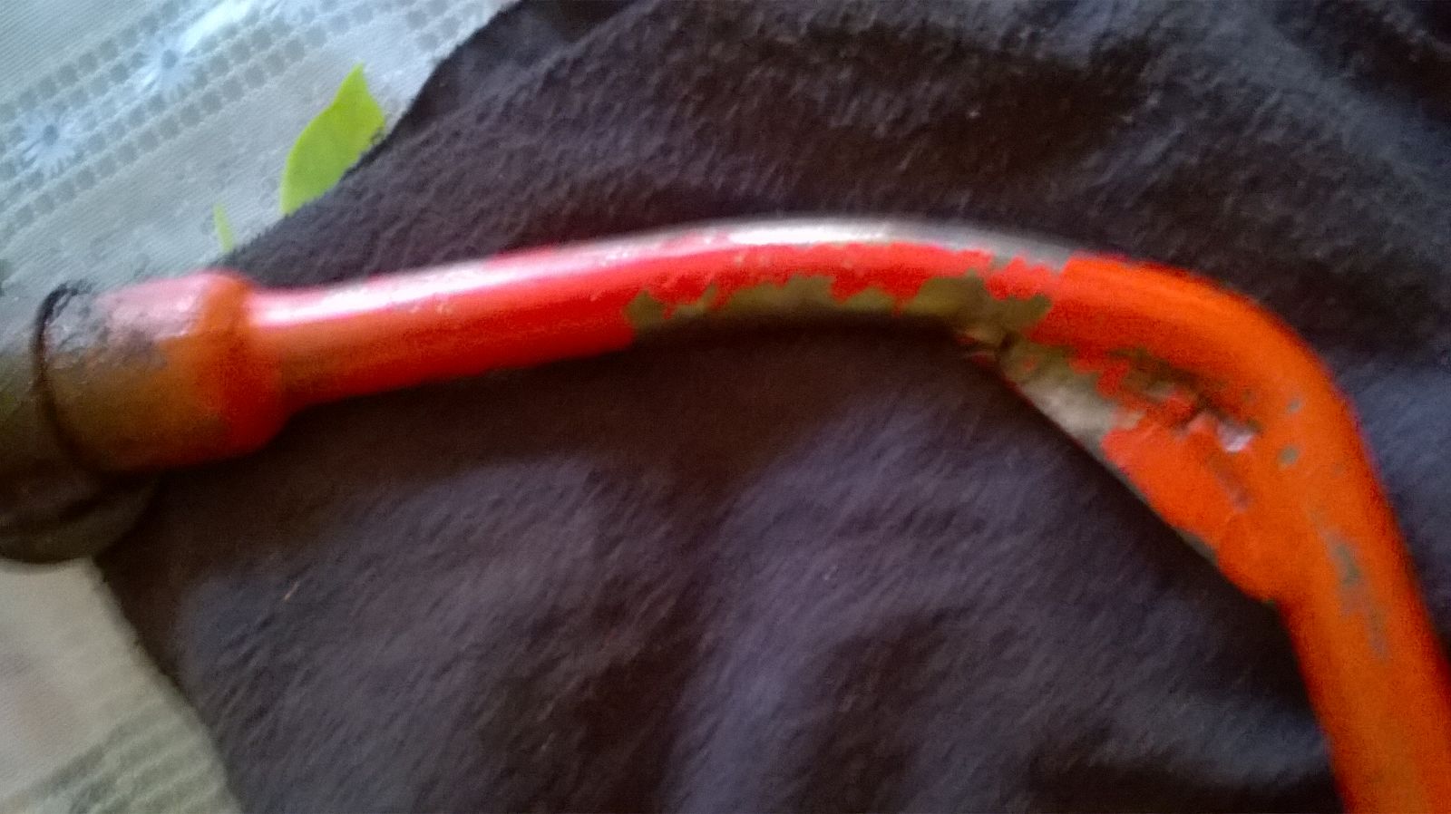

The Hilux ended up bending it's extended steering link climbing out of one of the pools in the mud section. I assume it was a combination of a sub-standard part (the extended link), large tyres and too much power. Whatever it was, the vehicle could still turn right, but just not left.
We spent quite a while attempting to bend it straight again so that he could at least get home. The steering link had bent upwards, and we spent quite a bit of time attempting to put enough pressure to bend it straight using a bottle jack between the chassis member and the link. Similarly, we tried using a shifting spanners to apply leverage to get it straight. But we simply did not have anything big enough to provide enough leverage, and the bottle jack was just too big to fit properly. I remembered reading something about a bush mechanic repair using a winch to straighten something, so as a last resort, we attached a snatch block to the diff, fed the winch cable through this and attached the winch clip to the steering bar. This provided enough pressure to the steering link to bend it back far enough so that the lux driver could get home.
The only photograph I have of the incident, is the bent steering link forwarded to me by the lux driver. The bit at the top-left should be straight. As you can see, the supporting brace just seems to be far too small...

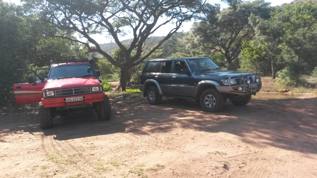

In the meantime, to prove I was there, here's the Patrol (and the Lux) at De Wildt.
