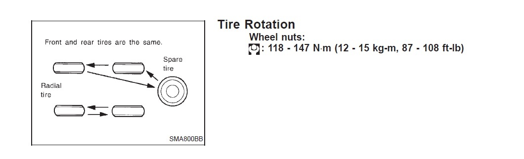

Re: Wheel nut torque
Dis in die Manual!
Wheel nuts.jpg (37.7 KiB) Viewed 5594 times
Post by NMAD »
My owners manual says 133 NM for a 2007 GRX.
